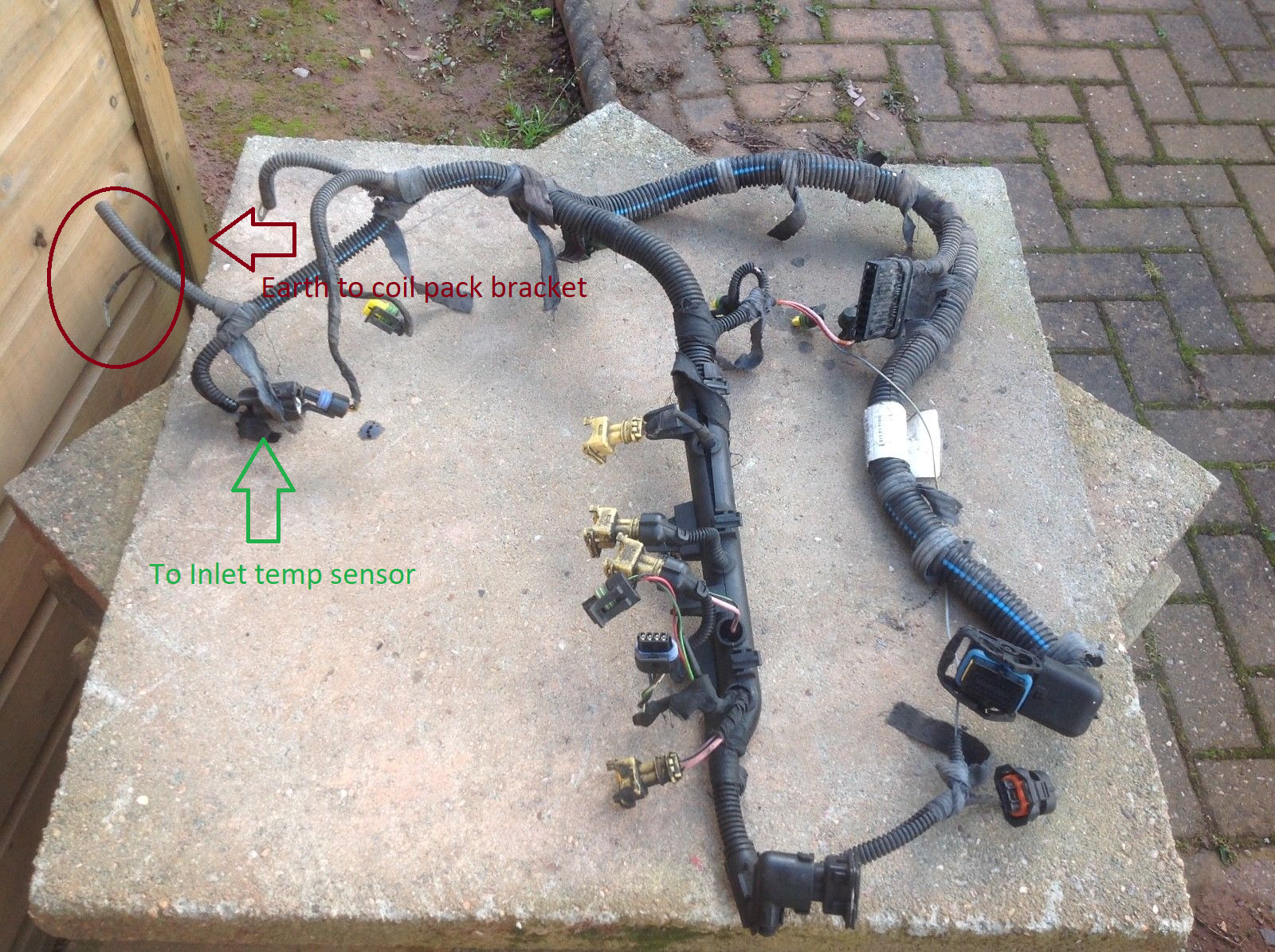

It has one, they all do. it's going to be hanging down the back of the block somewhere.
When that's not connected, it causes all sorts of spark/immobilisation issues.

Thanks for the info, pulled all the wiring back to the nearside, and deffo no earth from coil pack area, even looked inside the plastic tubing in case it had been tucked away but no wire,:confused:
I dont understand the need for it when the main engine earth is on the G/box to body,

right been studying the wiring diagrams, and as suggested theres seems to be an engine earth labelled as C40, so will have another look in morning, I, m grasping at straws here but as it got stinking hot wonder if its melted,:eek: as I did not remove 1 when I took head off and stripped down,:confused: and it was running very rough when it got home,(I wasn't driving):)
It's honestly a tiny wire, thin gauge with a small looped terminal that is meant to be bolted to the bracket the coil packs sit in. Until that's found then we're banging our heads off a brick wall because it's likely either the source or a huge contributory factor to your issue.

thanks for the help, have readjusted your pic to what I have, and there is is no earth wire on the MPI At least not this one
yet my neighbours panda has one coming out of the plastic injector sleeve, above no2 cyl,
