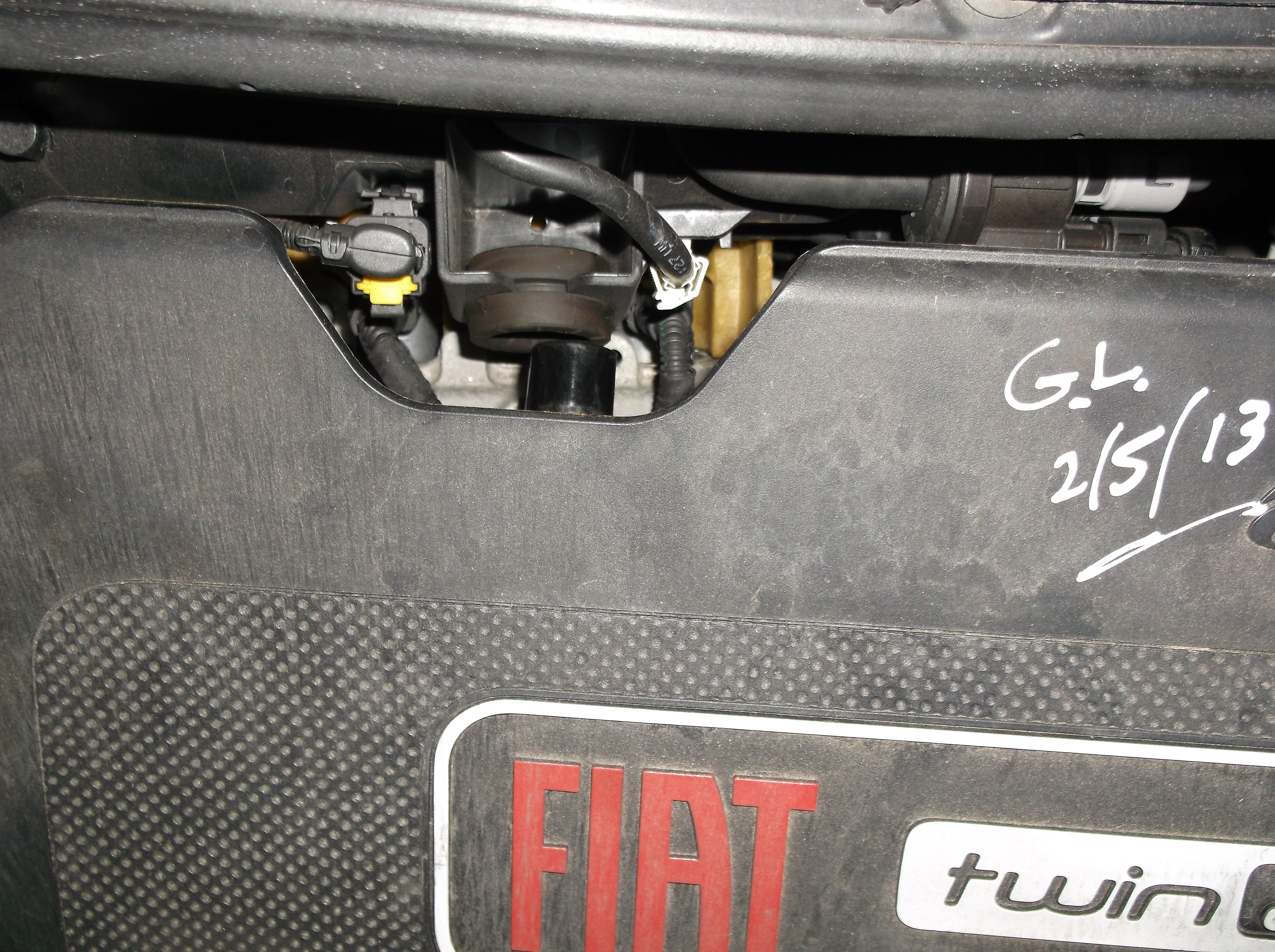

I don't remember any play on mine, from when I removed it to get at the oil filter, but here's a photo showing the two parts before they were fitted back together.
Is this how yours looks ?
Thanks both, yes from memory that's what mine looked like but it as if the stub is not a very snug fit in the grommet and you can rock it up and down slightly at the rear, not a big deal I'm sure but I was curious were they all like this or was I missing an extra rubber bit but evidently not
