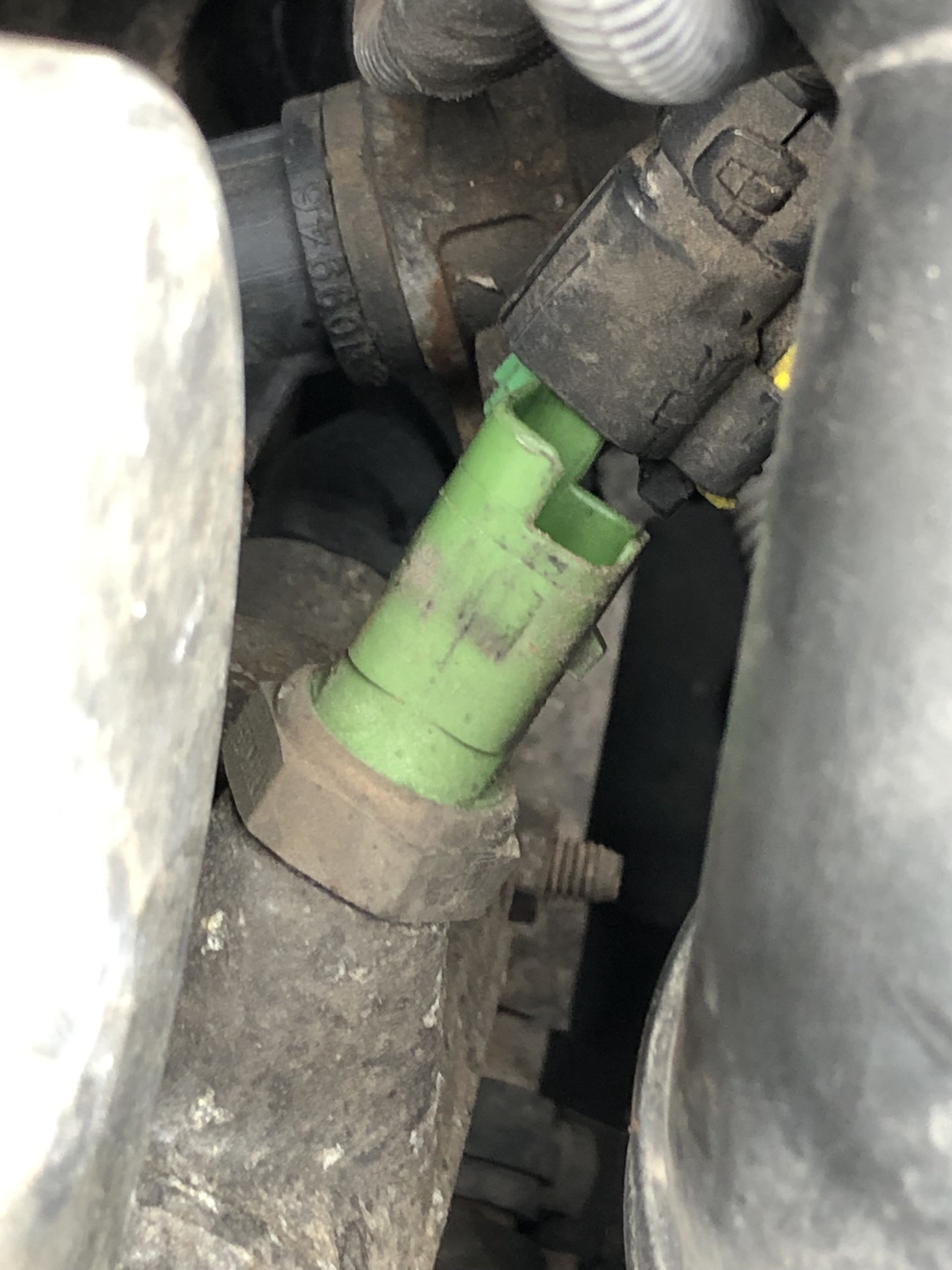

Hi all, right i may have made a breakthrough with the poor cold starting issue on my 2007 1.9 Multjet. After many an hour under the bonnet swapping glow plugs, injectors, fuel filter etc i was beginning to run out of options. Anyway whilst trawling Ebay I noticed another Sedici for sale and it said in the description it had a switch fitted on the coolant sensor to aid starting, strange I thought. Then whilst trawling the forums another Fiat owner with an older 1.9 engine said that there’s would only start from cold with the coolant sensor disconnected so I thought I’d give it a try. I disconnected the sensor and turned on the ignition. Now the glow plug light stayed on for over 5 seconds which it’s never done and it literally started straight away and it’s not been started for a week. Only problem is it makes the cooling fan run constantly and has also put the engine light on. So I’ve ordered a new sensor and will update when fitted. Fingers crossed! 😬
