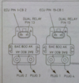

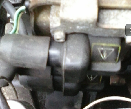

I've just finished fitting the head to a '94 Cinq and can't get it to start. I'm just wondering about the plug lead order from the coil pack. Is it 4-1-3-2 as you look down from the top to bottom?
And anybody know which colour-connector goes to the top?
The workshop manual has the coil packs side by side, but they're one above the other...
I've attached a couple of images

Don't worry
One coil does 1 and 4
The other coil does 2 and 3
If it does not run swap the low voltage connectors around
It won't make a difference if you mix up the 1and 4 HT leads as long as they are on 1 and 4 plugs because you get a spark at both at same time.
Same with 2 and 3 HT leads doesn't matter so long as they on 2 and 3 plugs

From your first post I feel like you are looking at the 1108cc info in the manual and have a 899cc engine - the coils on an 899 are one above each other unlike the 1108 engine.. From memory, and its been a long time since i touched a 899 but, the lower coil is 1&4 and the upper 2&3.
