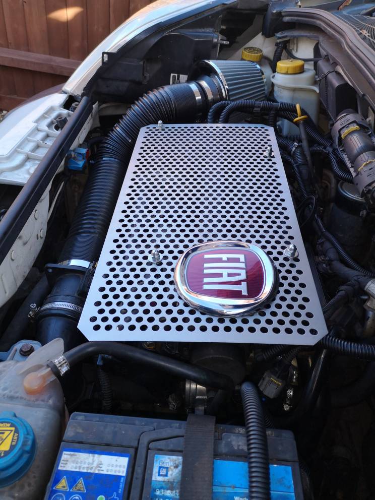

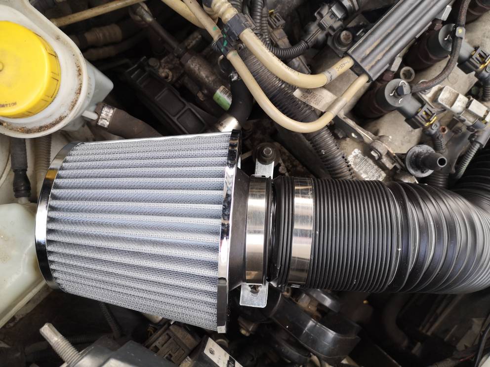

Mine does it at 6th gear(dualogic) @1500 rpm. Only did it once in 5th gear and it seems shake more on cold weather. I've tried things like cleaning the MAF but no real improvements.
I'm planning to give that cone filter a shot... Happy to do anything that fixes or at least improves this.
This issue seems to be on all engine variations [emoji24]
