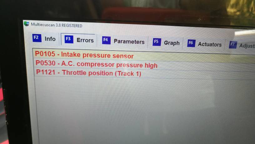

I diagnosed it with MES, I get 3 codes as you see in the photo 1
P0105 Intake pressure sensor
P0530 A.C compressor pressure high
P1121 Throttle position (Track 1)
I can't clear these 3 DTCs, the are always red and can't be removed.

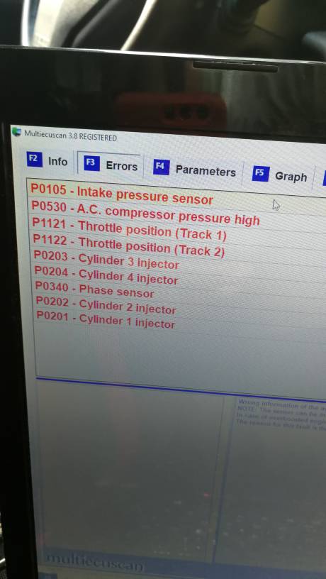

After an attempt to start the car, the starter and engine rotate but doesn't start. Then I get new codes
Cylinder 1,2,3,4 injectors, Phase sensor, etc. as the photo. these codes can be cleared directly after the attempt, but that 3 codes are always on as I said.

I would start with:
• is the timing correct
• fuel in cylinder
• spark on spark plug when removed and grounded.
On the following errors you have only 2 might be the culprit so I suggest looking at youtube videos how to test the pressure sensor and throttle position before testing to have an idea.
• remove if easy accessible, measure on signal wire while plugged in, should read somewhere between 1 - 2 volts, if you suck the volts should drop and blow volts should go higher than 2, the range is 0-5 v normally for sensors.
If it reacts then it should be fine.
• unless the ac pump is seized and by some miracle the belt is preventing the crank to turn it can't be the ac.
• same test as with pressure sensor, 0 - 5 volt test on throttle disc position.
Also think this might not be the fault. Since there are 2.
Maybe verify that both pressure and position sensors has 5v on supply and 0v on common.
Hope this helps.

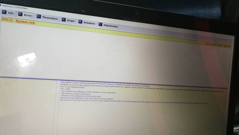

But now after engine has started, the rpm is not ok and I got the code P0172 System rich.
Does anyone know what it is.

It could be the idle control valve/throttle position sensor or more likely it's a lamda fault.
Take it for a drive until it's warmed up. Then from a standing start (junction or traffic lights) accelerate very slowly in the same gear (2nd is good) without changing up.
Listen to what the engine is doing as the revs pass from 1500rpm to 3000rpm. If you can feel a hesitation or glitch around 1800rpm then that's a lambda problem.
What happens is the lambda heater turns off when the revs pass 1800~2000 (since the extra exhaust gas will keep the lambda hot). Without the heater, the lambda may not be able to give the correct reading (if it's knackered) and that upsets the fueling.
Without a decent lambda signal, the car will default to slightly rich.
If the lambda checks out then the other sources of rich running are the MAP/MAF (do you still have the "P0105 Intake pressure sensor" error?) or worn injectors.
