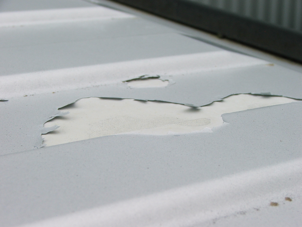

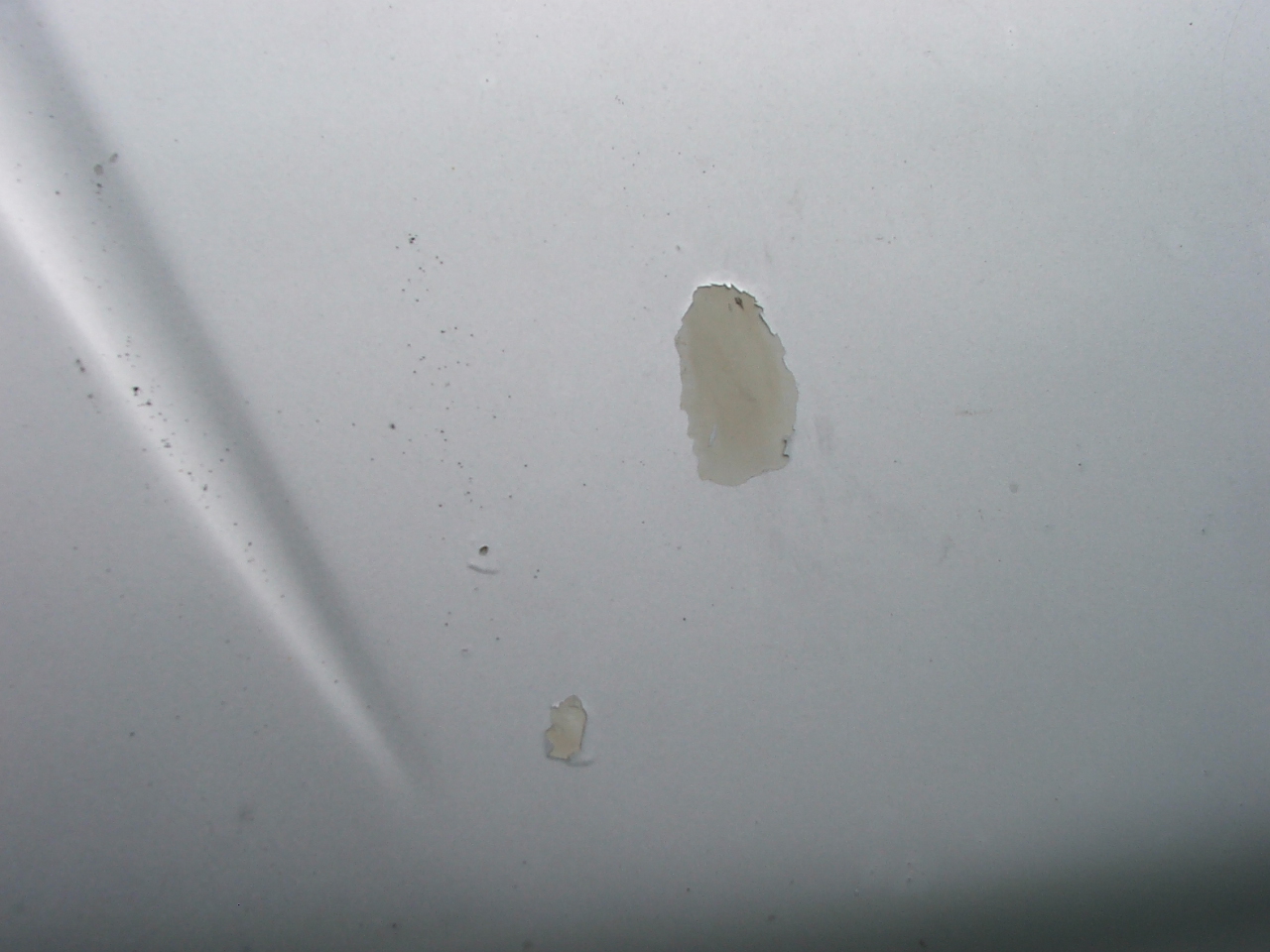

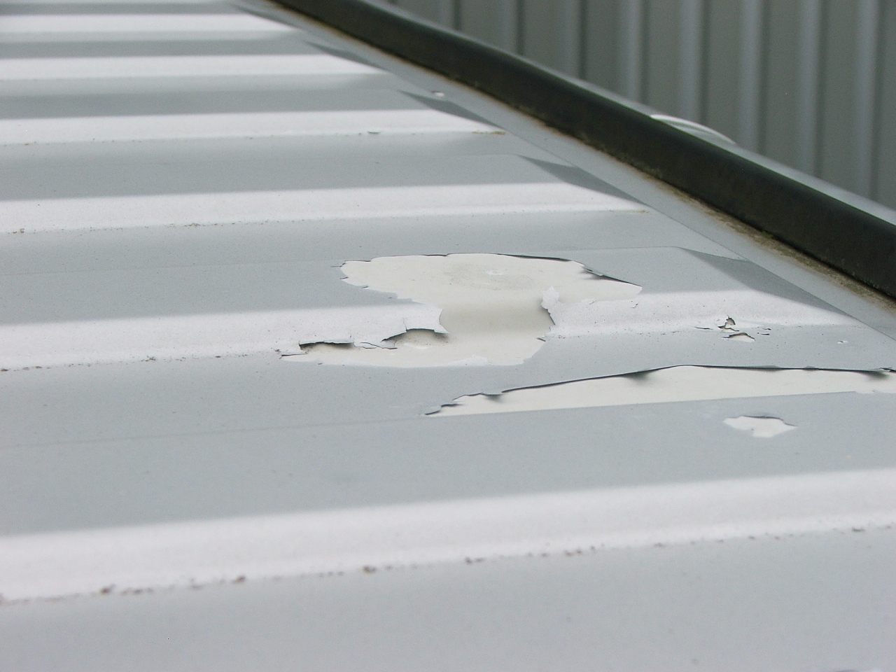

Hi I have owned since 2007, A 2006 - 34,000 F i a t Ducatto JTD11 van that has problem's with Flaking paint Like a Rash all over the Roof , the Bonnet and now coming on the side panels. I got nowhere by chasing F i a t as they do not want to Know!! However the law of the land in The UK is that If you purchased your Vehicle by using a Finance Company ie Hire Purchase then you have rights as the Finance company own the vehicle until your final payment this right last for 6 years from the date that you purchased your vehicle. I tried to get the finance company to address the problems however they tried to duck and dive and get out of there responsibility so I withheld my final 5 payments having paid just over £9,000 of a £10,000 agreement leaving approx £1,100. the finance company made a small claim trough the courts. So I counter claimed for the total cost of a complete Respray . I have a motor engineers report stating that the, problem was in the manufacturing process as the paint had not been bonded properly basically F i a t are at fault but don't want to address the problem by taking the finance company to task you have a much better chance of winning and then the Finance company will need to take it up with F i a t .. I have had a 10 minute hearing so far at which the finance company tried to get it thrown out the judge set it aside for a two hour hearing as he felt that the Finance company had a case to answer to. I have since seen a solicitor as the finance company have applied to bring the case forward to get a summary Judgement. I would be very interested in anyone else that has a problem with Flaking paint on their Vehicle as it IS a manufacturing problem and if we can swap info etc it may just make F i a t sit up and take account for there faulty manufacturing . Messsage me.

Mines just the same.. except now theres hardly any paint left on the bonnet (well i have done 282k on the motorway :D ) and the roof is going the same way, touch wood the rest of the van seems ok.
One good thing is though i suppose, theres no paint hardly left but theres no rust, so at least the body material is decent enough, unlike alot of other vans i see :)

As above to a degree. It is due to the earlier water based paint technology. They were water based base coats to colour - yet laquer had to be solvent. This meant their was water trapped between the laquer and body - which steamed itself off in hot weather!
Most manufacturers now use a 'breathable' laquer which combats this.
