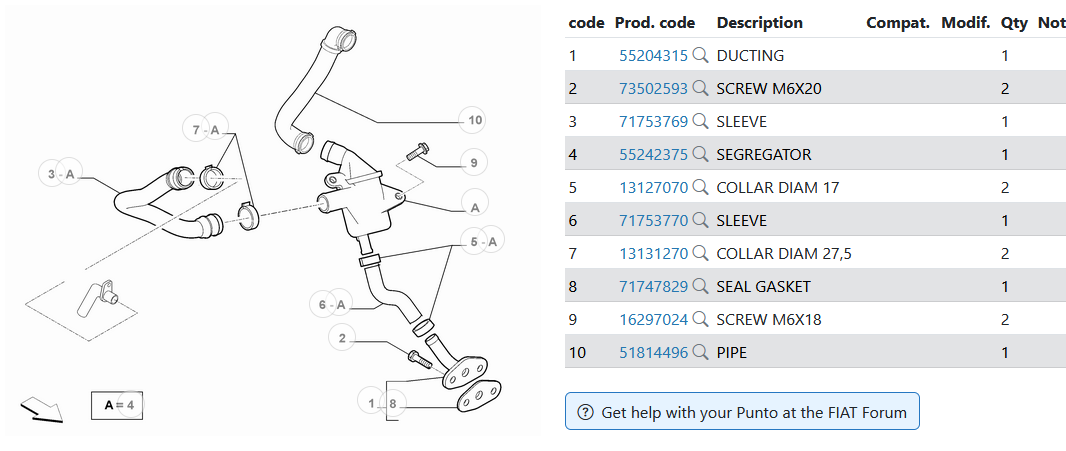

I also cannot locate it on my Punto Evo Mjet 75 CV from 2011. I was searching and searching but no luck
However, it should be there according to https://eper.fiatforum.com/en/Drawings/Detail/F/F/FPUN/3J/103/1/30/2/Group?MVS=19925D301000
Fiat PN - 55185372
My engine code - 199A9000 (1.3 Mjet 75CV)

Hi there,
This ”canister” is located between the engine and cabin’s firewall.
In some cars it can be seen from top, but most likely it’s easier to locate if you are under the car.

I manage to replace it but I do not see any improvement. The "canister" is not a valve as I thought. It has just an oil separator nothing more than that. It does not have valve that can opens or closes.
