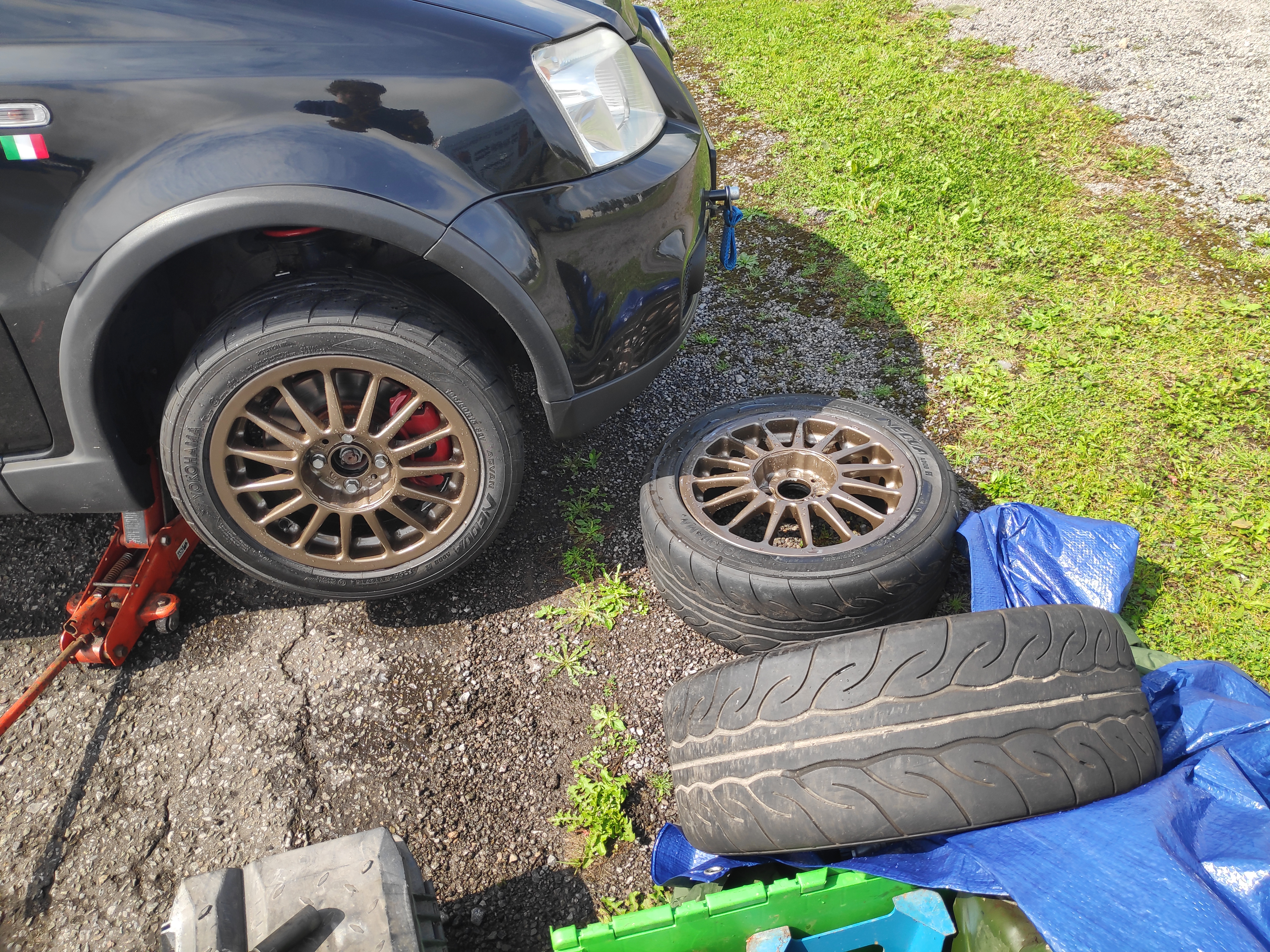

My 15" track wheels (195/50/15) have an offset of 40 and I run a 5mm spacer to make sure they clear (The wheels clear the body fine, but you have to be careful where you put the balancing weights wrt to the caliper).

Sorry OP I just wanted to say im loving the gold wheels against the black paintwork. A bit John Player Special if you will.
