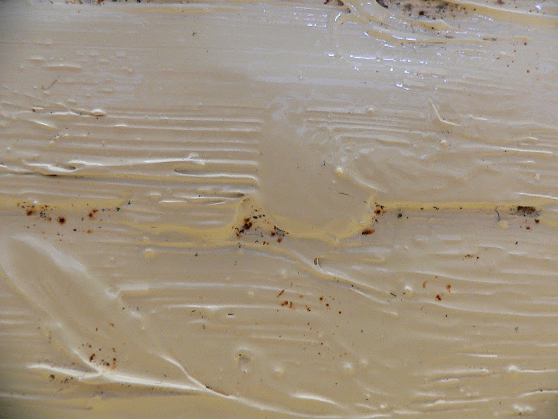

Anyway, I gave the car a bit of a checking over and it's not good.

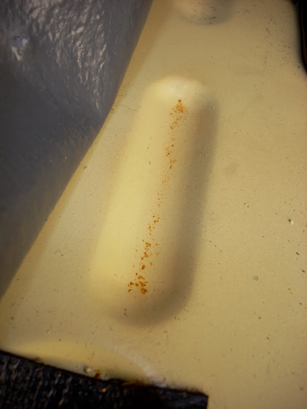

After the Winter there's quite a bit of visible rust on the boot floor.
Here's some rust coming through the caulking along the welds.

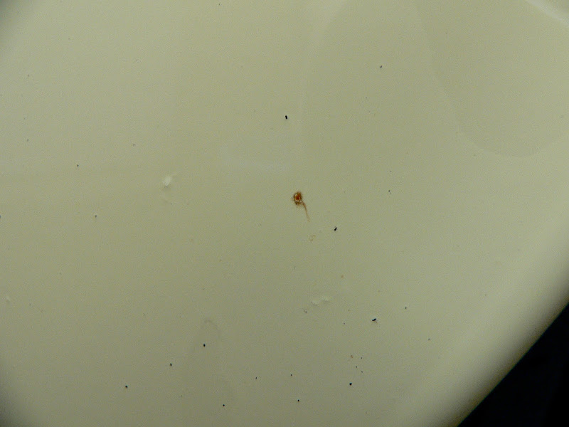

The new tailgate has pin heads of rust all over it.

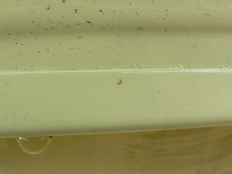

The C pillar where they've repainted it is also breaking out in pinheads of rust.
So. I was expecting the repairs to be a likely source of problems in later years, hence trying to get documentation, but no way did I expect every single piece of metal they touched would be showing signs of rust six months later :mad:

It seems I was mistaken about the rust on the tailgate :eek:
Turns out it's some brown stuff that just looks like rust. Here's a convincing lump of it on the plastic bumper...
Boot floor has genuine rust though.

OK. Had it looked at today. Not as bad as all that. Turns out to be various bits of metal filings and guff that weren't cleaned up and got stuck in the paint and started to rust, so it's not going from the inside out.
Anyway they're going to fix it.
