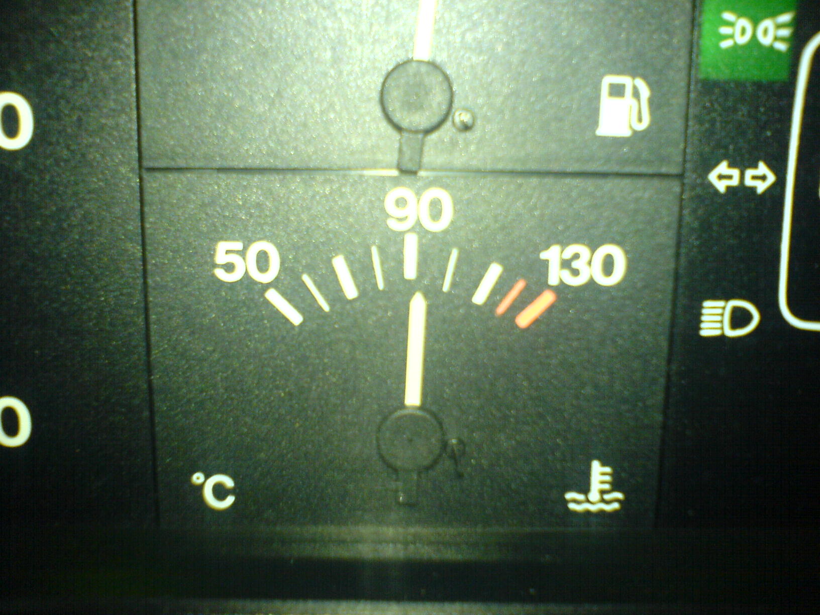

No John the heaters fine and there's no coolant loss
it's just since I changed the coolant the car runs much hotter all the time (between 95 and 100 and I had the same problem with the selecta too but it sorted it's self after a few weeks)
This ain't good on a car that I intend to take to the Sararha!!
The fan still works ok and theres no mayo or anything to suggest a head gasket so I'm assuming that there must be an air lock stopping the water getting out of the bock.
Going to drain it again tomorrow and put the hose on it too incase there's something blocked since the last change/hose out.

Well, after much flaffin about and some cursing and Alan shouting at me for starting this at 8.30 at night and realizing I'd no anti freeze etc I got the required result!!!! :D
Right where it should be.
Many thanks for everyone what helped (y)
