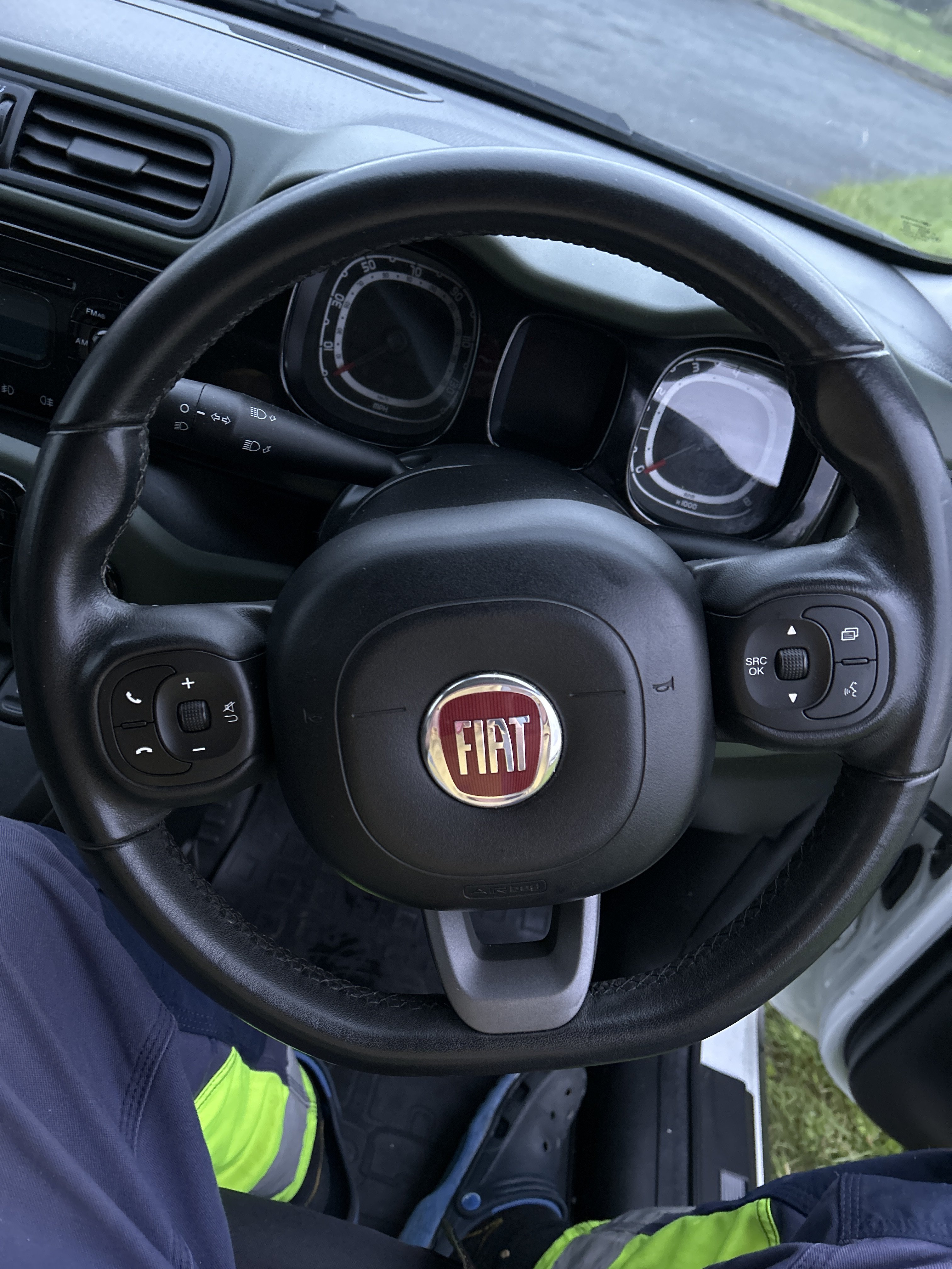

I'm thinking about upgrading my steering wheel to a 2017 steering wheel.
I don't like the edge in it, an unnatural feel with edge in the middle.
How my present steering wheel look like.

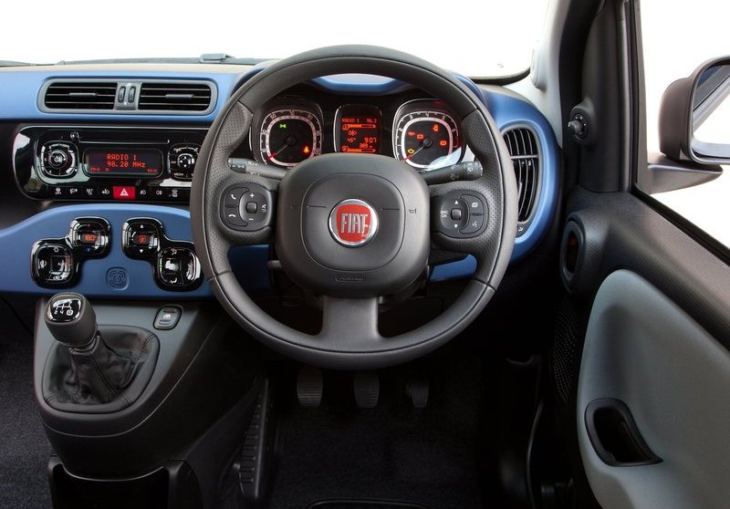

Buttons and airbag look exactly the same to me, it must be plug&play IMHO.

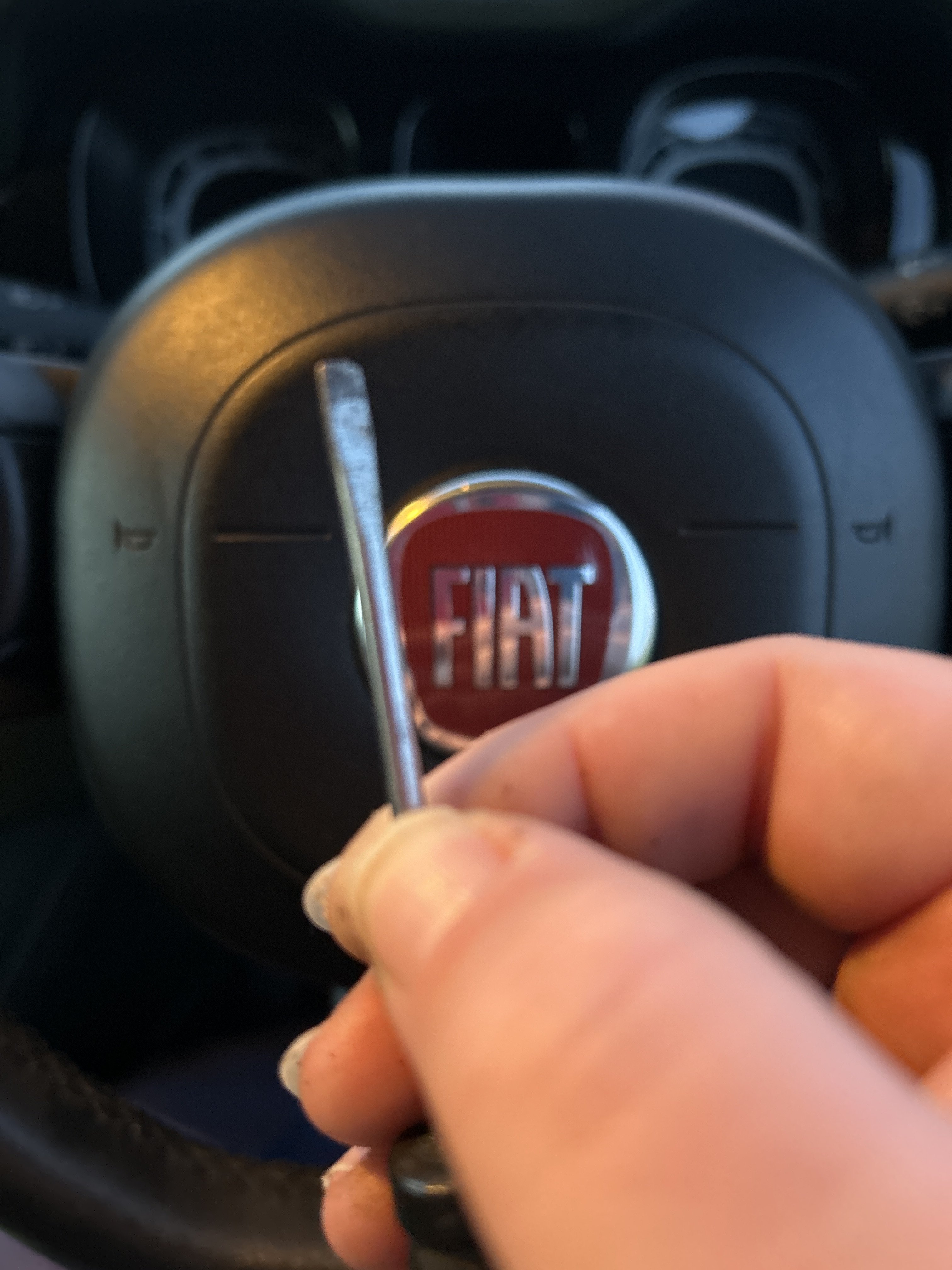

Any tips for getting the air bag out? I can’t get mine popped off. What tool did you use for the holes?
I used a small flat headed screwdriver the knack is when you get one side popped don’t lift it up to high just enough then go and pop the other side it has to come off near enough level I watch a guy on YouTube
How far in did you have to push the screwdriver? I don’t seem to be able to feel anything to release when I poke in the hole with a screw driver but I’m wondering if it’s too short?

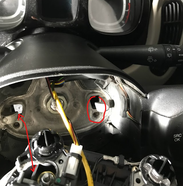

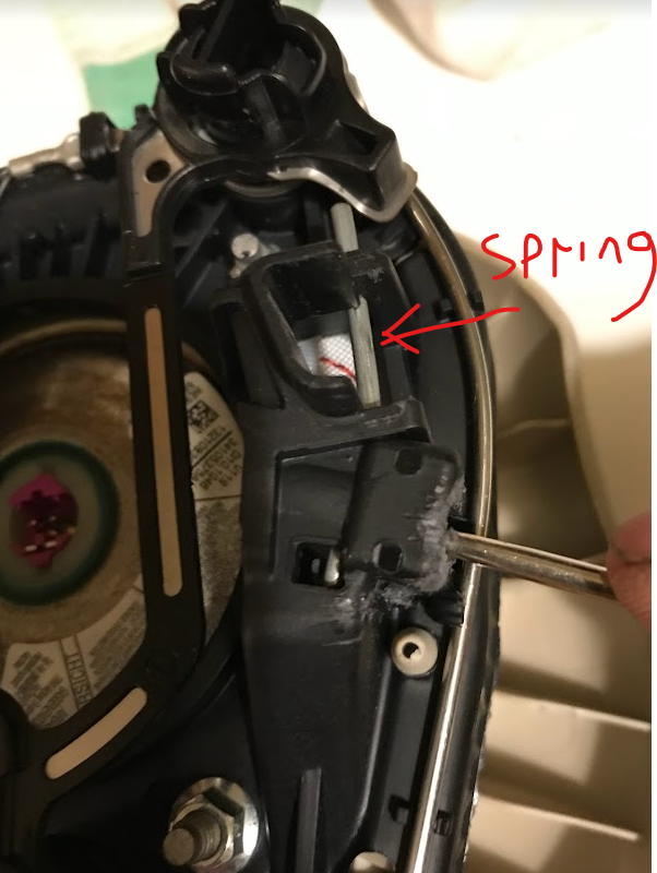

You need a suitably sized round bar or say a 4 or 5mm hex key. Here's some photos I took (with airbag out) to try and illustrate where and what you have to press on and the clips that you are trying to free it from. I suspect in an ideal world you press both in simultaneously while someone gently pulls the airbag away from the wheel. If you do one at a time you have to keep some upward force (outwards from the steering column) while you tackle the second clip or it just pops back in. It is doable!!
In an ideal world you'd use something with a slight dip/vee on the end, the better to locate on the spring, a bit like an old-fashioned fishermens' disgorger. I note how 'mashed' the surround is on the images above!
Yes, well observed, not my mashing! Someone had been there before me :ROFLMAO:
Good suggestion re tooling; also if you get close to matching the hole diameter it has no where to go.
The spring is tough as old boots, no chance of breaking it. The best tool is either something with a forked end which allows it to 'capture' the spring's round section or as I used, a pin punch of about 5-6mm diameter with a flat end. You need to persevere, getting the exact right angle is difficult and needs practice. I nearly gave up but finally managed it in the end.
It’s one of the most hateful jobs to do very frustrating it must have took me an hour the first time the second time no problem
