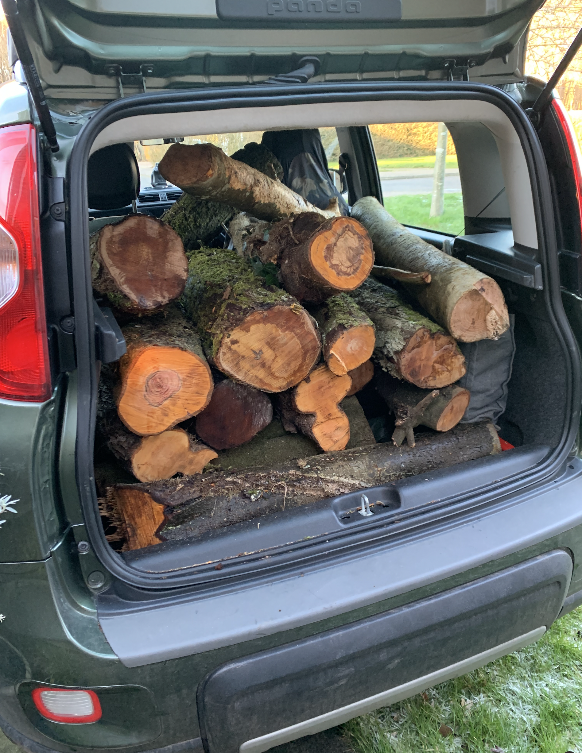

Actually, you have added an important point there... the non-Cross 4x4s are a lot cheaper and just as capable off-road (uphill at least!). When new the Cross was £1500 more than the 'regular' 4x4. That extra paid for auto-climate control (I can manage to turn the dials myself), a split rear seat (not a problem - I fill the whole back of the car with logs anyway), hill descent control (less of a need with the diesel's good engine braking) and two extra airbags (in the sides of the seats). I have waterproof covers on my front seats which you shouldn't use where side airbags are fitted). So yes, look at the regular 4x4s too.
