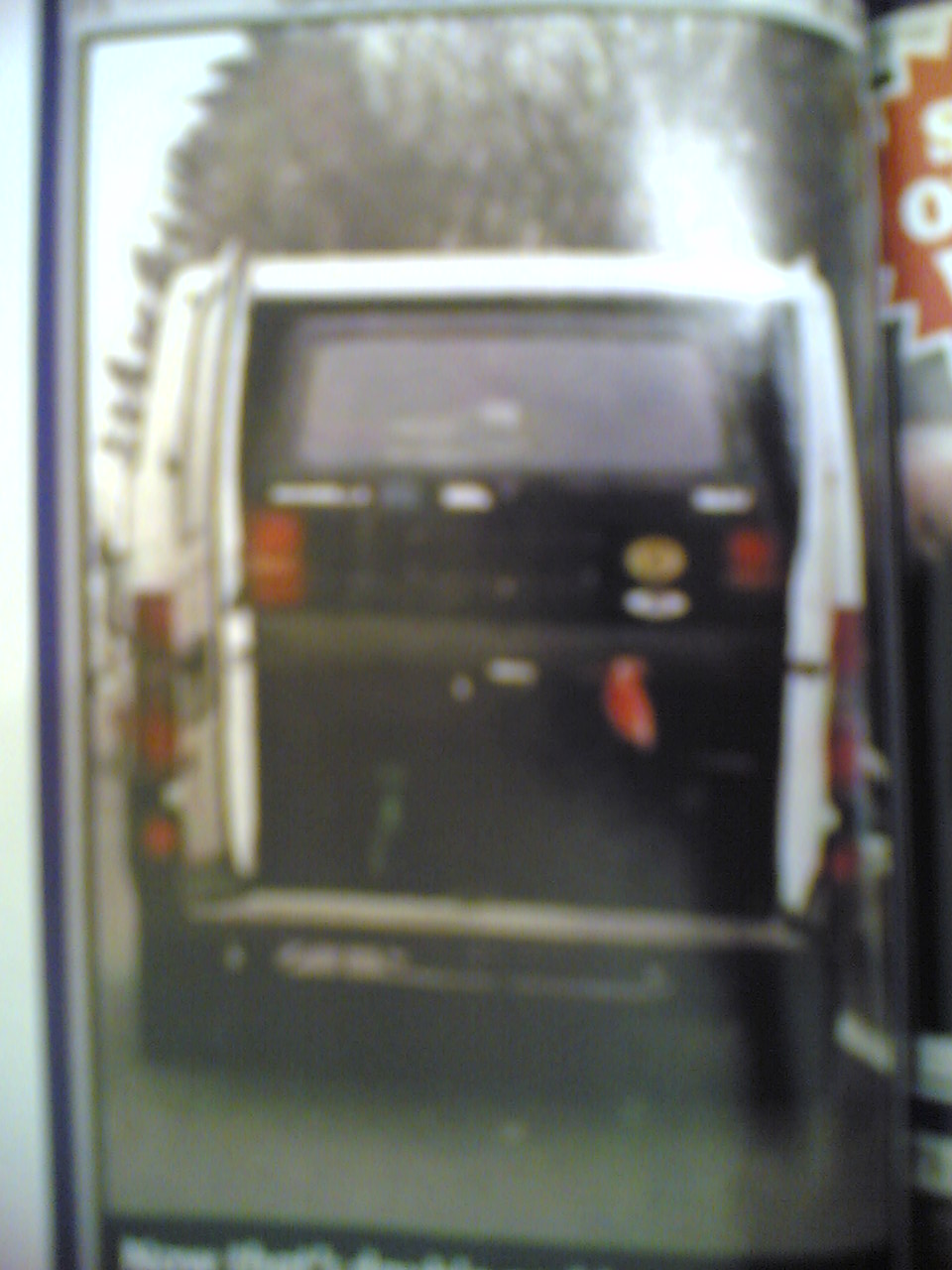

Thankfully we'll be taking 'Thunderbird2' with us on Saturday so all will be OK!
(The 4x4 Kangoo is big,carries lots of useful stuff in an emergency, practial, goes anywhere, and has a big hatch on the back and on the roof!)
Jim
Or we'll put in in the back of Thunderbird2.....
