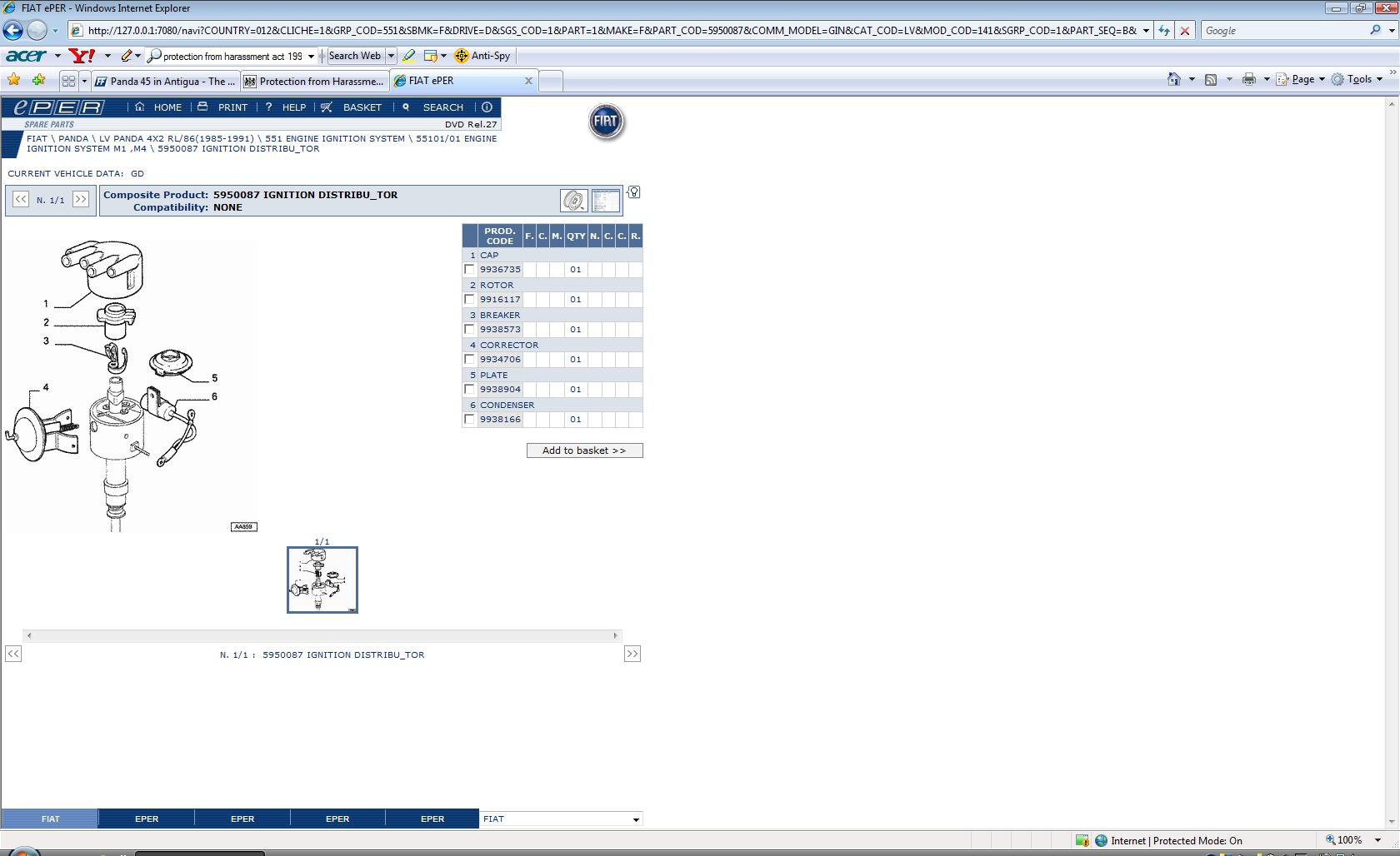

last --- there seems to be one of those vacuum advanced distributers...except know vacuum is plugged into my distributer...anyone know the vacuum diagram for this?
