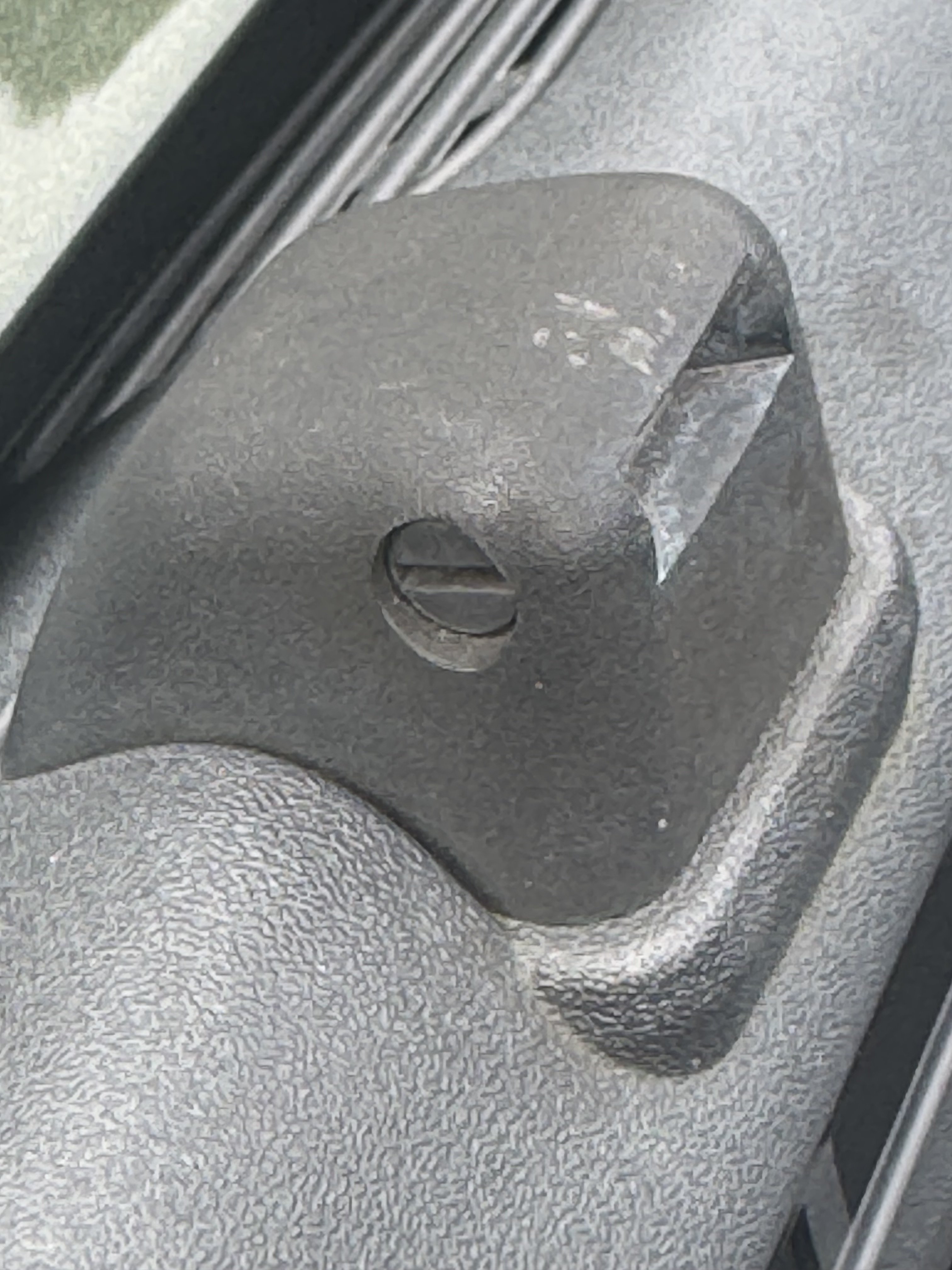

You need this inexpensive tool ( Aliexpress).
No, you do not. This will wreck your washer jets. The front jet is adjusted by using a small screwdriver in the screw slot on the side of the jet. The rear jet is not adjustable - attempting to will break it.
