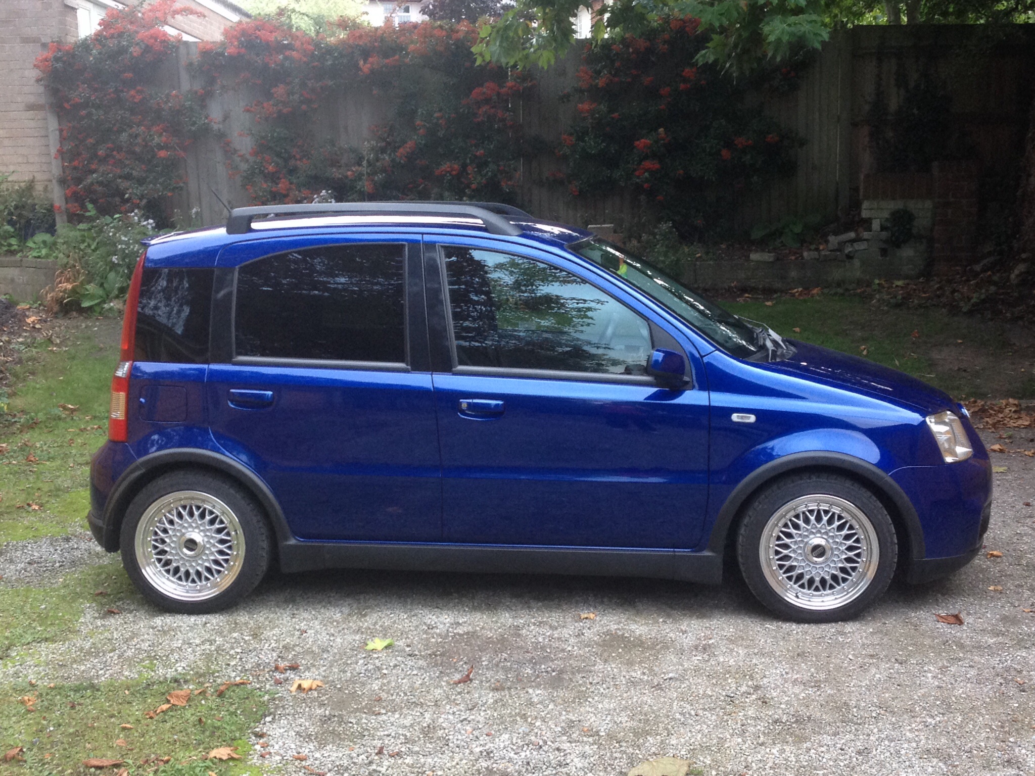

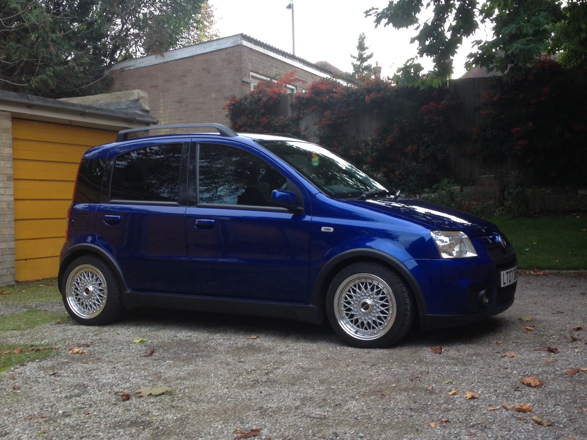

Really happy with the way the car is coming on! The rear end is looking nice and fat, will be looking at getting a silver rear fog light bulb to balance up the lights and looking at spacers the same as Demi has to fill the arches a bit more. All 4 tyres will be getting replaced also for Toyo T1R's as got some cheap front tyres put at the mo and had enough of them!! Lesson learnt!

I do like the wheels. I have thought long and hard about changing mine but the standard ones just suit the car so well, especially when it's got some lows.
With koni sport/H&R 25mm springs and 16" wheels mine only rubbed the edge of the 100hp body trim and only because if wheel spacers. Rubbed about 2-3 mm off the inside edges and stopped. So 20-30mm springs can be ran on 16" wheels with out spacers easy . Will rub the inside of the wheel arch trim on the front when pushed hard thou. But that to be expected. I think think that black DNA test panda is on 16" OZ's

Hello mate sorry for the delay reply, the springs I got are -30mm and they are spax specific for the 100hp, a lot of the lowering springs out there are for the standard panda so as the 100hp is already lowered from the factory there isn't much of a gain, the sports I got from lark speed but demon TWEEKS is just as good, you just need to adjust them to 0.5 from sort and they will be perfect!!
Cheers for the kind words also! (y)
The H&R are HP specific, it says so in the guff that is with them.
I will get some fresh pics this weekend of mine washed and with added lows
ok sweet. i just cant find the 30mm spax springs. where did you get them? can only find the 25mm. and do you think the standard koni shocks (not the sport ones) will do a good job still? i can get some for pretty cheap thats all. :)
Went back and re read my thread the springs were -25mm. When you say standard koni do you meant the STR.T? I was looking at them first, they will be fine there was a lot of good reviews from panda owners on them when I was looking.
Yeah ok mate yeah the orange konis instead of the yellow ones, can get the standard orange ones £110 for rear pair brand new!
Our panda sits so well, what size spacers you got? And did you have to get longer threaded wheel nuts with them?
Cheers man I was surprised but just how well it looked when I done the wheels, I needed to fit 10mm spacers so the front wheel would clear the caliper, the company I bought the wheels from gave me the spaces, longer wheel bolts and locking bolts for free, the locking bolts I had to trim about 3mm off as they were slightly to long and catching on the rear.
