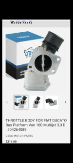

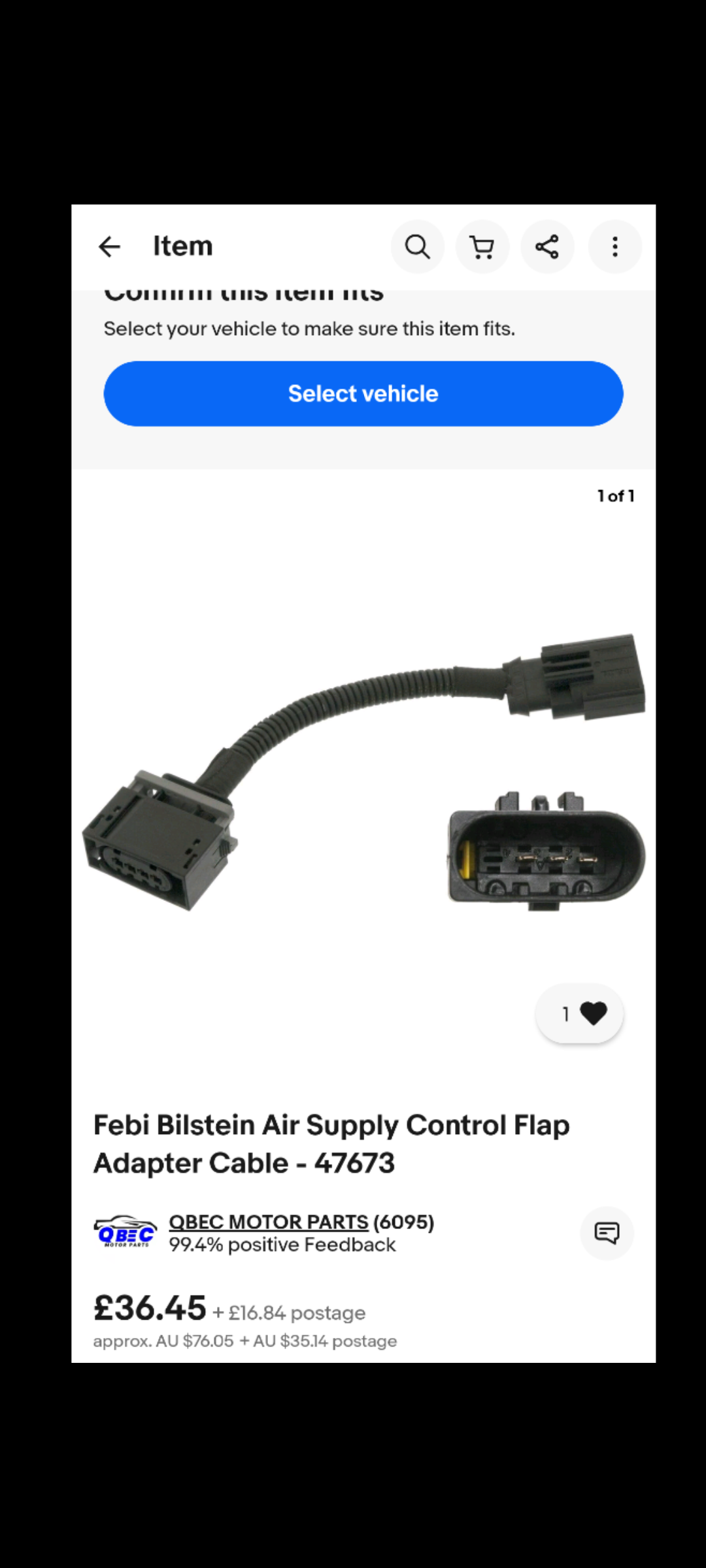

@666tomanderson
I purchased from Qbec Motor Parts UK
Throttle body 504264089
Febi Bilstein Air Supply Flap adapter cable 47673
On their website there is the throttle body but the adapter cable only shows up on their UK eBay store.
I have a new parts here as I always carry spares for my use & checking the prices now mine went up in value more than a gold bar.
