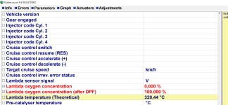

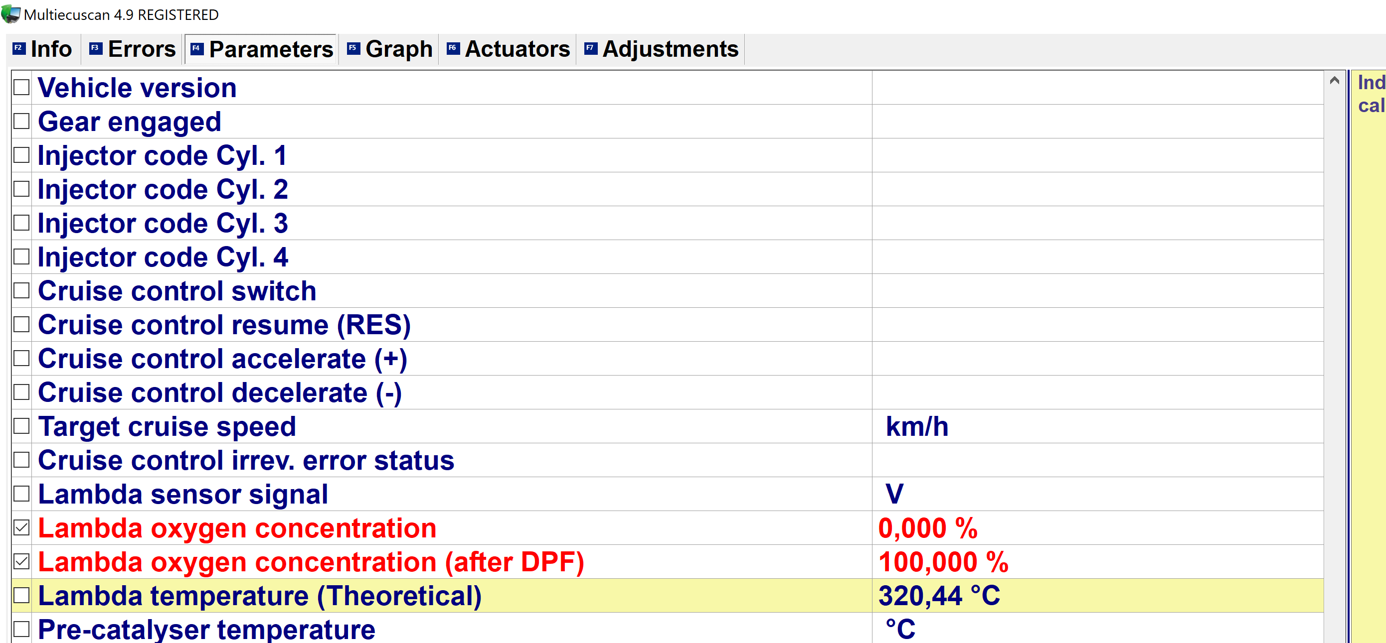

After the driving yesterday I didnt see any soot in the exhaust. So today I drove it via the local inspections office and managed to get a free soot check on the vehicle - plugging it in to the same machine that failed the vehicle before the remap of injectors. This time it passed the standard "official" test they are doing (connect plug to exhaust then one quick push full throttle). I had the multiecuscan connected and noticed that the second Lambda wasnt showing real values but instead only displayed "100%" - instead of following the first lambda.
At this time the inspection guy tried a new exhaust tester they are prototyping which measures particles on idle engine. Since the second lambda still was showing 100% test result was "4 million particles" - approved measures is max 1 million with this prototype test tool. We waited a minute - the secondary lambda suddenly started showing "normal values" and we did this test again - and test results was just above approved limit if 1.4 million.
Questions:
A - Now when I display multiecuscan on off engine I can see the two lambda sensors displaying different values. One i 100% and one is 0%. I believe this is a sign that the post dpf-lambda is broken/glitchy?
B - Should I simply give the engine more time to warm up secondary lambda sensor or change it right away?
C - Noticed software is 0028 - is it worth changing to 0032 even if the lambda thing above might solve sooting?

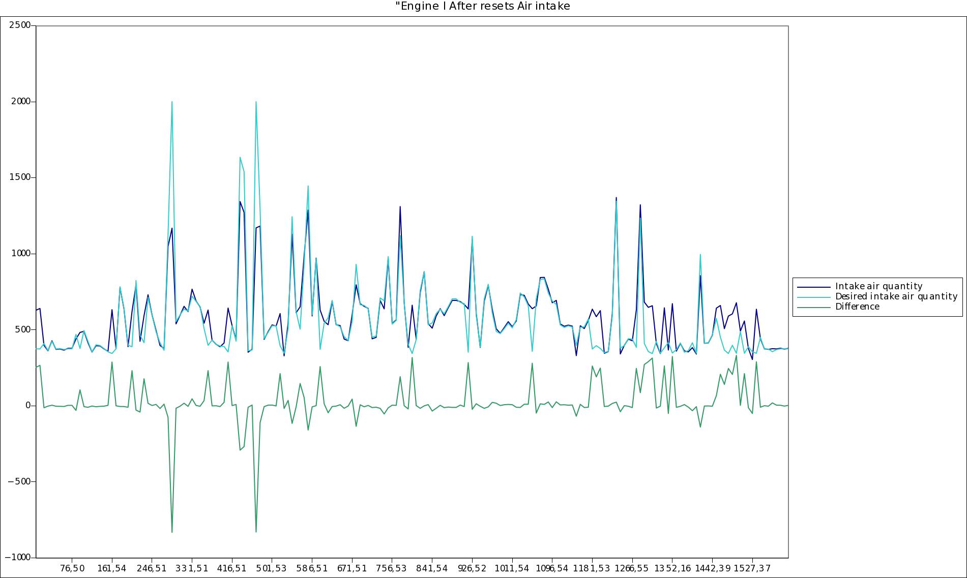

D - The potential differences on desired air intake graphs in the previous message - what can I do/check more on that one?

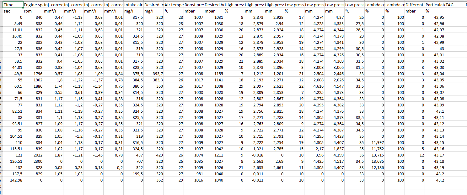

  • FESExp_2208031201_Fiat Ducato (type 290) 2_3 Multijet_File2.csv

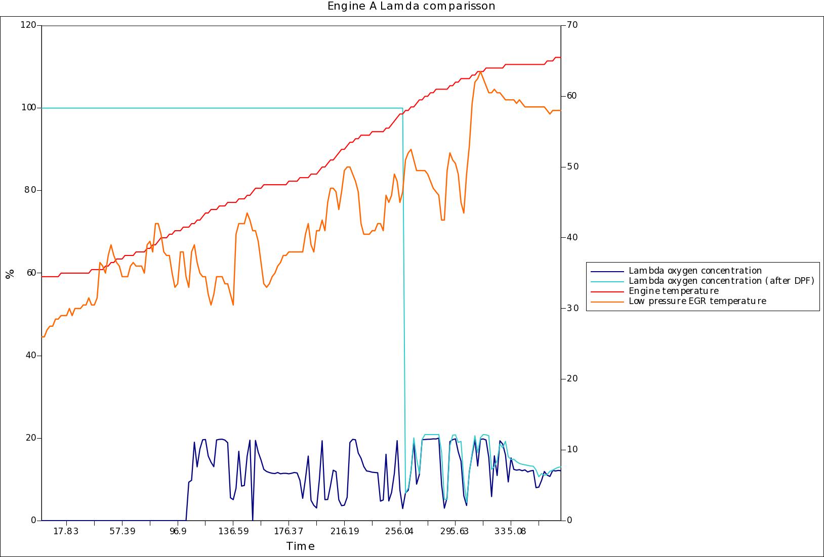

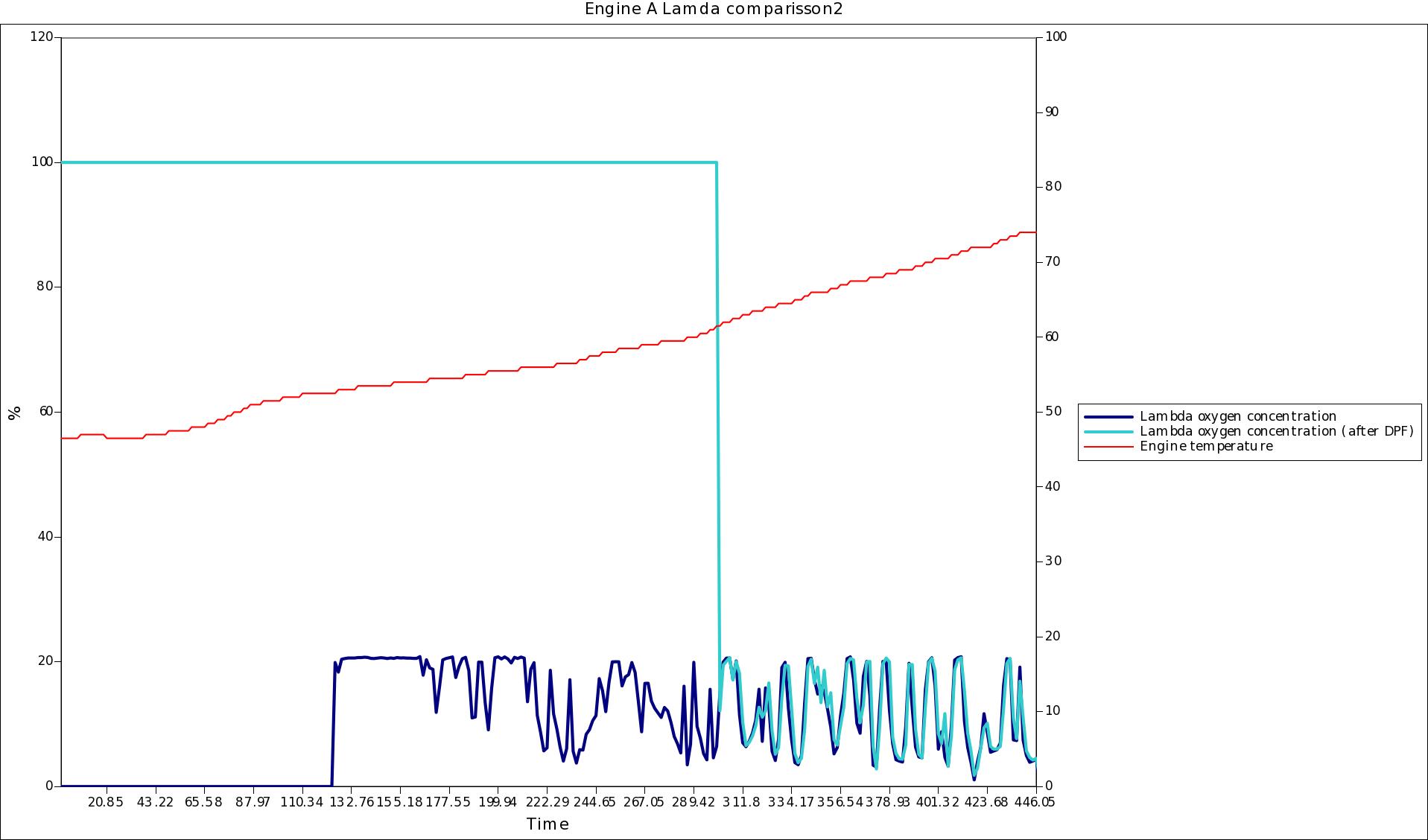

look at my graph earlier in thread post#8 the front sensor starts at 0% for about 2 minutes the rear 100% (full of air when cold 21% of air is O2) for 5 minutes. If getting these values with warm engine then sensors suspect (at least 8mins after startup and running not idle).

In your car - your lower sensor start from 100% and your upper from 0%? or both start from 0%?

Hope this graph is clearer
The blue is front sensor starting at zero.
the turquiose (blue green) rear starts at 100%
unfortunately it doesn't start with a totaly cold engine
Ah so this image is from your engine? I'm thinking if 0% Vs 100% is expected behaviour when these sensors are cold or if they should start from 0% both?

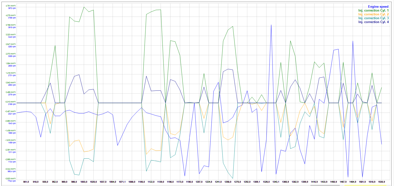

- vehicle got 180tkm on two engines. Massive troubles with injectors and emissions systems.
- recent engine swap to a 70tkm with new injectors.
- throwing error code p2000-97 but clear when finally cleared with alfaodb and not via mes ( think it was related to wifi dongle)
- injectors seems a bit off. Lambda nr 2 is slow on starting but seems normal.
