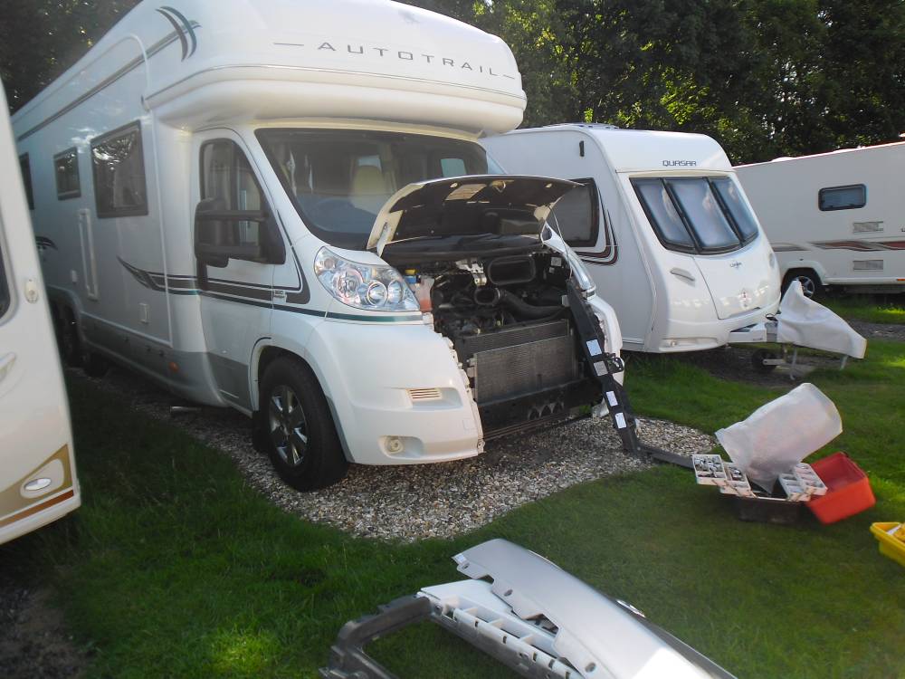

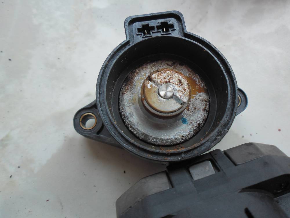

hi. photo of my throttle flap full of gunk & inlet manifold is the same on my x250 -2008-160 done 22000 miles only do you think its the EGR valve I am waiting to see if techno 100 egr valve cheater is a success after his France trip ( lucky man ) I expect my throttle control here on Tuesday the other photo is the only damage I did was the large jubilee clip & plastic fastener under the grill (2) with out taking of the inlet manifold I will try & get as much crap out as I can before fitting new control this a great forum for information & if I have any good info
I pass it on only to pleased to help anybody out . cheers

The EGR blanking was an immediate success, I didn't realise you were waiting for more information.
This picture is after 1500 miles around Scotland some weeks ago after blanking the EGR. Absolutely no sign of any dirt and only replaced this due to the water ingress damage.

I managed to remove the wahler one some months ago without but I doubt you could put it back on without removing the slam panel
The Pierburg is even more difficult and I needed a 13mm socket on a quarter drive extension anything else is too big for one of the bolts at least.
Save yourself the grief and strip the front off it doesn't take so long when you've done it before
Battery drill and torx bit speeds it up
hi just finished fitting the new pierburg control its better than the old one as its a sealed unit yes you have to take the front off & if you do have to fit this one put all 4 bolts in a short way then tighten up the left one nearest the head first its easier that way tried to post photos for you but there is a gremlin somewhere will post more when I test drive it

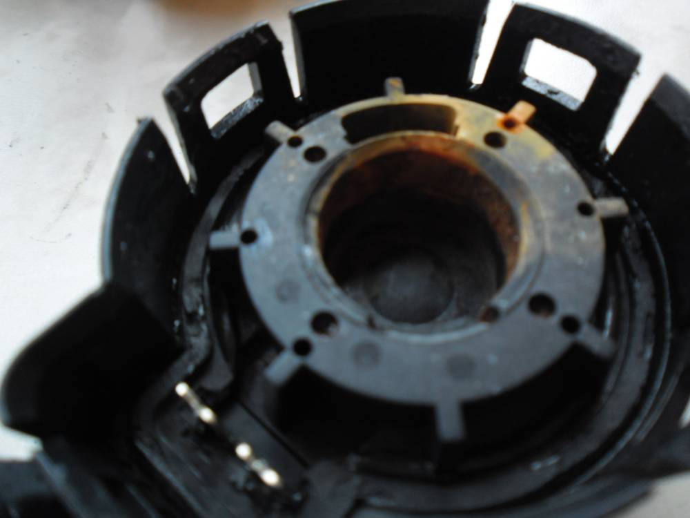

hi got rid of the photo gremlins these parts are for x250 ( 160 ) euro 4 / 2008

Going back to the same vehicle i have been trying to fix, it's still putting the light on, and I've found the control side of the throttle actuator appears to be the fault, rather than the body itself. I have a new diag tool which allows me to see control setting for Mass Air Flow, and the actual reading. What I've found is the throttle body servo isn't moving to allow the Mass air flow to the correct target figure when the fault happens. Even with ECU unplugged for a year (seriously this fault has put the van out of regular use). If I remove the throttle actuator's electrical unit, the actual throttle flap can be closed by hand at idle until it's nearly shut, and then it can be used to adjust the Mass air flow to the correct amount. The electrical part of the actuator doesn't do this, hence P0638 fault after each restart.
I have a spare electrical unit and this operates exactly the same as the other, therefore leading me to believe this fault isn't the actuator in this case, but rather something else - either a sensor or the ECU, or a wire, which is not sending the correct control signal to the throttle actuator to move the flap correctly. Not found out which it is yet, but both MAF or MAP sensors appear to be working correctly using live data.
Has anyone studied the Throttle Actuator flap position during their diagnosis of this fault by any chance? All I can see happening is the throttle actuator will usually snap shut after starting for a brief moment, possibly as a self cleaning operation.
What I can report back on now is that the last (3rd) Throttle Actuator from FIAT, and the one before, were both the old style Wahler ones, and not the new one shown later in this thread. Interestingly the 2nd one (from Euro Car Parts) came with a short cable - but this was like an extension of the original loom connector and nothing more. That's why at the time I assumed the loom was a mod for the new Actuator which was very misleading. Only having seen the new style one I have realised that I've never tried a new style unit in this vehicle. Could it be that the new style unit operates in a different way to the original, or is it simply a new version in terms of being a sealed (waterproof) unit? Any knowledge on this would be good to know, as I have thought whether buying a new style throttle actuator might finally solve this King of problems!
