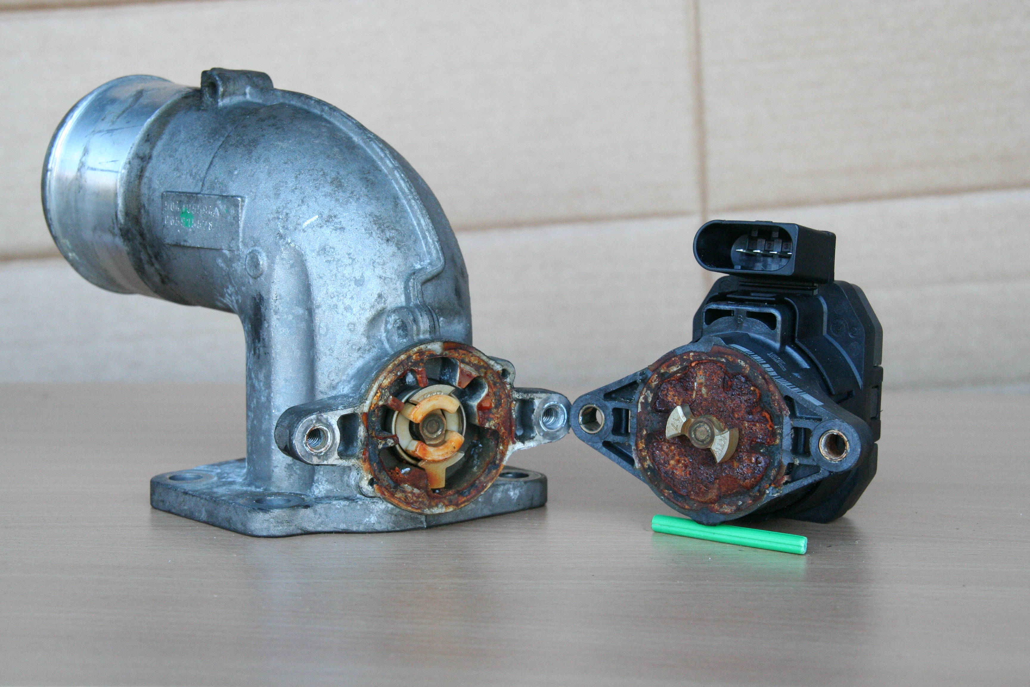

Following my P0638 code I plucked up the courage to remove the throttle actuator.
I found that water had got into the actuator. It had been running off the engine cover onto the throttle actuator assembly.
I dismantled the actuator, cleaned it up and resealed it.
Replacing the assembly on the engine was rather more difficult than removing it due to the inaccessibility of the front offside securing bolt. Although I did manage to do the job without removing the grill, radiator etc.
Mine is a Peugeot 3L 160HDi, having the same Iveco engine as the 3L Ducato.
The actuator is shown split from the throttle body, prior to cleaning, in the attached photo.
I also managed to separate the actuator stator section from the rotor section and give those a good clean.
Needless to say, I then fitted a plastic deflector, tucked under the engine cover, to divert any water away from the throttle actuator!
Hopefully the problem is now sorted, but time will tell.
