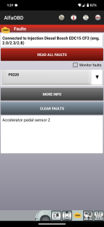

Vehicle starts ok and runs fine, however, when the accelerator pedal is pressed, the EML illuminates red.
OBD code is P0220.

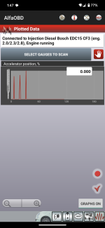

The OBD scanner graph recognises the accelerator being pressed, in the live graph section.
Code will clear, but then returns next time the vehicle is started and accelerator is pressed.
I have replaced the accelerator pedal - fault remains.
