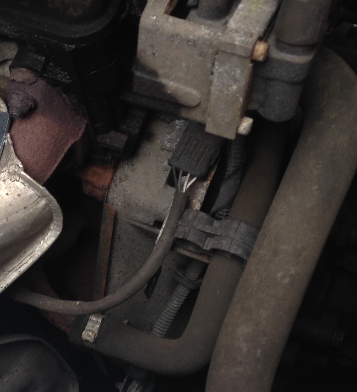

Umm no lol i aint taking computer out in the rain lol
Is there two parts to this sensor?
I thought that the oxygen sensor was the one in the pic but I'm now reading that is lower and connected to the exhaust. I'm confused :-(

There are two oxygen sensors on the exhaust system. Pre Cat and post Cat. Your picture shows the white heater wires of the pre cat sensor and the ribbed protective covering of the post cat sensor cable that goes under the car.
A sensor with the correct plug is very expensive about 70 pounds or so but you can get cheaper ones that need to be connected to the existing sensor wiring where you leave the old plug in place. The sensors should be good for 160,000 miles.

Which should i be checking / replacing or do i need to replace both?
Thanks
po141 comes back as Heater Element Bank 1 Sensor 2
Bank 1 doesn't matter as its not a V block or twin exhaust setup
the sensor 2 is the part we are looking at
Sensor 1 is PRE-Cat (Upstream)
Sensor 2 is POST-cat (downstream)
Each sensor has 2 parts to it - hence the 4 wires
2 wires are for the actual Sensor to detect the oxygen present in the emissions
USually the 2 white wires relate to the coil (heater coil) as that ISN'T polarity sensitive.
The picture posted up is pretty much looking at the Pre Cat sensor
There is a cable just below that - that follows down to gearbox-ish to the post cat
Check the connection there - Resistance check the 2 white wires with a Multimemeter set to resistance
Report back
Me -i'd put some Wd40 / Duck oil in there - remove and refit connector a couple of times
Some oil again - shake worst off - refit
Clear code and monitor the situation
You can always swap Pre and Post sensors around - as they are the same sensor, if the fault moves (new code but becomes Precat instead of post - its the sensor
If the fault stays on the post cat - you've got a wiring / ECU issue
