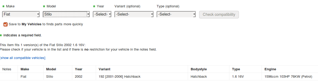

Will that item on the link be ok for me? it looks the same even the blue band/seal are the same,
If you look on Ebay, then on the relevant page where the item is it will say 'See compatible vehicles'.
Click that link and enter your car details. If it isn't compatible with your car it'll say so in red letters.
The serial numbers may not match up simply because the unit is made by a different manufacturer.

3 images attached:
