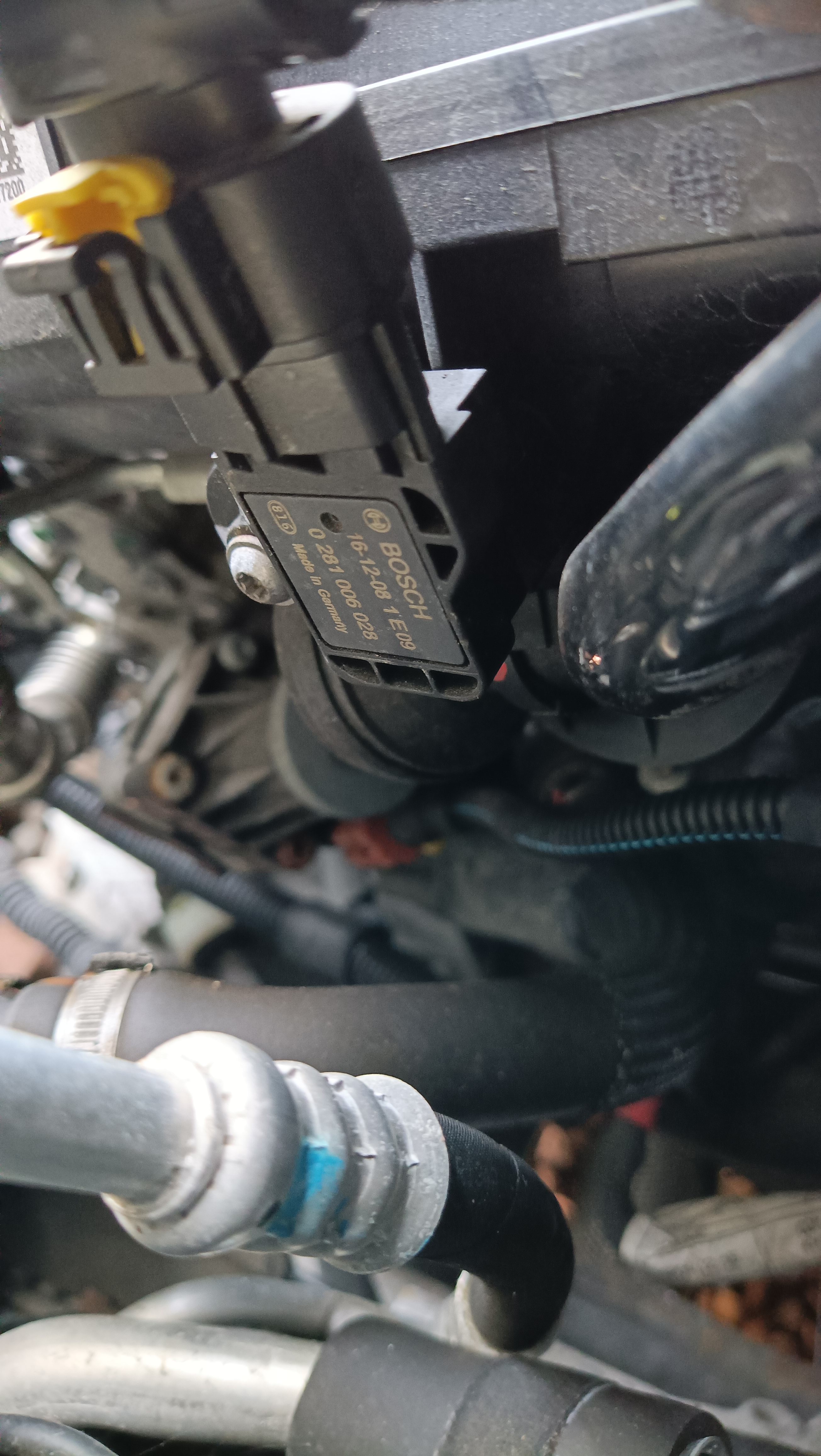

Hi there. The short answer is I don't know! The fault I was experiencing with the check engine light (code P0096), hasn't reoccurred for a while and although it's too soon to tell if it's really ok now, well here's hoping... I found I could clear the fault code anyway, when it was recurring using the "Torque Pro" app on my phone via a Bluetooth connector / sender plugged into the OBD-11 port under the dashboard. I did find a you tube video of a mechanic fixing what was claimed to be an equivalent Renault fault code to P0096 on a Trafic van by replacing the MAP (Manifold Absolute Pressure) sensor. This made me wonder if the MAP sensor also contained the intake air temperature 2 sensor. The MAP sensor is right behind the centre of the engine head at the bulkhead on my TIpo 1.3 multijet. I couldn't verify if that was the cause, because I couldn't get the electrical connector off the sensor, it just wouldn't release ( it's hard to see at the back of the engine and there isn't much access space, ) so on balance I considered it not worth the risk of forcing it (it may not even be that anyway).. I don't know if that helps!

Batunas, thank you for posting this and describing the procedure for removing the connector. I had a chance to look at that map sensor on my car again and well seems to be at back of intake manifold? These engines are quite complex and have a lot more fitments than I have been used to in the past in terms of conventional petrol engines.... However I attach a couple of photos of position, with engine cover removed. As I mentioned although the check engine light appeared with the code p0096 about once a week for a period of about a year, it hasn't occurred for some weeks now...I don't know why... The only thing I might ask, as not being absolutely sure if this sensor was the the cause of the fault code, in your case did fitting the new map sensor cure the P0096 fault? Thanks again

Hello, first i have to apollogise for a mistake, i wrote air filter box but its really in the intake manifold.
The error appeared during warm weather, as its been cold here in Portugal the error appeared only when i drove during daytime/afternoon and in higher revs ( motorway). ( I work shifts!)
Since i changed the sensor, the error did not appear and i feel the car response much smoother and tidy.
Before looking at the sensor i considered that it might be a clogged air filter, changed it for a new one and erased the error . 2 days later the error appeared again.
So far everything is going fine.
Thanks.
