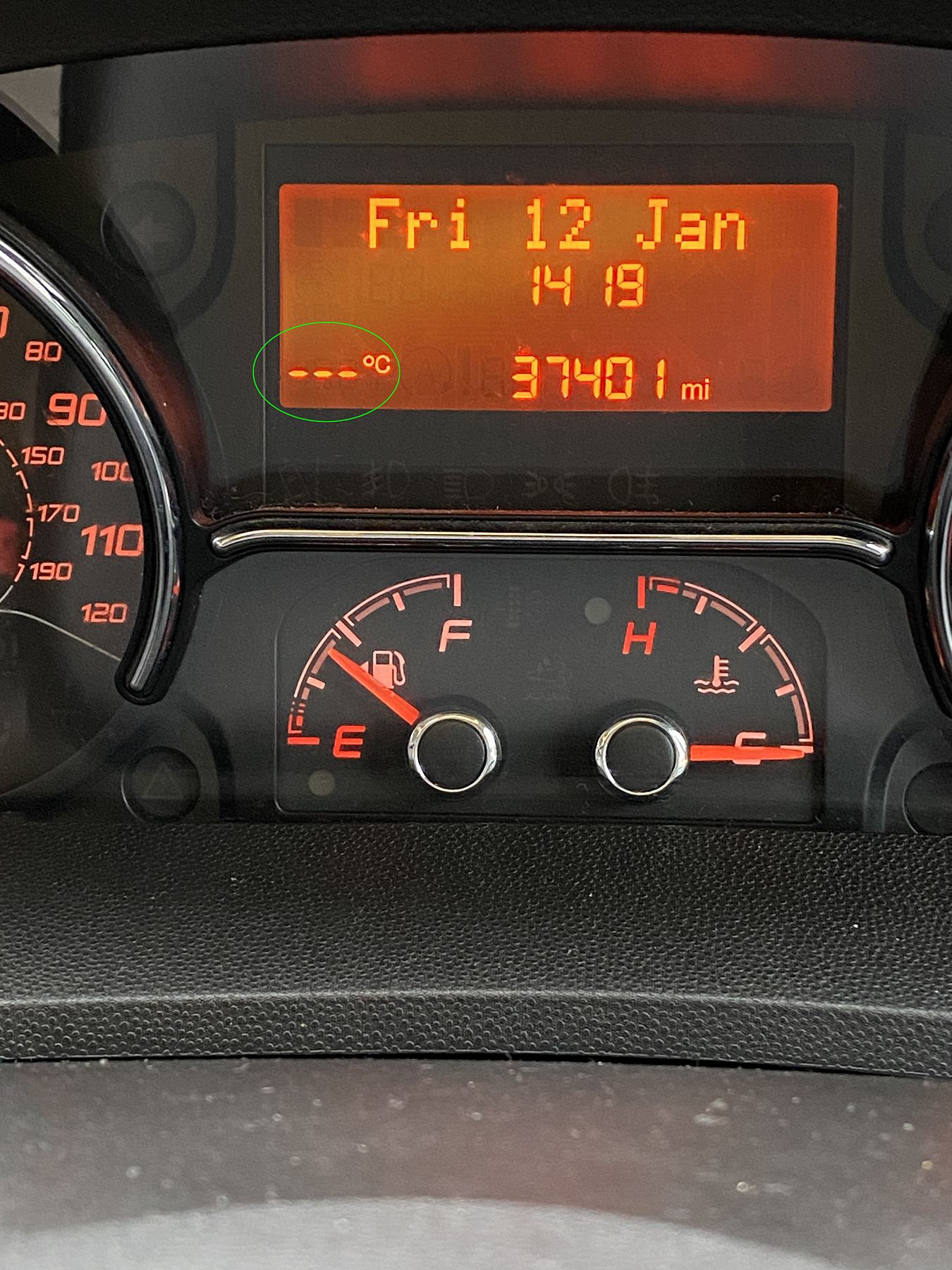

Hi everyone. The outside temperature sensor has died. Dashboard reads ----˚C. I've done a search and came across a few posts that refer to video to replace the sensor without removing the mirror but all the links are now expired. Does anybody have a good link. Thanks.

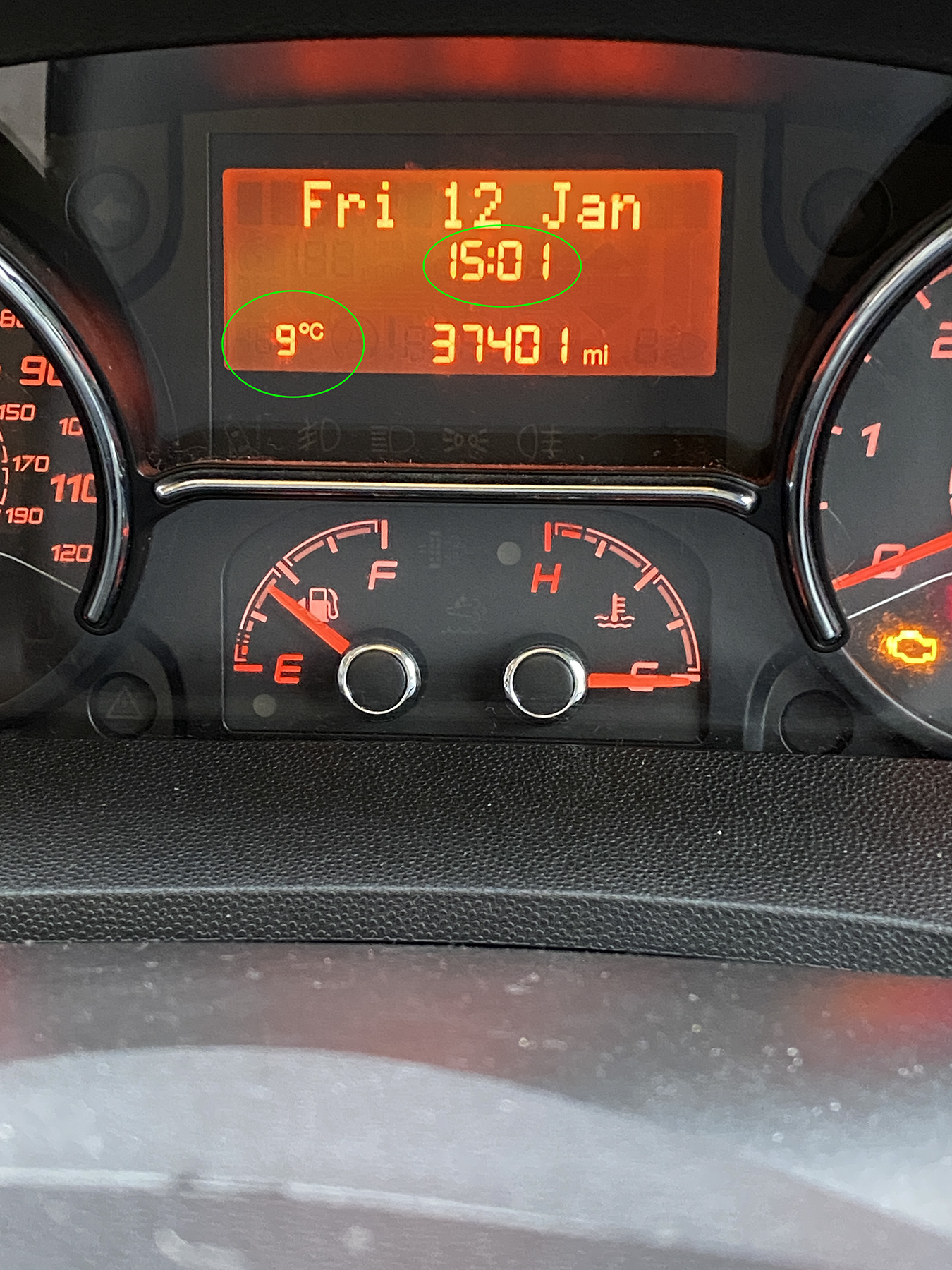

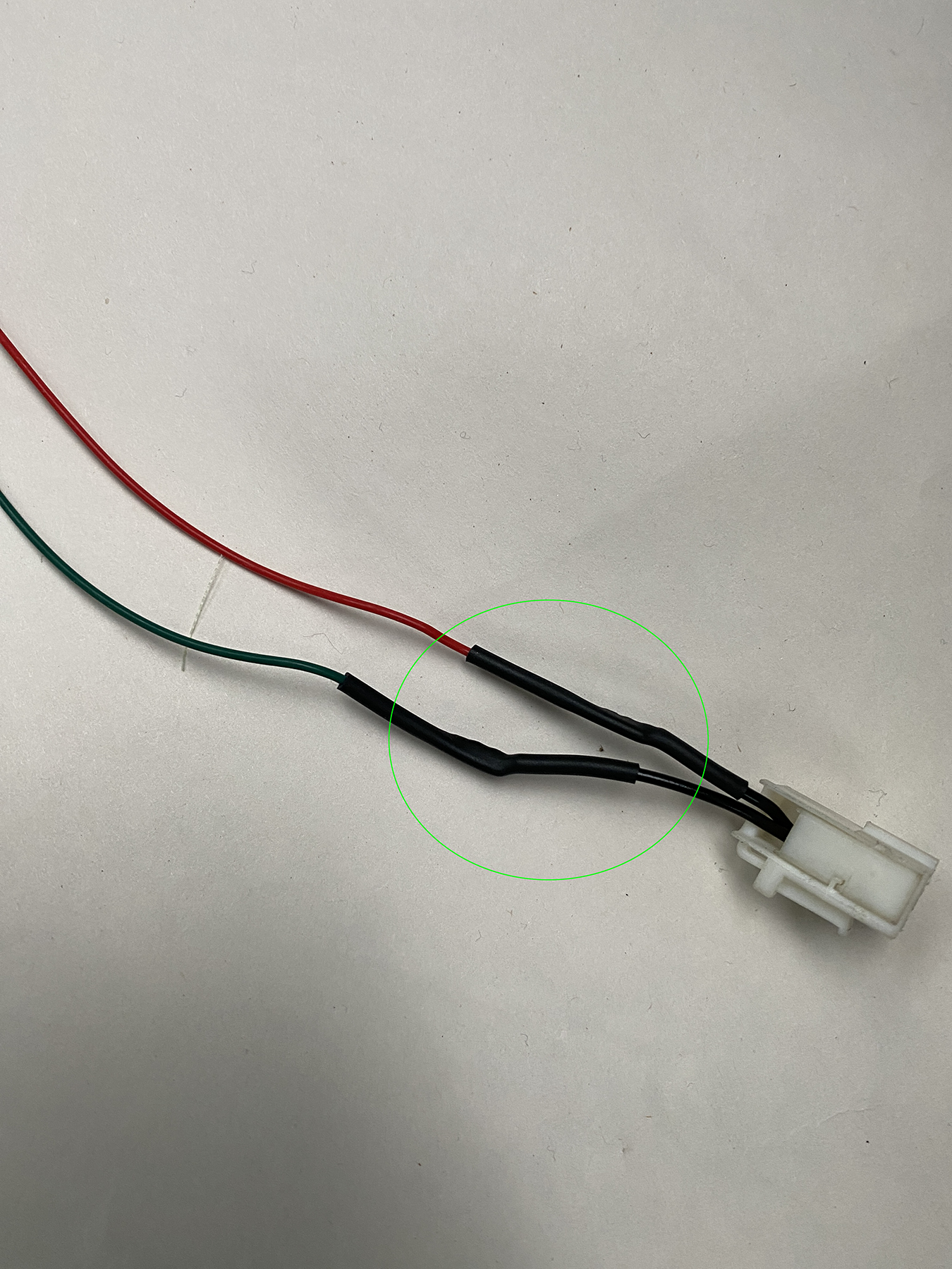

An update on my outside temperature sensor replacement. I bought a sensor from online auction site less then £10. I didn't fit new sensor in the mirror. I cut the wires in the door and connected sensor there. Sensor temperature was same inside door as it was outside. Less than 1 hour from start to finish. New sensor red wire + , green wire - . Secured new sensor inside door using ty-wraps.

Just replaced mine, just replaced the sensor in the mirror and soldered the new one's wires onto the old wires, works fine and only need to take the glass out and the back off the mirror.
