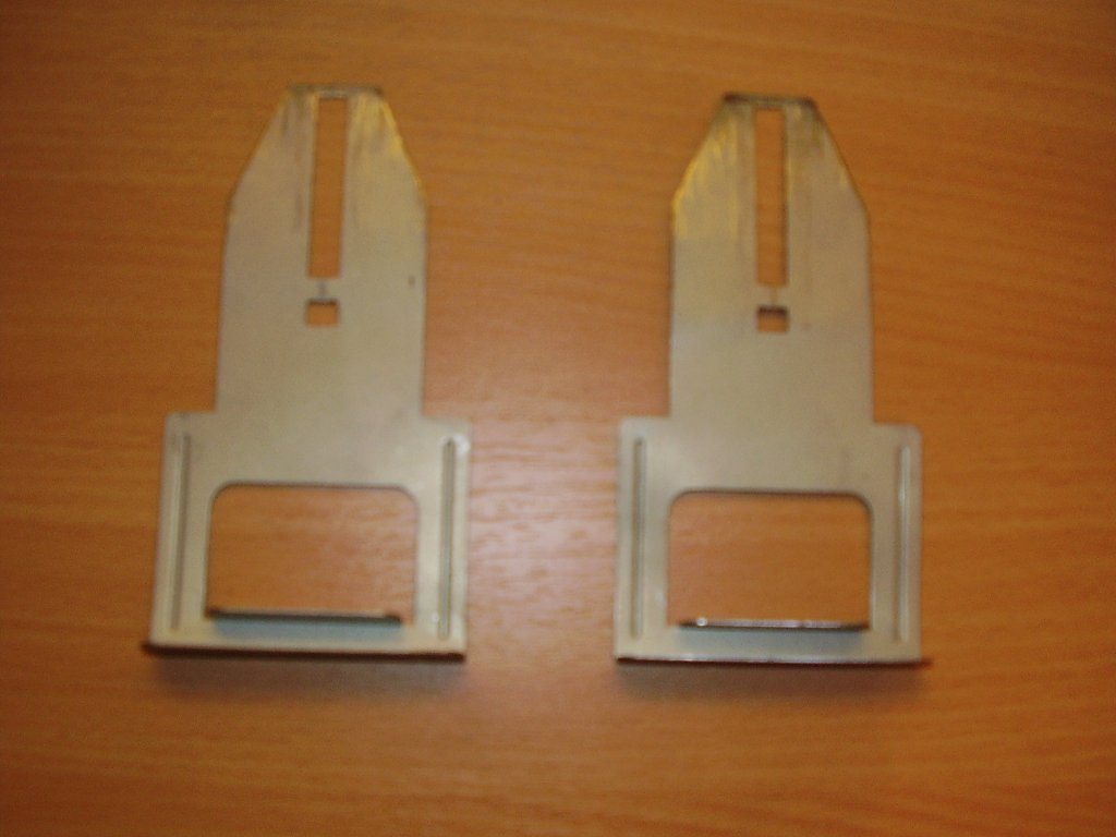

I think you need two pieces of metal that slot into either side of the unit. There are two rubber strips on the front that can be removed
Sorry - have been away for a week so no response. stil haven't managed to get the stereo out as yet. tried with a bent coathanger having taken off the rubber strips but felt that i was about to snap it, so stopped. think i might have to go to someone to get it out. any other ideas?
These are the metal plates that you need to remove the Clarion radio with, fortunately I was given these with the car. [Located them again after putting them in a safe place.]
Sounds like you may need to go to a car audio shop if you haven't got anything like this.

[Thanks for the pictures - i don't have the metal keys so looks like a trip to an audio shop.
thanks for your help - much appreciated

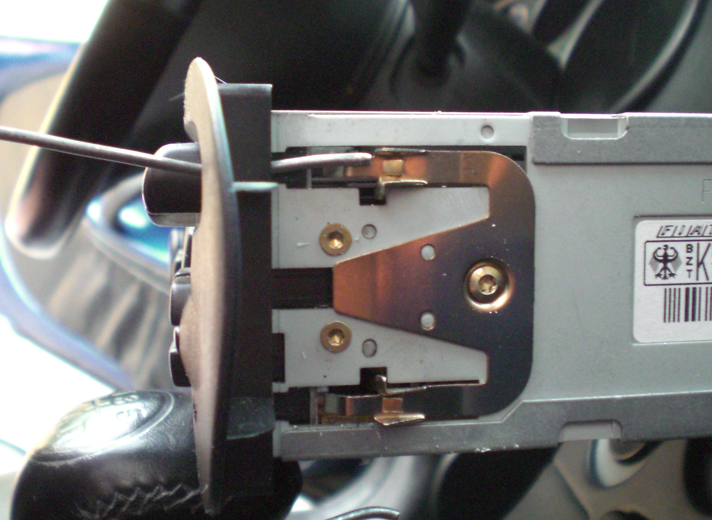

Anyone got more detail on the coathanger trick? Trying to get my stereo out (4-hole stero type). Thought it sounded too easy!

Here you can see the two catches that need to be released with the aforementioned toothpicks or coathanger:
