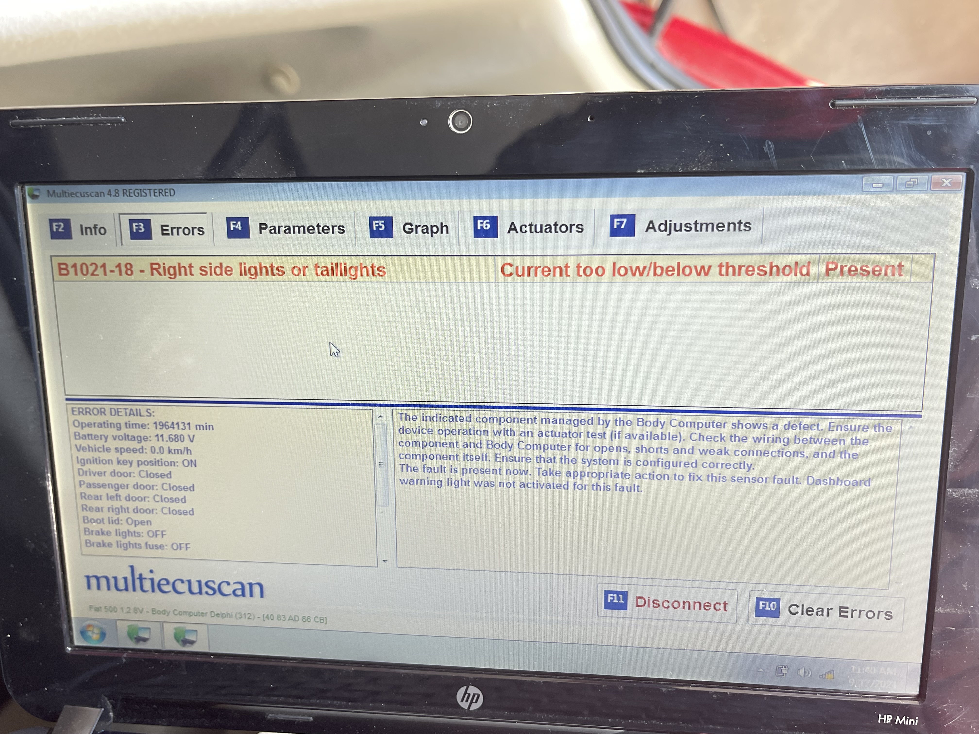

Hello everyone, i see alot of information about orange triangle showing check running lights, after checking with mes it comes the error below, any tips or information would be appreciated.
All lights and fuses checked and working properly, just i hate every time that i switch the low beams this triangle and error shows up 🤯😅. Thnxx again

yes ,boot lid open coz i was checking the right rear lights conneciton for corrosion and test with multimeter the line, key off ok , after key on and switch from daylight to low beam ,,, buum this error again , drls working all other lights working :(

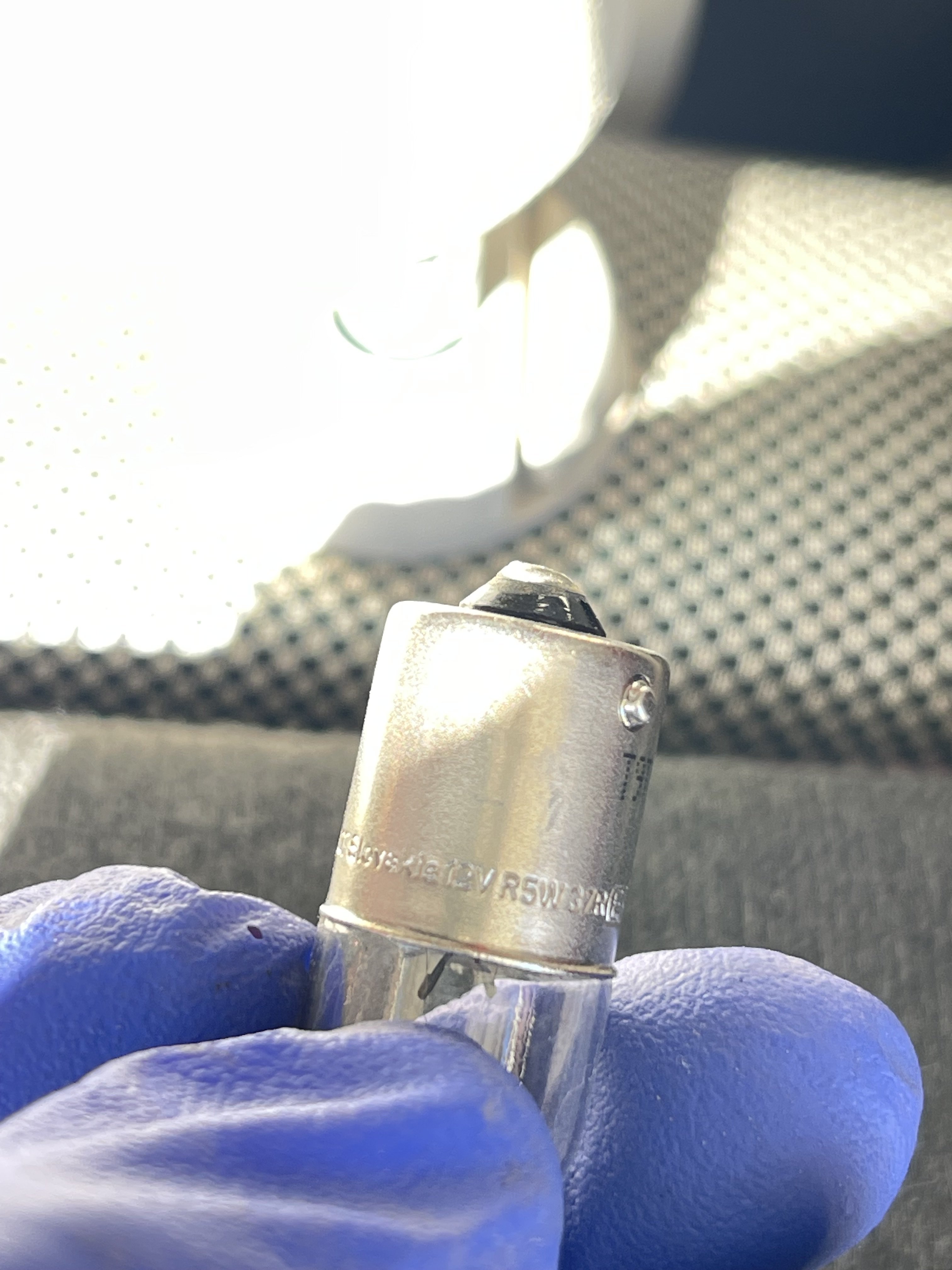

Check the book or even the cluster where the bulb mounts, earlier cars have 10w type later cars only 5w, so if correct the car thinks there's a bulb out, (2×5, not 2×10)
I just ordered it and I will pick it up tomorrow since every store is closed today..y, I just checked it and from the manual it should be 10W, but the former owner did not take care of this, thank you very much for the valuable information

thnx for tip , in my case i think @John202020 found exactly the problem I have, let's hope after I get and replace with 10w this problem will disappear..
