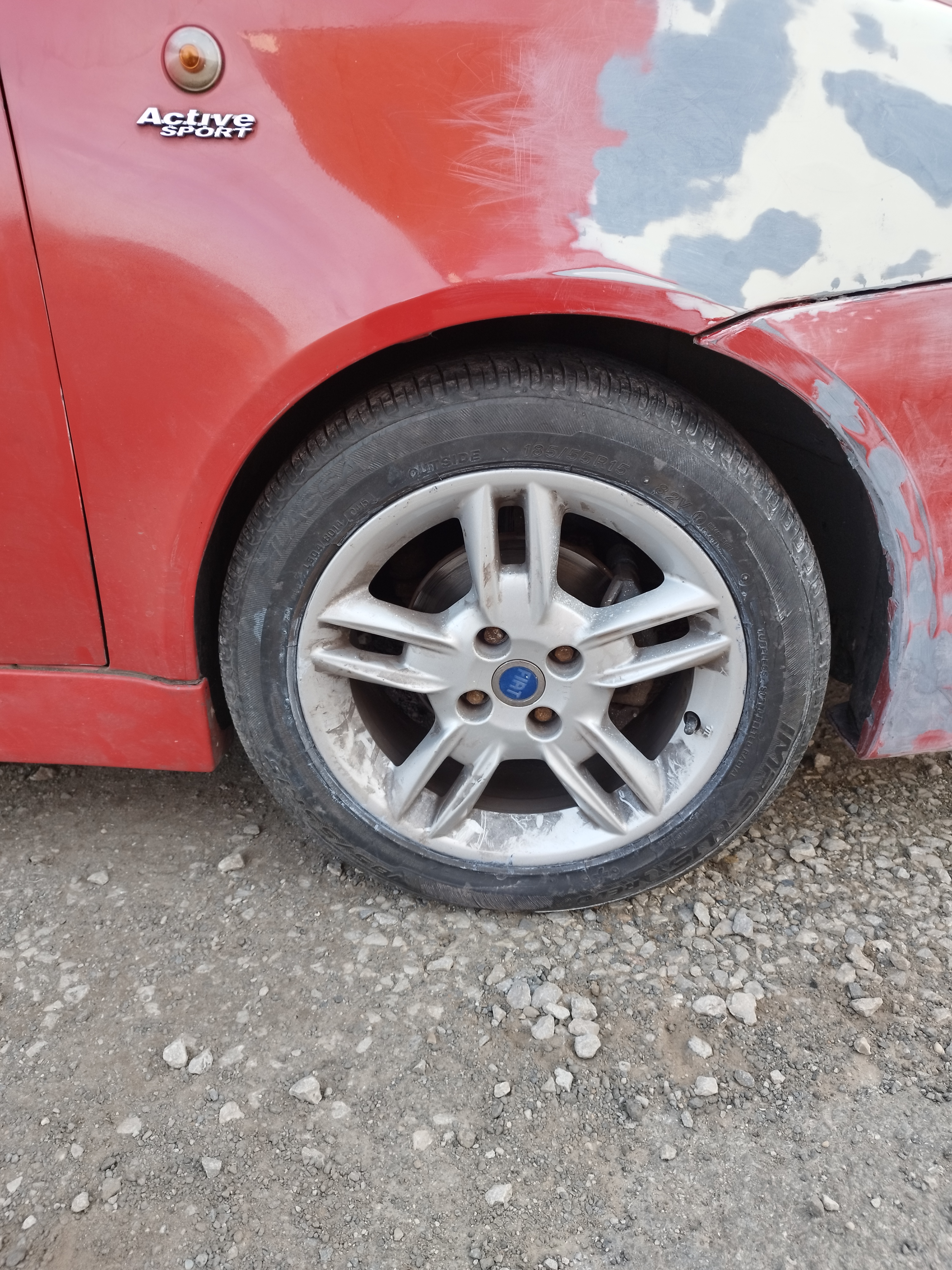

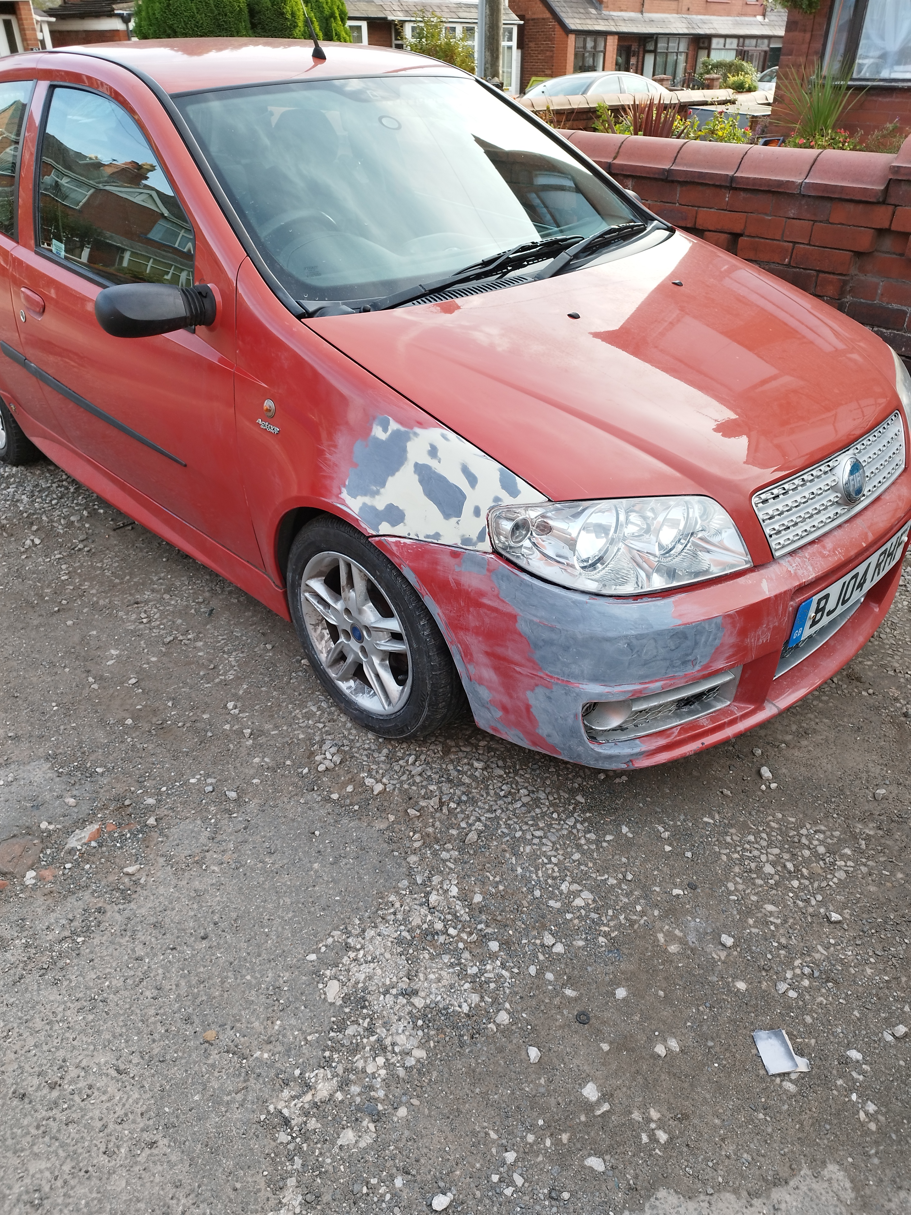

After hours of plastic hot staple welding (the most useful bit of kit I've ever bought for less than a tenner!), epoxy resin, aluminium mesh, untangling and straightening brackets, wing and bumper, I've finally finished the prep ready for paint!
My only concern now is the wheel looks like it's been pushed backwards in the wheel arch (and the outside of the tyre rubs on it on full lock right). See pics

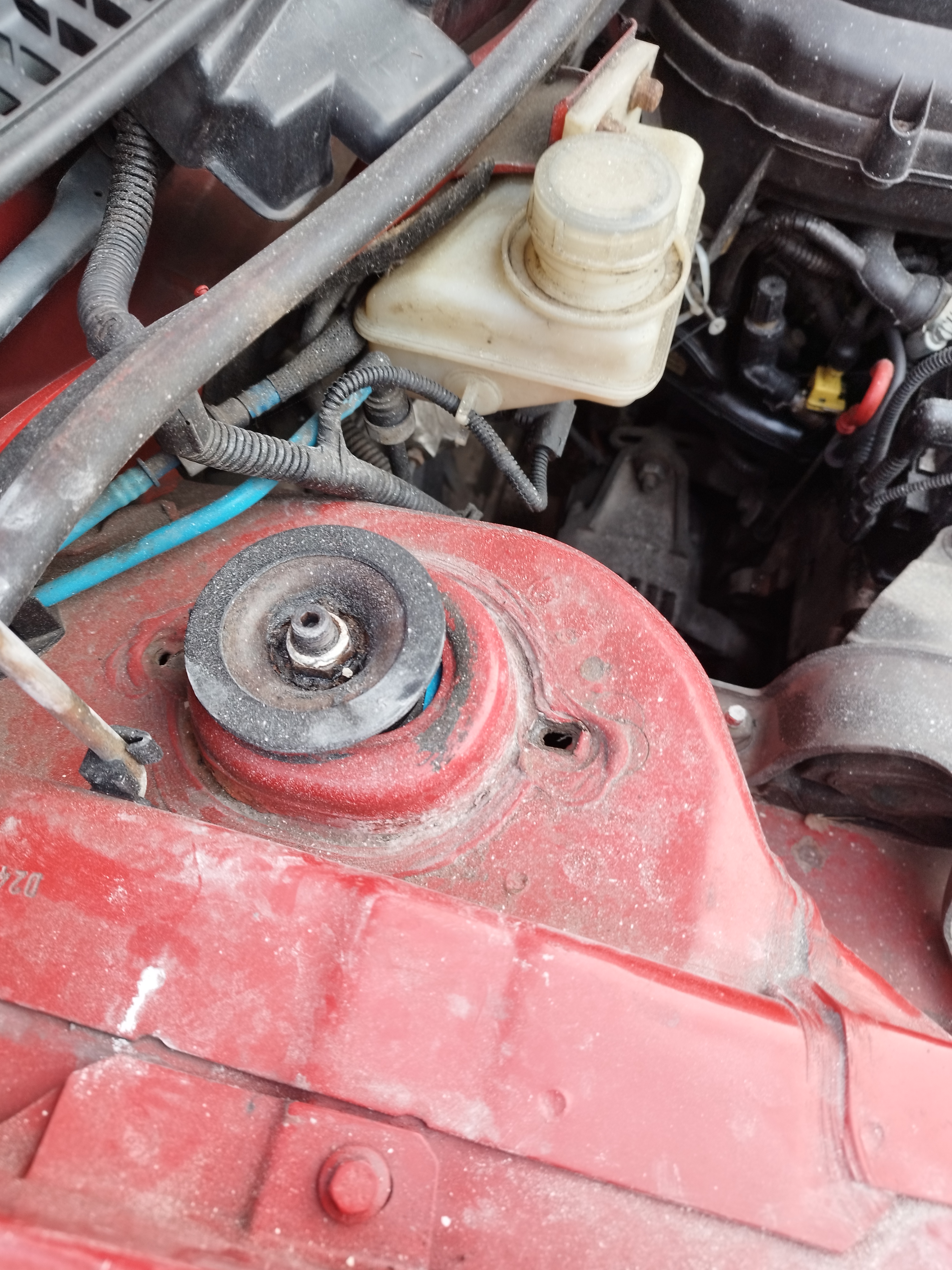

A quick look underneath and the tie rod end is not bent and everything else looks fine except I've noticed the suspension strut cap top has been pushed backwards in the slot. See pics (the second pic is the opposite passenger side strut mount for comparison)
Can I loosen the bolt and push it forward to get the wheel back to the centre of the wheel arch? (Is this just a case of wheel off the ground with a jack, loosen and push forward?)
Or could it be something more serious with wishbone etc?
