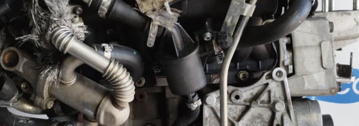

Hey guys i have seen that its some oil leek under my punto but on the back side of the engine can anyone help what and where might be leeking if anyone had same problem thanks !!
I dont know really .. but i got to the mechanich to change brakes and i asked him can i look under the car and suddenly i saw that is some oil under from behing the engine .. he said that is not relly bad but i got my punto for 7-8 years so i want to keep it and i want it to be all good

That's what I was thinking, the hose may have perished/cracked below the plastic container/oil return/breather.
One of my daughters had a 06 Grande Punto 1.3 MJ with that pipe cracked some years ago.
Is there a gasket underneath or something?
I think the pipe and container are are just bolted against the engine block so not a gasket area, the pipe to the right I think is water hose again from memory.
There is an intake manifold behind them, is it possible that oil is leaking there?
