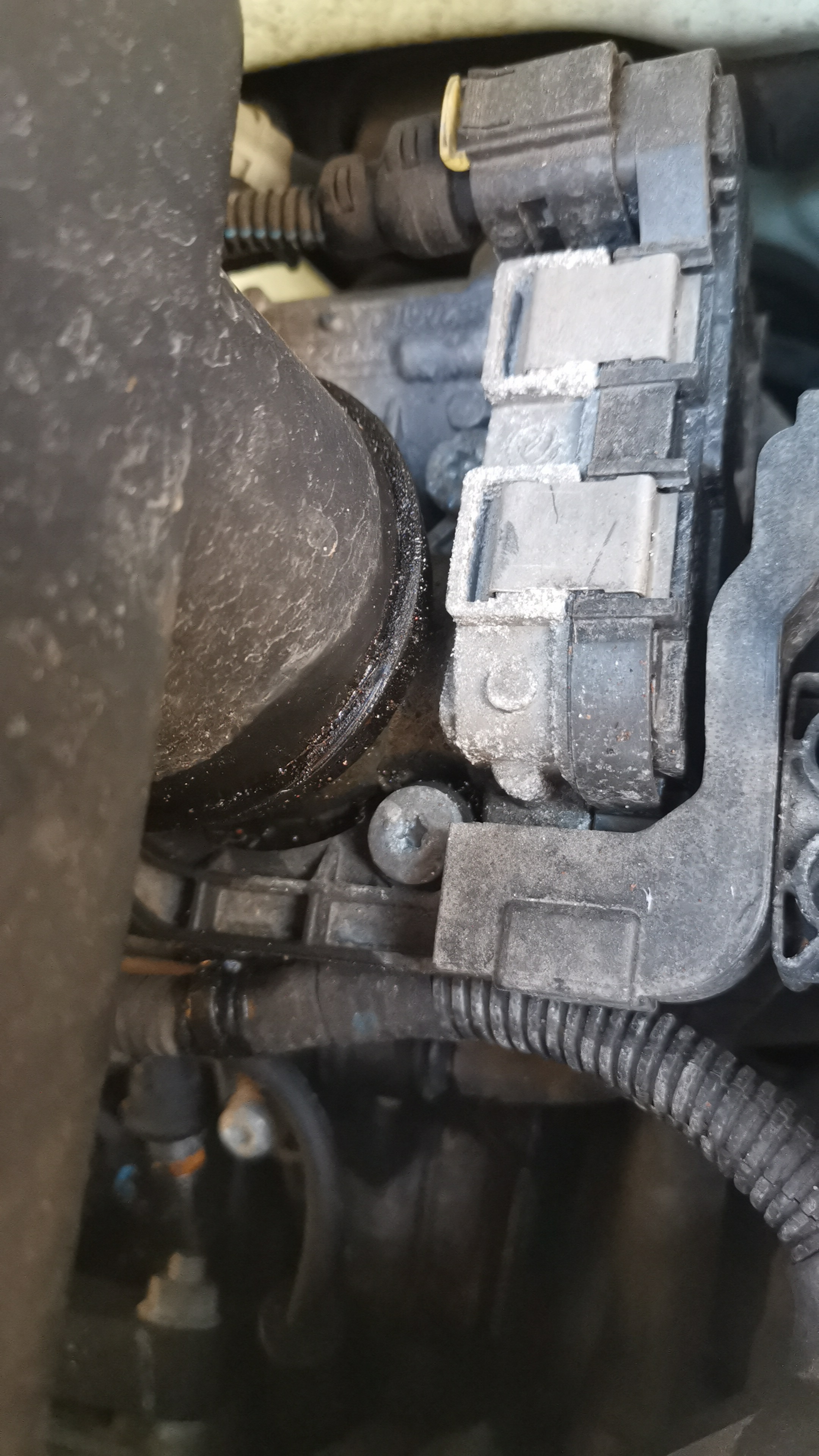

Hi i wonder if someone can give me advice please. I just brought a Fiat 500 2015 reg. Its had a service but i notice oil around bottom of air filter is this a problem i enclosed a photo many thanks
I do not think thats anything much to worry about. There is always a little oil thereabouts and we have 2 1.2 Fiats that have varying amounts of oil there. It comes through the crankcase breather pipes and as long as its minimal its irritating but not anything that is likely to cause major issues. You could clean the area and the inside of the air filter box with some kitchen roll and see what returns after a few thousand miles.
Thing is i only brought it today surely it shouldn't be like that
Looks OK to me based on comparing our which is 2014 40,000 miles. At this age it will not be perfect and you have to accept condition relating to age.. See what others think. I dont think there is anyting missing.

It is not really an oil leak , it is a very slight amount of oil vapour that has condensed in the air filter housing and escaped a tiny bit. Perfectly normal for these engines.
Thanks! Yes it doesn’t seem to be using any oil just noticed it and wondered what it was 🙂
