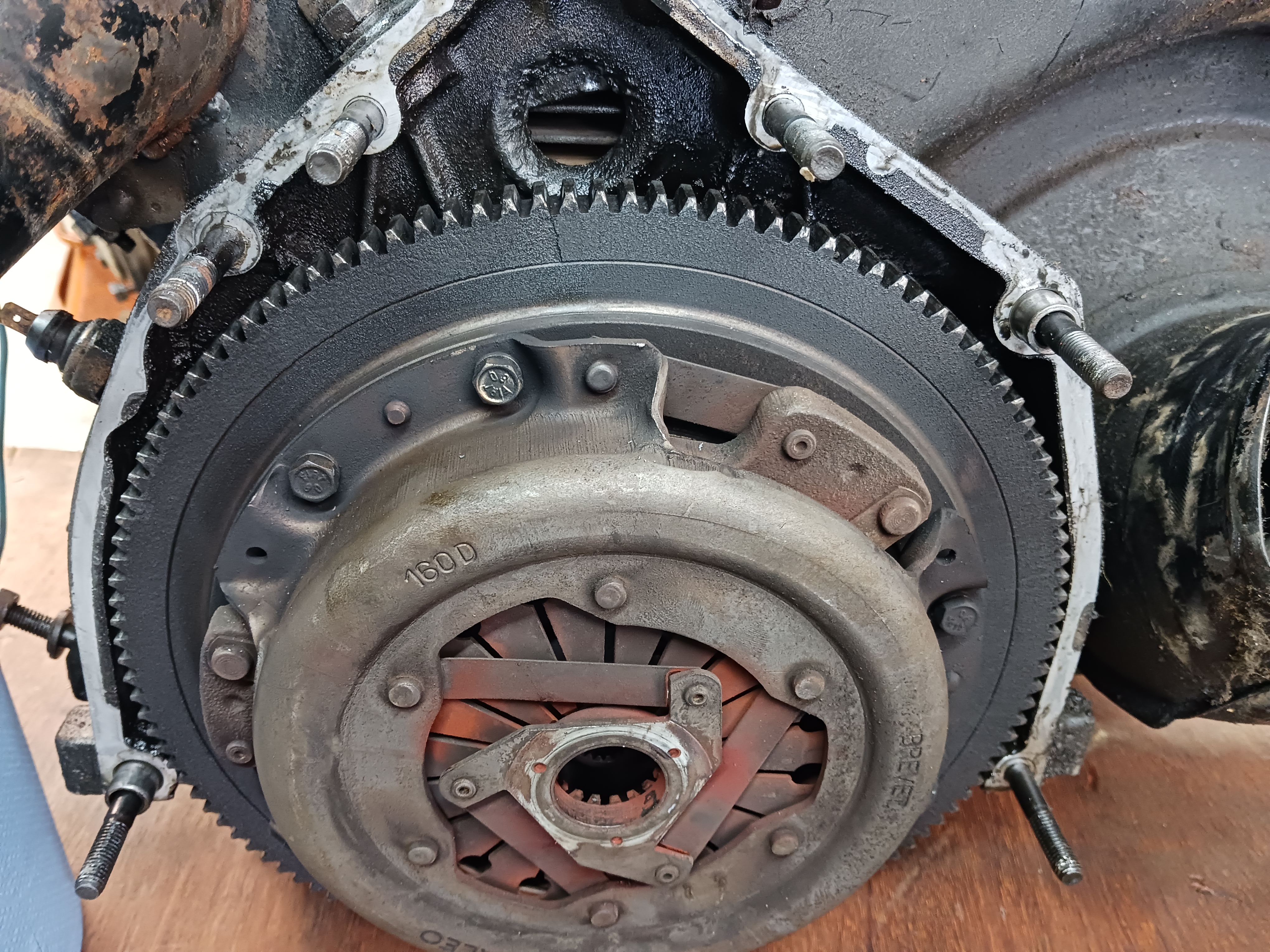

Greetings fellow Fiat 500 enthusiasts.
I've taken the engine and gearbox out as I intend to fiat a 126 box (Mrs A isn't too keen to drive it without synchro).
Significant amount of oil in and around the bellhousing, and a lot of old oil all the way forward externally on the gearbox.
I'd think crankshaft oil seal, but the clutch is dry.
Any ideas?
Is it hard to get to the crankshaft oil seal?

The last Fiat 500 I owned was in the late 1970s, however looking at the photos enlarged on my PC, does it look to you as if the oil mist which is dark like dirty engine oil rather than gear oil may be coming from the engine cooling fin area visible through the round vent above the flywheel so possible push rod seals or rocker cover gasket dripping down and then getting blown around the cooling fins/fan area?
There is oil within the bell housing, but if leaking from the clutch bearing slider shaft I would have expected it to get on the clutch, which your photo shows appears to be dry.
Another test would be to rub your finger on the oil in the back of the bell housing and compare it with the oil from the gearbox, I would smell it also as a guide.
I am not saying it's not coming from the crankshaft seal, as hard to tell without removing flywheel, however I would check the area I mentioned first.
Also where the cooling air is vented from the engine ducting can you check to see if any oil in that area?

If the oil leaks from the flywheel side oil seal then the flywheel will act as a giant flinger which in turn will spread the oil but protect the clutch. They are not hard to get, I have four new ones on the table in front of me 😀

Usually if oil seal leaking there would be a direct line/stain down from that area of back of engine casting/oil seal housing and also "flicking" outwards from the centre of the back of the flywheel from the source of the inertia outwards if you know what I mean.
It may still be a good idea whilst it is apart to check the inside of the cooling cowling/ducting as it may still have been blown in to the bell housing from a oil leak on the top of engine to me going by the oil /muck at the top vent hole above flywheel in your earlier photo.
Incidentally is that a crack in the starter ring gear or just a casting mark at the top of flywheel?
I know one thing for sure that if the engine has been in use for a long while, which many have, then the insides of the tinware get very dirty through oil leaks and general crud which can include old spark plugs, sockets, nuts and bolts, all of which I have found in the bottom of the fan housing on different engines. When I rebuilt my old 500L engine and tidied up the tinware it was like an air freshener was blowing into the cockpit rather than stale oil.

If back of flywheel bone dry it sounds like the oil seal was doing it's job, especially if there was no visible oil trial down from bottom of oil seal area.
It was the first photos you posted, the one on the right that made me think oil was blowing in from that top vent hole above the flywheel especially as there was oil in the top cooling fins of the engine visible there.

Certainly looks like it will account for the oil blowing into the bellhousing.
Re the flywheel possible ring gear crack, I would just give it a light tap with a screwdriver and hammer, hopefully it's only a casting mark, but that should soon tell you.
If it is the ring gear , it isn't that hard to fit onto the flywheel if they are still available, most older mechanics have fitted 100s over the years, we used to saw partly through the old one, give it a wallop with a chisel to remove, then heat up the new ring gear with Oxy/acetylene torch, though you can do it with propane, drop it on and give it a tap with a chisel to make sure it is on square, then let it cool down.

Good spot everyone. Sure enough, the ring gear has a crack running all the way through😢 any ideas on who might supply this?

At the beginning I did say "Incidentally is that a crack in the starter ring gear or just a casting mark at the top of flywheel?" Normally if you tap it with a chisel if cracked and loose it will sound different and try to move.
Having said that, it was probably a good idea to change it as the teeth where the starter engage were showing signs of wear.:)
