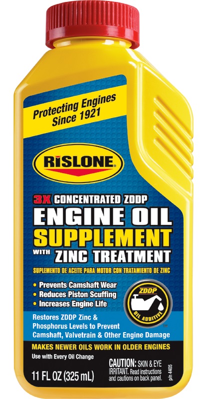

Use 20w50 oil. You can use regular, synthetic blend, or full synthetic. It really does not matter that much for these engines.
I also add a ZDDP additive. ZDDP, which is a zinc additive, used to be put into motor oil all the time. It was added to help protect flat tappet type lifters. It was eliminated from motor oil when catalytic converters started to be used in the USA in 1975. It was not good for catalytic converters. There were other additives added to oil to replace ZDDP, but they were not quite the same. This Rislone product adds this back. It is not expensive and you only add a small amount per quart of oil.
So to review. Use 20w50 oil of any type. Add a Zinc additive into the oil following the instructions on the bottle. You can buy this at just about any auto parts store.

jjacob, interesting about the zinc additive, I'll have to look into that.

There's a lot of discussion about it, including not needing to add a zinc additive with this oil because it already contains it:

Some good reading material, but it seems the T4 should give good zinc amounts, without having to resort to a zinc additive (y)

If you have a standard 500, Castrol 20/50 is as good an oil as you can put into these wee beasties. The ZDDP additive, in the recommended doseage, will do it no harm and probably a lot of good. (y):)
