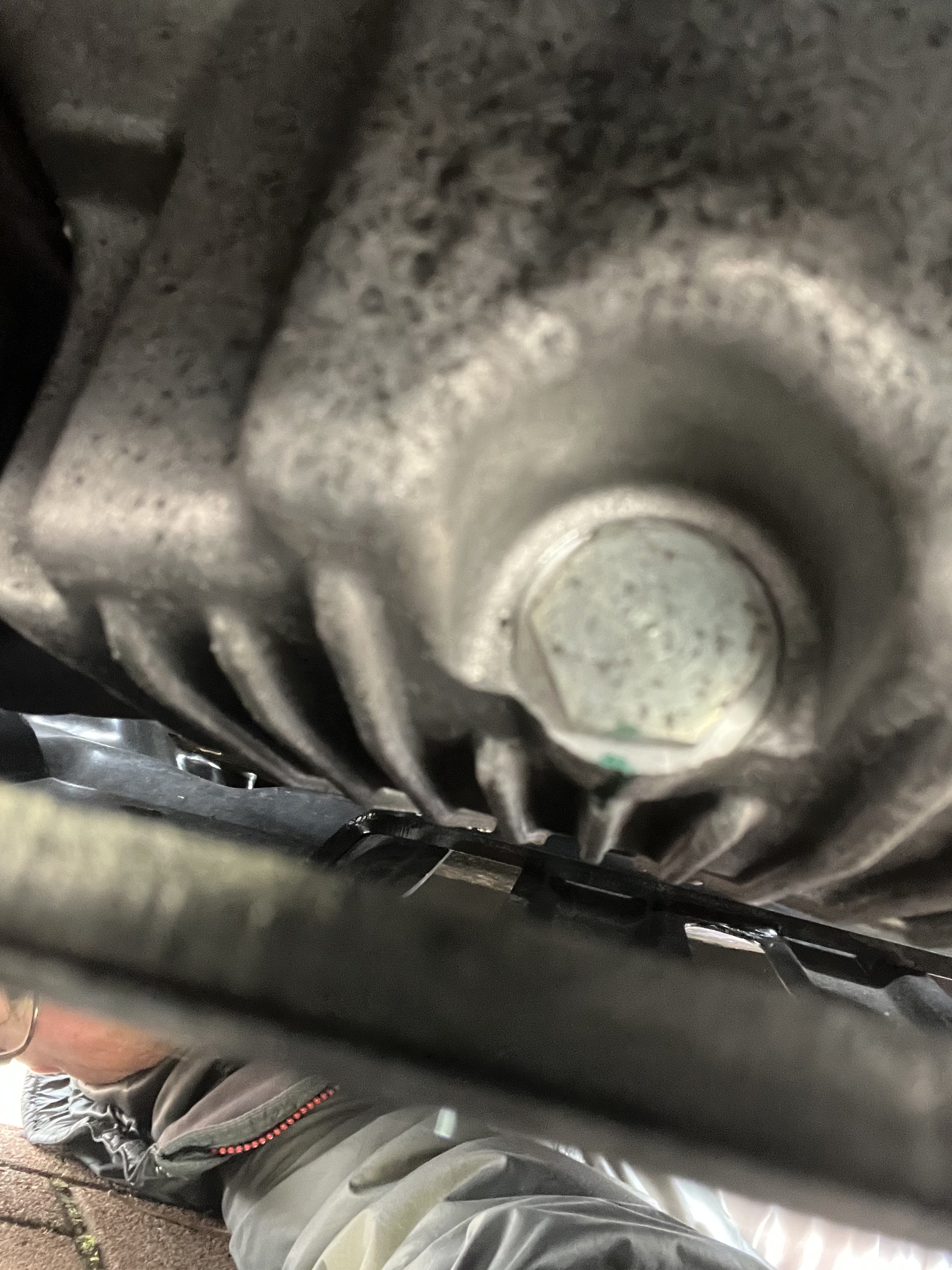

Here's the sump on my Panda TA 4x4 2023.
I bought a 14mm ring spanner plus a I've a 14mm socket too.
There's a video on YouTube of the Fiat garage (down south somewhere) DIY guys changing the oil on a Panda 4x4 and the guy uses a ring spanner in the video.
I can't edit the above guys, it was a 17mm spanner and socket I bought not 14mm.

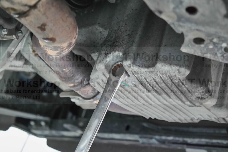

Here's a good step by step to change the oil and filter on a TA.

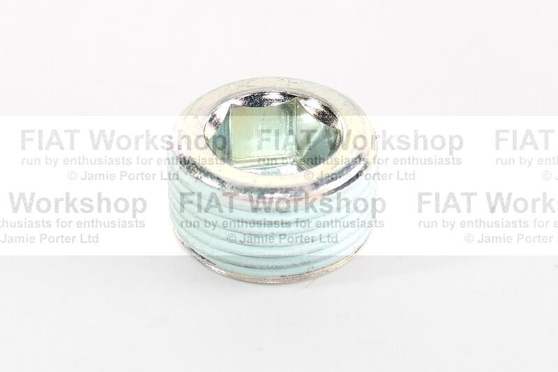

I could have sworn mine was a hex key
Maybe I’m thinking of the daughters 2009 cross
