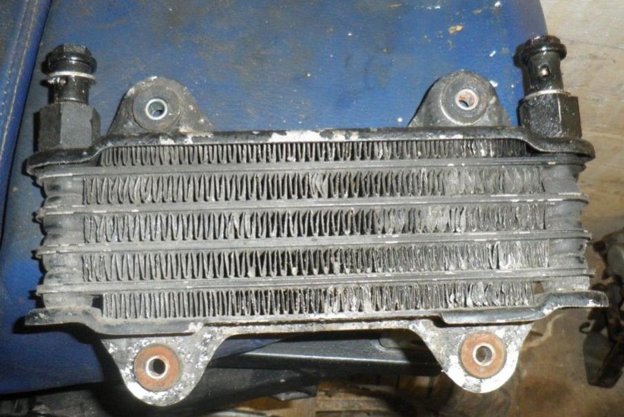

I bought an oil cooler from a 1988 GSX 750 bike. (I can take dimensions this evening.) There are a lot of bike oil coolers that are a good size, this was just a random gamble from ebay. Many bikes have non-standard pipes so check the fittings look normal.

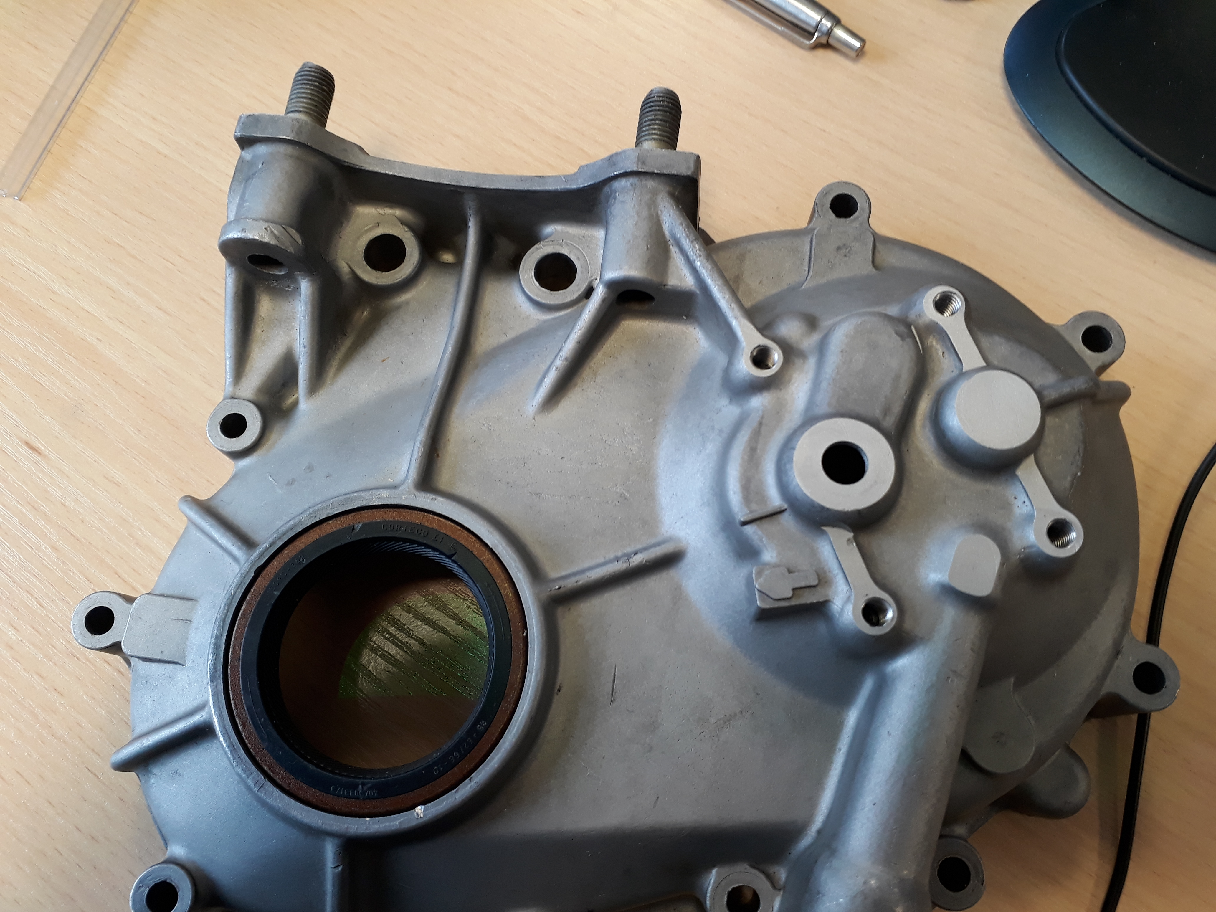

I plan on fitting mine under the car roughly where the petrol tank sits in a 126 so it sounds like my set up will be similar to yours. I've added a photo of the modified timing chain cover. I don't think there are any modifications to the inside, but I can check against a standard one. I will also post a few photos of the CNC block that bolts on top. As I mentioned in the other post this is a loan but I intend to have the fitting braised on. O-rings are great, I prefer to avoid additional sealing points.

Michael hi, If you don't mind can you also take pictures of the inside of the pump to see the gear mod? I still don't get from where the oil passes if you block or restrict the gear hole down to 2mm I guess I will when I get mine in hand. Anyway post as much as you can if not a problem. As for the take out I am planing also to weld an output but I also might buy the adaptor. Your cooler is nice and I am looking for something similar.
I'll get another photo of new and old compared, it might make more sense. The M4 Capheads normally live on the outside to hold this adapter in place:

I just fitted them inside so I don't loose them. The oil cooler was very cheap. If you are looking for a low cost oil cooler I would suggest a motorcycle autojumble, it's a great way to hunt for a cooler by size rather than by bike.

Tom, back home now and, as promised, details of the installation that I will be fitting on my '695' engine (being slowly built up, as funds allow). There are a variety of fitment units---the Nanni Ricambi remote oil-filter kit only uses 3 of the 4 oil-pump bolts---other units, as per 'Mod500's' pictureof the timing-chain housing, uses all 4 of the oil-pump retaining bolts. In his case of my kit, the 3 bolts securing the oil-filter housing go all the way through (from the pump side) ----oil-pump/timing chain housing/oil-filter housing and are then secured with nuts on the outside. I have managed to find some ny-loc 'dome'nuts which will look neat and tidy. Also,doing it this way means that there is almost no chance of anything falling off into the timing-chain housing (e.g.a nut if it was secured from the outside, inwards). The securing holes need to be tapped all the way through the timing-chain housing. The oil outlet hole is, in my case, 9mm---I suspect that it is this size in most of the kits. Sealing the oil take-off, be it for a filter or an oil-cooler is made with an 'O' ring seal, in a groove in the section of the take-off that sits against the timing-chain cover.
Another way to achieve a 'take-off' is, if you have access to a GOOD welder, to simply weld on an aluminium hose union of the required size for the hosing that you use.
The DRIVEN gear wheel in the pump is the gear to modify---if left un-modified I am told that the oil pressure builds up too much. Tap a thread into the end of the gear AWAY from the cam-shaft. One way is to plug that hole with the correct size bolt, cut of the bolt flush with end of the gear and then drill a 2.5mm hole down the middle of the plug. The other method is to make a small plug (from a bolt) that will thread into the tapped end of the gear with the 2.5mm hole already drilled. Cut a screw-driver slot into the plug to enable fitment. DON'T FORGET TO LOC-TITE THE STUD IN PLACE!
As you are most probably aware, the oil-return hose fits into the crank-case in place of the blanking plug on the crank-case just ahead of the timing-chain cover at about "2 o'clock". They can be a right bugger to take out!

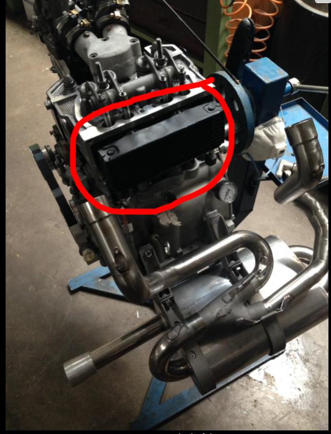

You are killing me Peter;) in fact i have seen mine reaching 120 while hill climbing at a Greek summer hot day and i couldn't get my eyes from the temp cage until start descending form that mountain. Summer will be here within a month so i will start soon. This summer goal is to pass that mountain at 95 Celsius top Also everybody check this ''not so wise'' in my opinion cooler installation except if you live in Antarctica or something

What is the black part on the side of the head?

Looks like oil cooler to me!
While that is very neat, I'm not sure your oil cooler will be doing much. You will be using air already warmed up by the head to cool down the oil. it's better to use air that hasn't already been heated.
Assuming the ambient temperature is 30 degrees, Air at thermostat is 70 degrees and oil temperature is 100 degrees. With a remotely fitted oil cooler there is a potential 70 degrees difference in temperature to cool the oil. With an oil cooler using thermostat air there is a potential 40 degrees difference in temperature to cool the oil. This setup would be best suited if the idle temperature was too high, but the running temperature was ok.
Can you get the engine running off the car and map the temperature change with the oil cooler next to the head, and further away? It should give you some good data before committing to fitting the oil cooler there.
I think that you will find, if you look at Tom's initial comment, that this something he has seen and questioned the sense in putting the oil-cooler in that location. I think that we all agree that it is a pretty daft place to put ANY sort of cooler!
