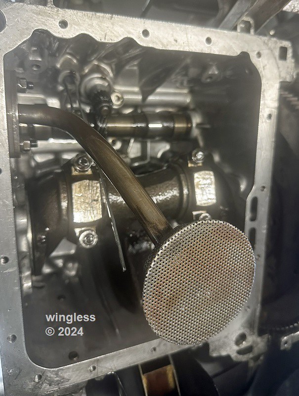

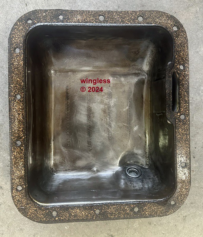

Just completed my first oil change on my new-to-me 1968 Fiat 500L.
In my case I removed the oil pan to permit extensive cleaning and internal inspection, after removing / replacing the oil pan drain plug.
The internals were in great condition. As expected, there was a very small amount of sludge on the bottom of the pan, below the slightly higher drain plug lip.

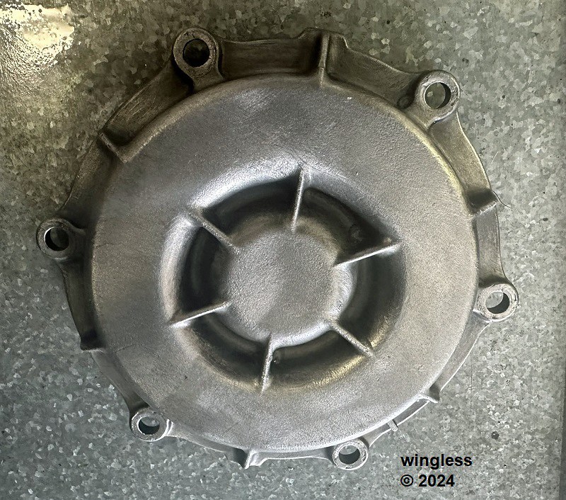

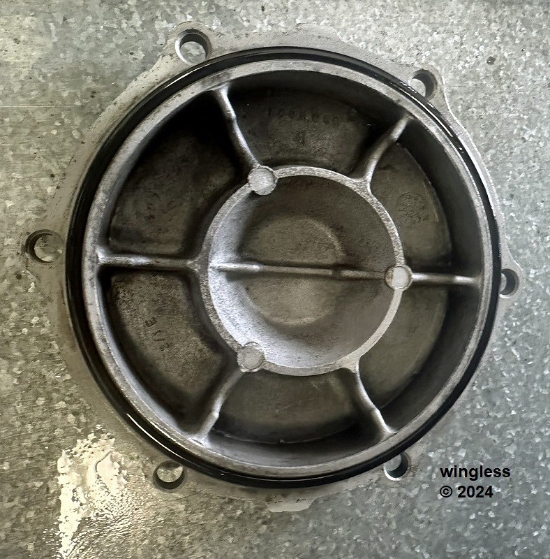

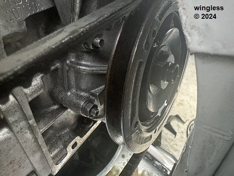

The oil slinger (filter) cover was removed and the internals were cleaned w/ a toothbrush and solvent. The internals were not that bad. A new O-Ring seal was used prior to cover replacement.
VERY much like the easy engine cover removal / replacement to improve service access. Disappointed that the rear engine mount restricts access for cleaning the engine side of the oil slinger. Will use my engine lift to permit temporary rear engine mount removal for inspection / cleaning during the next oil change.
Used Penn Grade 1 20W-50 Synthetic Oil during the change. I like the high phosphorus and sulfur of this ZDDP oil.

I notice "Wingless" that you have use a 'cork' sump-pan gasket-----from experience I would suggest that the 'rubberoid' is a better choice. The cork gaskets tend to get squashed and pushed out when tightening the sump-pan retaining screws----the rubberoid gasket does not rally suffer this problem
Thanks for the info.
The image shows the "original" gasket. A replacment gasket has been received that is also a "cork" material.
My limited search has not located a rubber gasket for this location. Is there a link for a rubber gasket for my 1968 500L oil pan?
