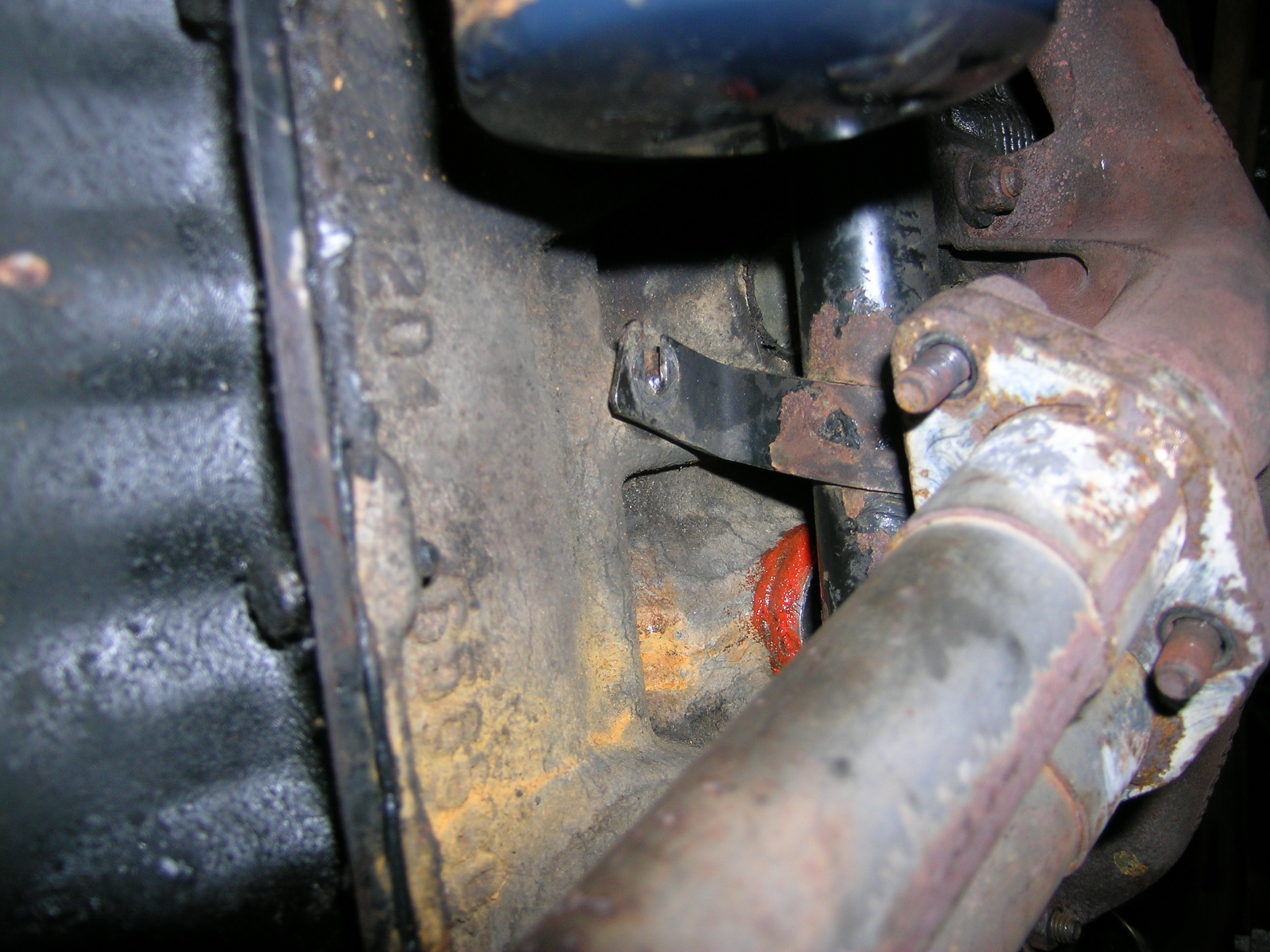

Well today will be better i thought.....took off the exhaust manifold..pulled out the coolent tube that goes into the back of the pump...banged in the core plug..First mistake..(not as straight as i would like!!!)
Loads of gasket goo around the coolent tube...went to tighten the small bolt which holds the tube to the engine to stop it moving around..and then..DINK..it snaps the head off!!!!!..Leaving the thread inside!!...(see pic)..now i have no way of attaching it...what a crap design, only one small mounting point.

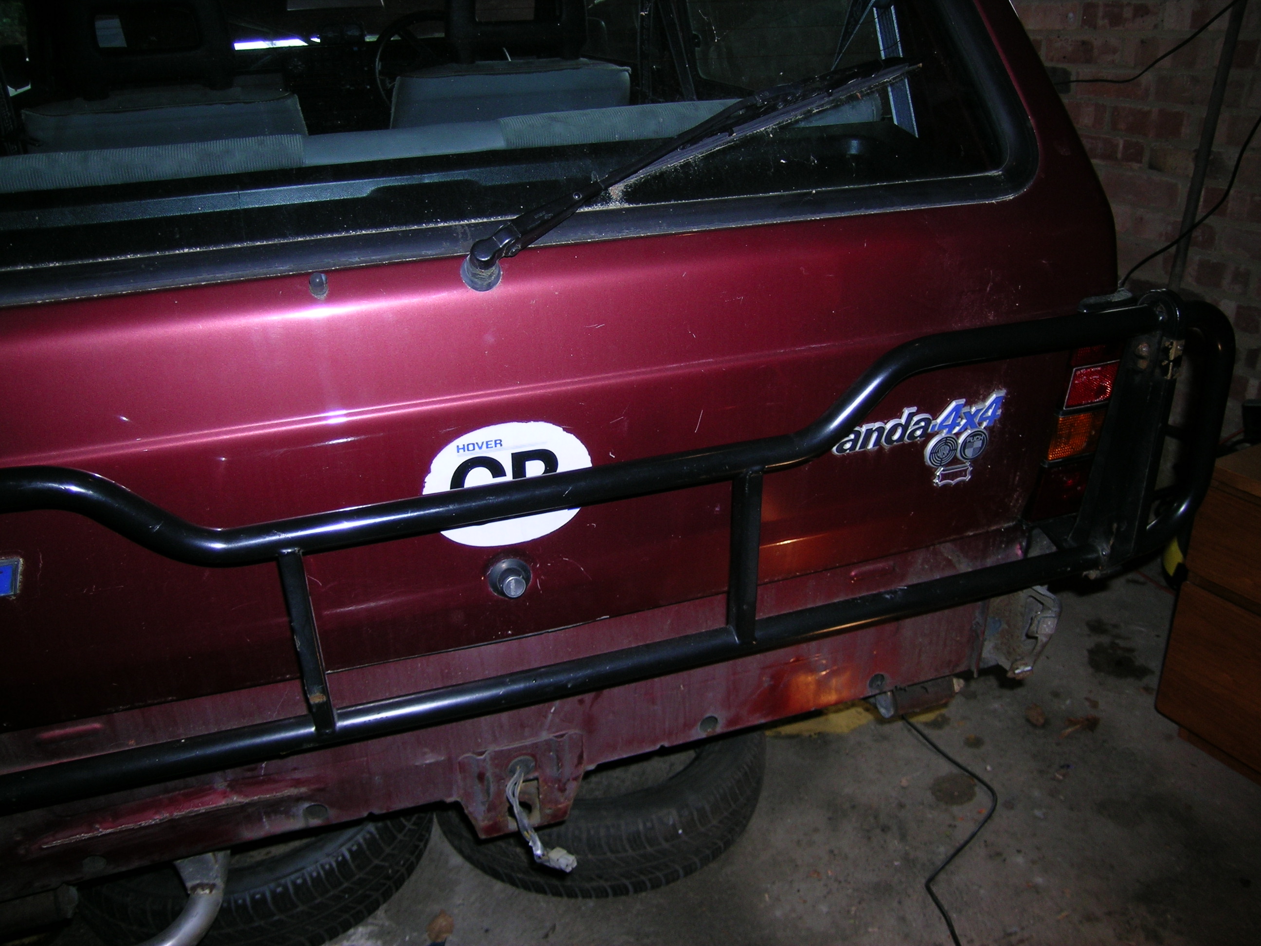

Put on front and rear bars..(see pic)...All finished i thought..

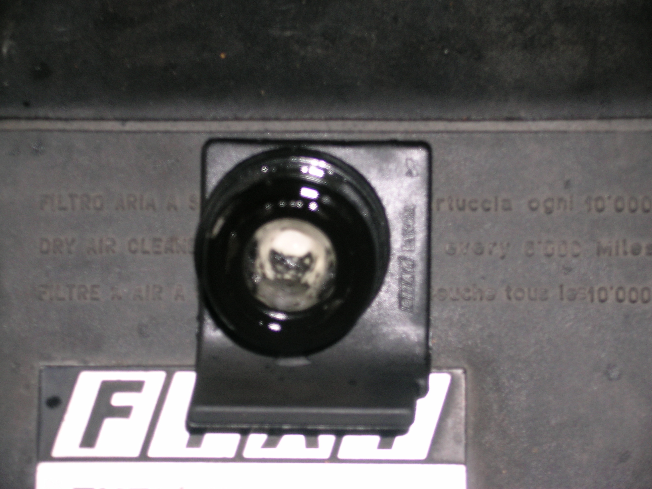

Check oil...and yep you guessed it...MAYO!!!!...so yesterdays prob has fecked the head!!!..:bang:
So bring your chips around to mine...got lots of mayo to dip them in!!!!:cry:

Hang on. I thought yesterdays problem was a fuel problem and then the core plug. Hows that linked to HG :confused:
Dip the dipstick and see what oil is like there. I had a slightly mayo oil filer cap on the Selecta and started to panic, only to be told it could have just been condensation from where it had been sitting for a while.

The top of the dip stick has mayo on it...i'm just guessing if the engine was hot enough to burst the core plug then it could have done the HG.

Drill it out and retap it, is the only way (other than ignoring it).
As for the head gasket, it could be moisture from when its sat, fill it up and run it for bit before you fear the worst (although it probably is) but head gaskets are pretty easy.
Drill and tap is the way to go..getting a drill in without taking the engine out looks like a pig!!

If you remove the front bumper, radiator, exhaust manifold/ downpipe and coolant pipe you may have enough room to get a drill onto the broken bolt. If so, drill a small hole in it and then use a stud extractor to get the remains out. It may well work.
As for the mayo, if there's no sign of overheating or coolant loss this may be normal for an older car. My FIRE Unos would produce a bit of mayo but normally only in the colder months. Try driving Sid around a bit and get him up to temp., then check the expansion tank part of the radiator for signs of bubbling that may indicate head gasket failure. If there's no sign of bubbling and no sign of a decreasing coolant level then you may be worrying needlessly!
