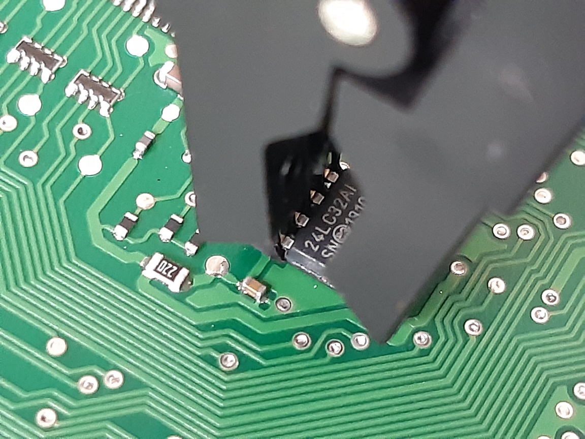

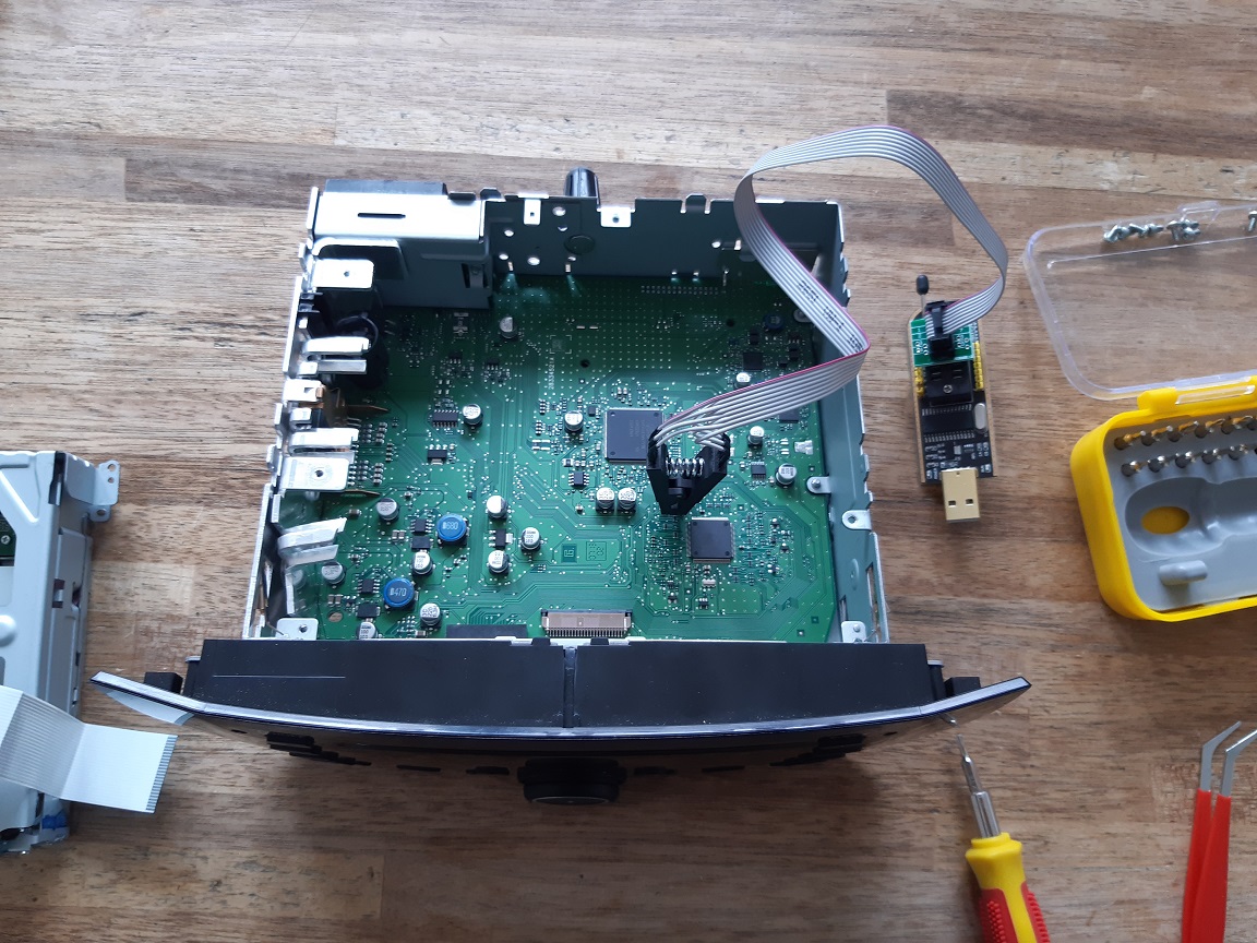

  1. Replaced the Delphi head unit, copied the EEPROM and it's working as it should. Problem did not go away.

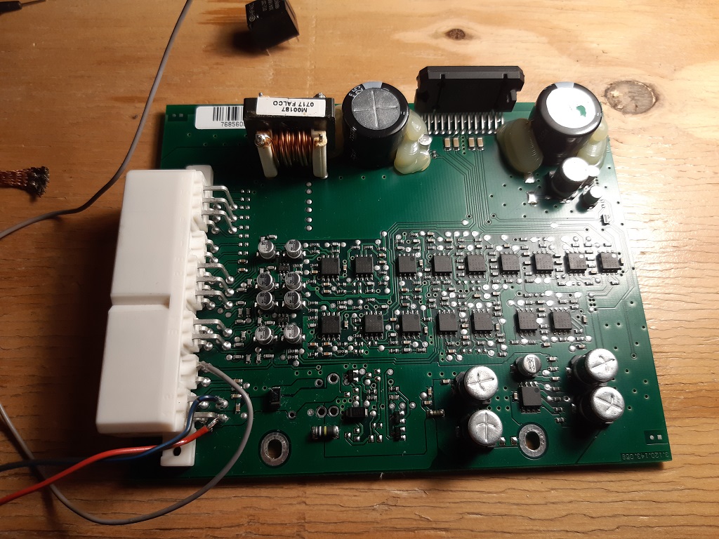

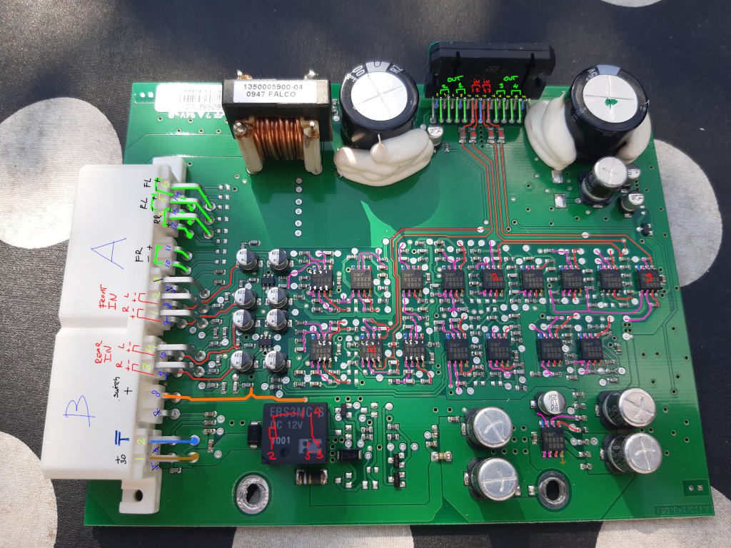

As mentioned above by Asteris I started to suspect the wiring loom. Unfortunately it was not as simple as a switching wire. Checked the wires with a multimeter and they were all fine. I started to suspect a shorted wire in one of the speaker connections that would force the amplifier to turn itself off. I wanted to rule out the amplifier by taking it out of the loop, but the Punto with Interscope radio has a different connector and no direct way of plugging the speakers in the Delphi HU. Took me a few hours to decipher the electrics in eLearn and I found that all input- and output wires run through the connector at the back of the amplifier. I took the plug out of the amp and created a bypass for the speakers.

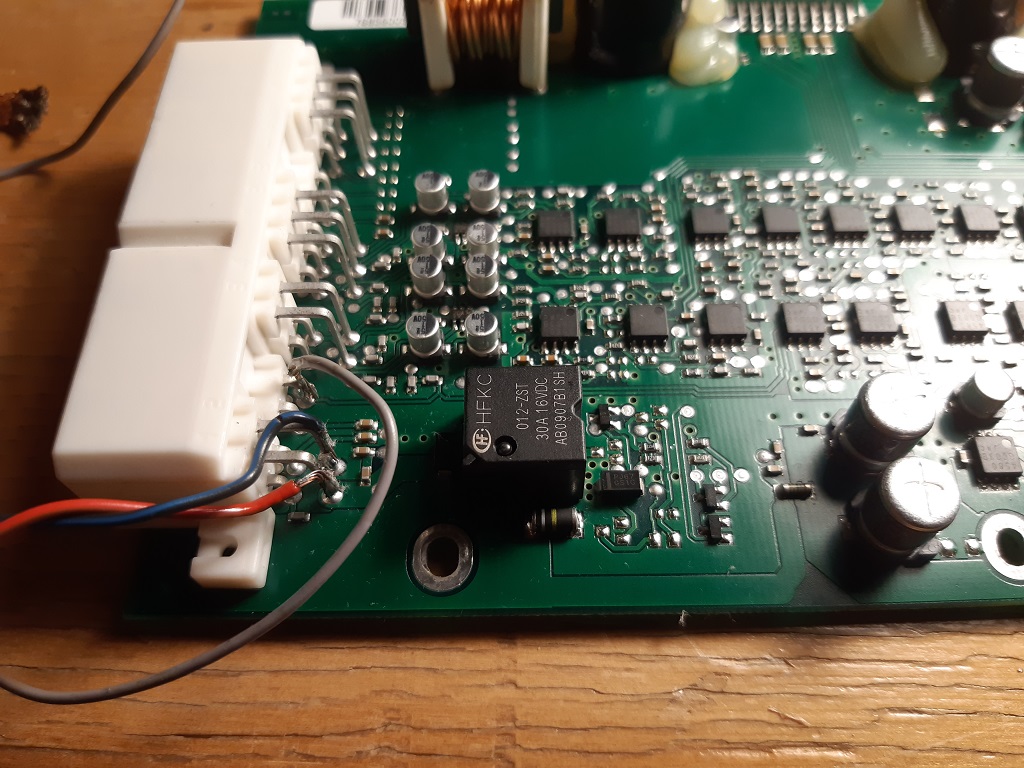

Finally the sound was back, and stayed back for the last two weeks. So the problem had to be within the amplifier. I took the thing apart and with the help of some spec-sheets was able to figure out the inner workings. Soldered some wire to to do a bench test and started poking around with a multi-meter and bingo, the amp was switching on (click from the relais) but no power was reaching any of the capacitors or components. After whacking the relais with the back of my screw driver power was back on. BINGO! A sticky relay turned out the be the problem in BOTH amplifiers. Just ordered 5 new relays on Amazon and will replace them as soon as they get in. I think this should solve the problem and I can enjoy some music in the Punto again. :D

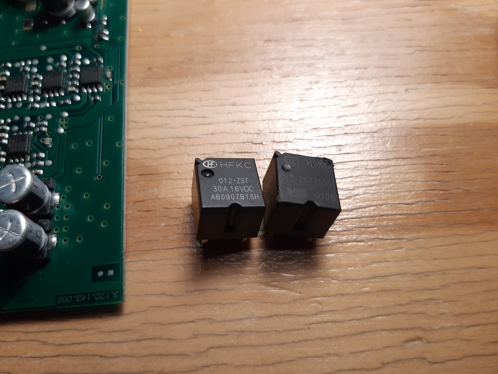

Out with the old, in with the new. Two Interscope amplifiers fixed for €5,- Bench-tested the amp and it works, this week back in the car.

Fixed both amps for €2,- Back in the car and working like a charm...

Ok an update from my side. After much trial-and-error I think I finally found the culprit. It started when the Punto sometimes would start up with only the subwoofer playing. No sound from the speakers. This gradually became worse up until the point that the speakers were not working at all.
I found a replacement Delphi HU. Had to clone the EEPROM for the car to accept it and the code to work, but to no avail. Next step was to replace the AMP and that seemed to solve the problem. At least for about a year. Then the problem came back and when switching back to the old amplifier, it did not seem to affect the chance of the amp not turning on.
