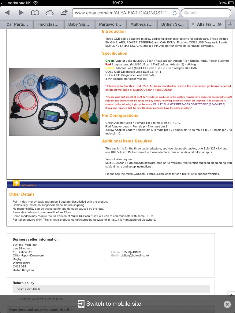

VAG KKL COM USB ODB2 DIAGNOSTIC CABLE 409.1 OBD2 II LEAD tool and fiat 3pin adaptor.
still unable to connect?

got a new cable, one for fiat with a switch in the unit for pin 7, pin 3, pins 1/9, and pins 12/13, with the adaptor cable, still not able to conect.
please help this is becoming a :bang:

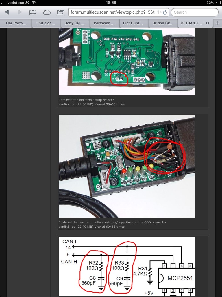

A lot of people are having problems with some chinese ELM interfaces that cannot connect to CAN network even if they support all ELM 1.3 commands properly. There was one user here who bought 5 of these cheap interfaces with no luck and finally bought an expensive one....
I also have one of these "faulty" units and decided to play with it and see what is wrong.
Well, it seems that the problem is electrical and is not very hard to fix.

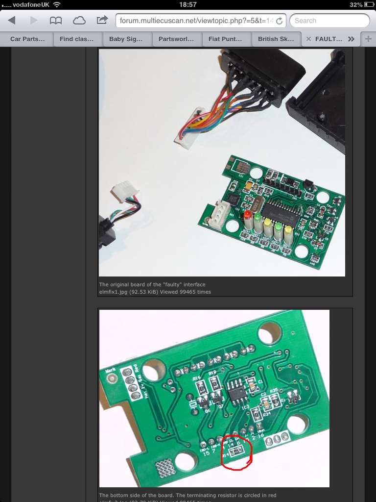

The problem is actually in the CAN termination method used in these interfaces - they use one 120 Ohm resistor connected between CAN-L and CAN-H.
According to the ELM327 datasheet the proper termination is to use 100 Ohm resistor on each of the 2 lines connected to ground through a 560 pF capacitor (see the picture below).
So i just got two 100 Ohm resistors and two capacitors of 560 pF and fixed my interface as shows below. And it WORKS flawlessly now.
The procedure is very simple:
1. Get two resistors of 100 Ohm and 2 capacitors of 560 pF. It should work without this. See the NOTE below.
2. Remove the single terminating 120 Ohm (or whatever) resistor from the interface
3. Solder the new termination circuit. I did it directly on the OBD connector as it was easier for me. I did it in a hurry just for the so don't blame for the soldering quality on the pictures. It should work without this. See the NOTE below.
4. Go to your car and enjoy....
NOTE: It is reported that most of the new interfaces now have this problem!
It was also reported by many users that the problem can be solved by simply removing the 120 Ohm termination resistor (which is connected between the two CAN lines, it is R14 on my photos but might be marked with different number on other interfaces) from the interface.

The original board of the "faulty" interface
The bottom side of the board. The terminating resistor is circled in red
Removed the old terminating resistor
Soldered the new terminating resistors/capacitors on the OBD connector
Proper termination as listed in ELM 327 datasheet

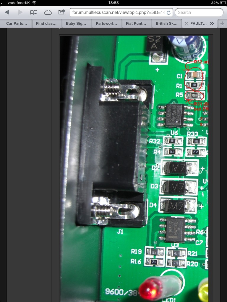

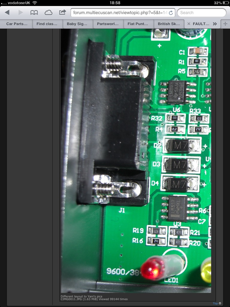

Can anyone help me out my elm327 dosent seem to be the same layout as in Yani's pics so I dont know where to put the resistors and capacitors.
Different layout to Yani's pics
steph48
Posts: 3
Joined: 04 Sep 2010, 16:16
Re: FAULTY ELM 327 INTERFACES DE-MYSTIFIED (READ HERE)
by steph48 » 19 Sep 2010, 17:51
> To JTD 171
Hi JTD 171,
I have the same circuit as you, and the same problem as described by yani (connect to engine is ok, and others ECU KO).
After a look at this one, I think that the case described by Yani is not applicable for this circuit.
So there is also a difference between this layout and elm327 spec.
I have updated your picture, so you can see the correspondance between your layout, the layout described by yani and the elm 327 spec.
First, resistors R32 and R33 are just equals to 100 ohms. I don't have capacimeter to test capacities. So I think the problem is not the same as the one described by Yani.
So we can see that R33 resistor value is 21 kohm on the layout. The ELM327 spec wants a 4,7kohm resistor.
I wil test with a 4,7kohm resistor for thr next two weeks.
Steph48
devc
Posts: 29
Joined: 13 Feb 2010, 21:34
Location: South Africa
by devc » 19 Sep 2010, 18:06
R1, R2, C1 & c2 are the components Yani is talking about. You interface is correct.

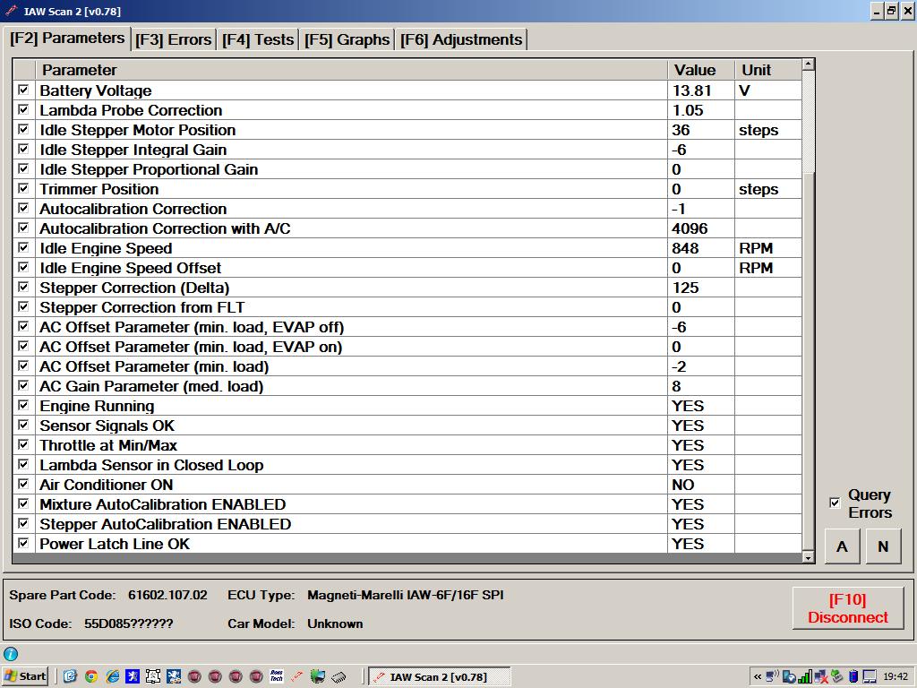

update:

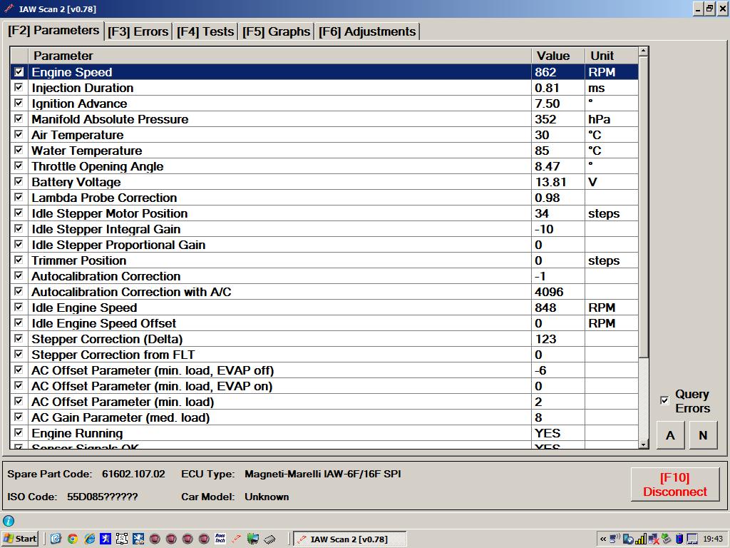

I have now used multiecuscan 1.4 and IAW ECU Scan 2, with my new Fiat cable with a switch in the unit for pin 7, pin 3, pins 1/9, and pins 12/13, with the 3pin adaptor cable, still not able to conect.
just managed to got another software package today, it does see the cable, put i'm unable to connect to car untill tonight, to check it works, will feedback later.
failing that, I will look at the post from Elxpunto90, and take my cable apart!
Rgds
Steve
sorted, used IAW ECU Scan 2, with my new Fiat cable with a switch in the unit for pin 7, pin 3, pins 1/9, and pins 12/13, with the 3pin adaptor cable, started engine and conected, the results!

Next question, where can I find the data to compare the results, please.
again thanking you in advance.
Rgds
Steve
