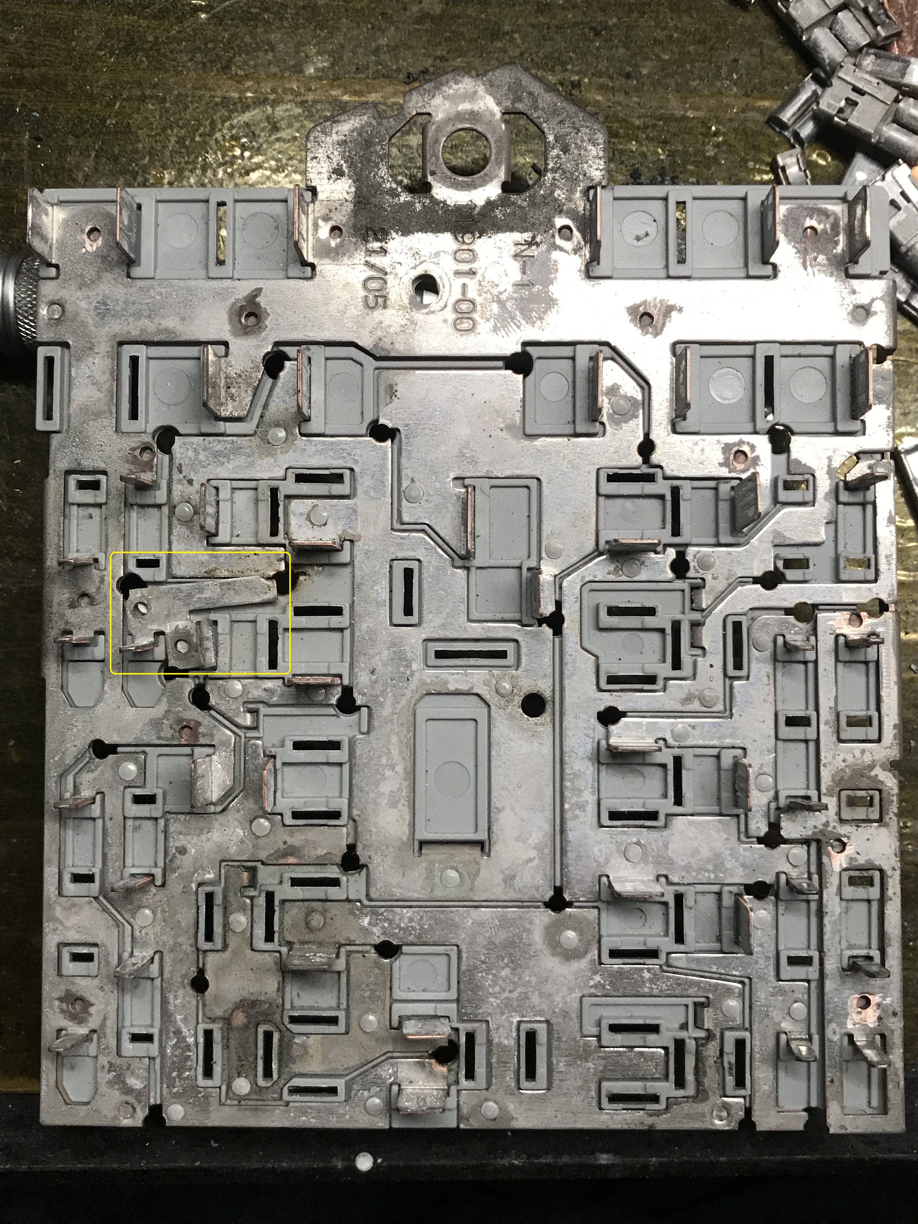

big brown connector under fuse box and the other one are very good, no water damage
i disassembled it completely and cleaned it with isopropyl alcohol.
ibb.co/nPdwG1k
ibb.co/ZSFK0JR
ibb.co/9qNMFBQ
ibb.co/B4Jj1H3
ibb.co/g6kpgMw
ibb.co/bXWdBpq
ABS control unit or it's electronics, or maybe both could be the problem?
A terminal in your last picture appears the have detached from the grey plastic, and is touching the terminal above it.
don't get me wrong, i made those pictures before cleaning and assembling the box; I did this to know how to assemble the parts without losing a lot of time. i would say the fuse box isn't a problem anymore.
as i said, maybe the problem is related to ECU, ABS control unit or another electrical circuit which has to be reprogrammed or replaced, but i'm not sure, it's just a guess....
