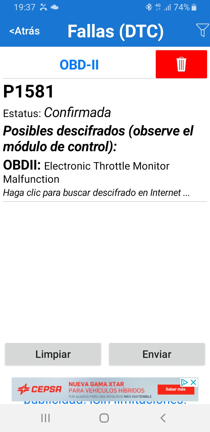

Thank you very much for helping. I get this on the diagnosis dongle ... will try to change the admision throttle valve

As Anthony stated a more sophisticated fault code reader will give two more digits and so more information.
Plus p1xxx codes mean different things for different vehicle manufactures
So you need to know what p1581 means for FIAT
