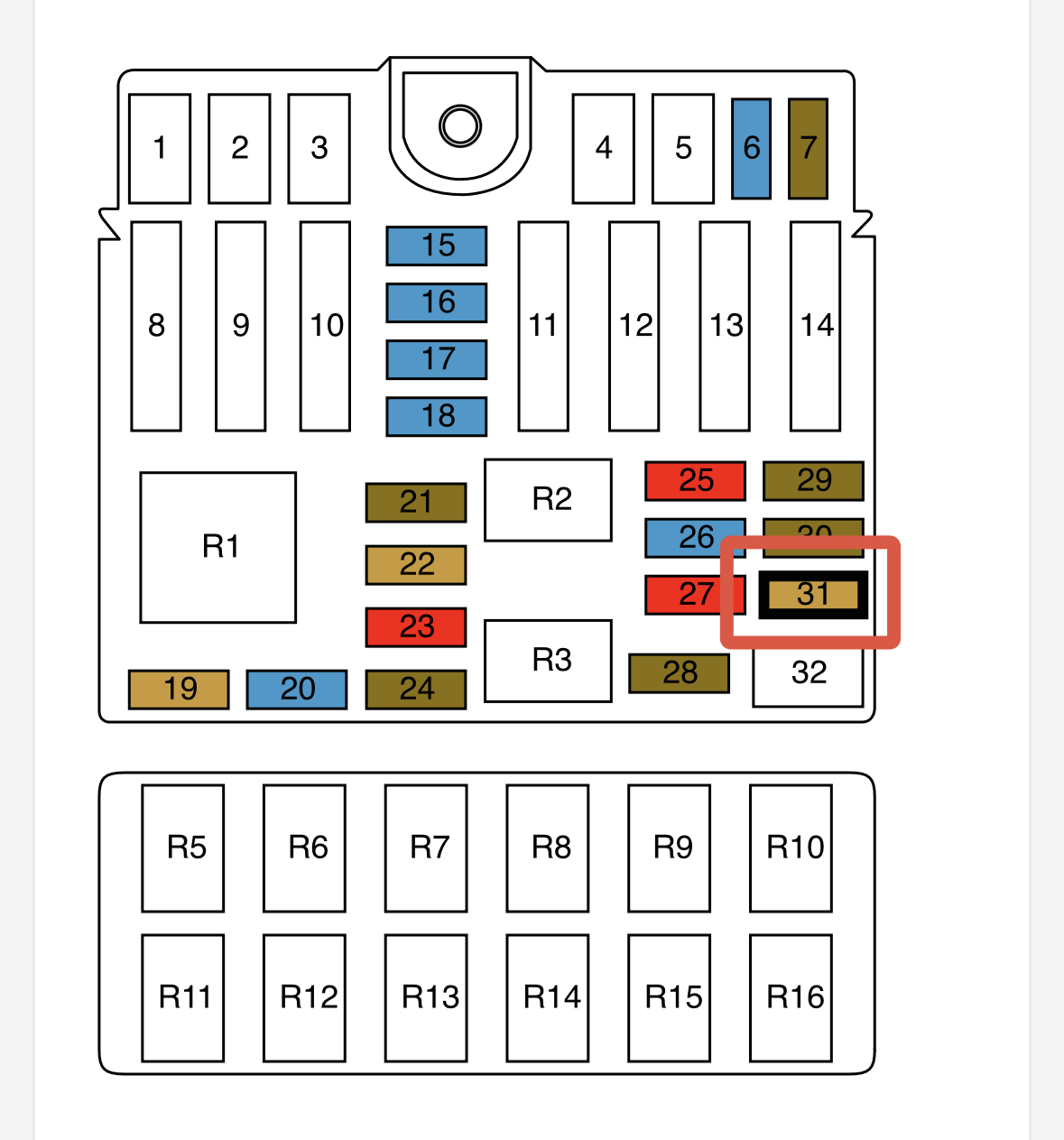

My reverse light recently stopped working but the bulb filament appears intact and I haven't had a chance to put a fluke across anything as yet, however, after some reading I have found that the reverse light may be on the same circuit as some ABS and stability control components, hence why this may be relevant to the code C1217.

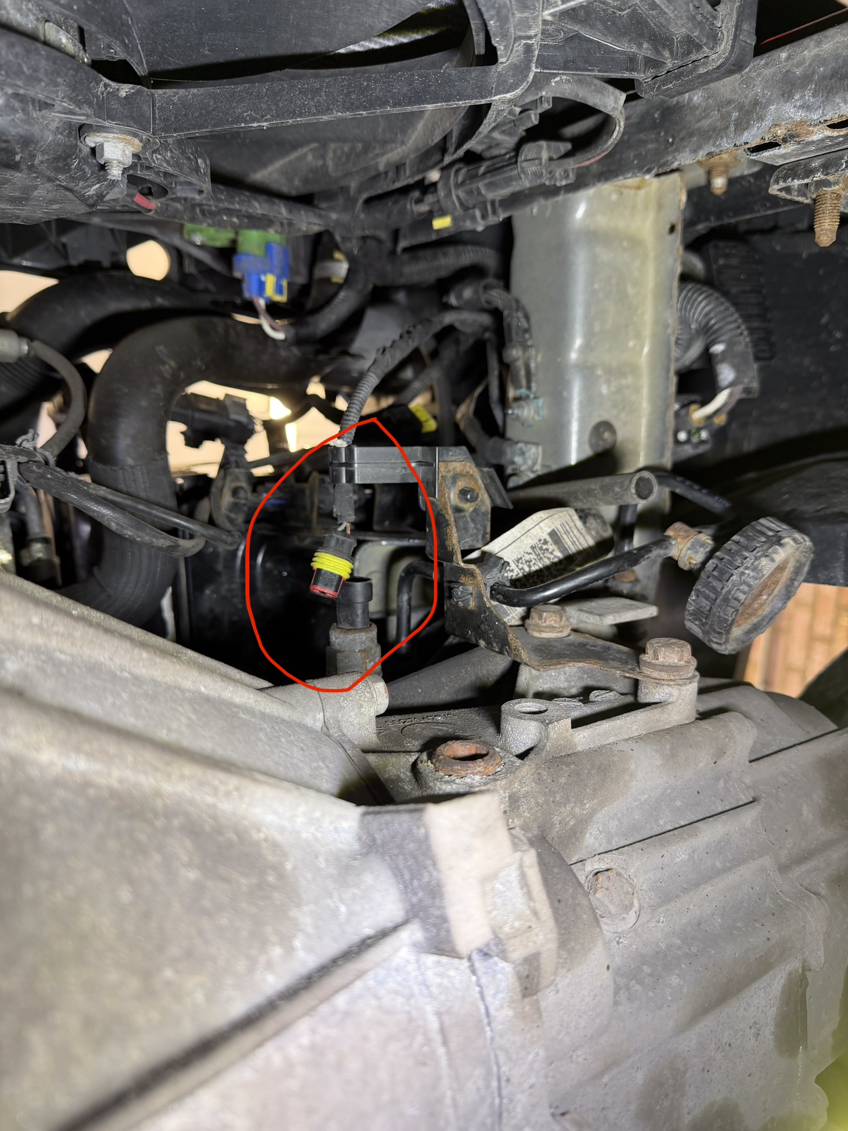

So with all that in mind, do you know whereabouts the reverse switch is located on the Panda Cross TA?
The car recently had the gearbox out and I am wondering if a wire has been pinched or possibly a reverse switch hasn't gotten a good connection somewhere during the re-assembly.
Not sure which model yours is but on mine (4x4 MJ) the reverse light switch is on the side of the gearbox nearest the front of the car
