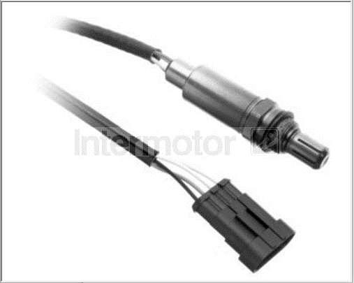

Thanks both for the reply.
I'll attach a pic of the sensor.
I don't know cable length though.
I gave them part number 46750243
Let me try another part number that I see one of you sent now.
So it shouldnt be a problem like performance wise in terms of AFR etc?

Judging by Pickwick's S4Parts links, the 1.4 sensor looks the same as the 1.6 post-cat one, but with a much shorter cable.. so it might physically fit at each end but is likely to be too short to connect both ends at the same time.
The 1.6 pre-cat one looks similar to the post-cat one but the connector is a different colour, which doesn't matter in itself .. but I guess it has a different pin layout or some other variation, so that it only fits in the correct place. I wouldn't hazard a guess what's different about it.. it may have a higher temperature capability or something, since it'll be closer to the motor.

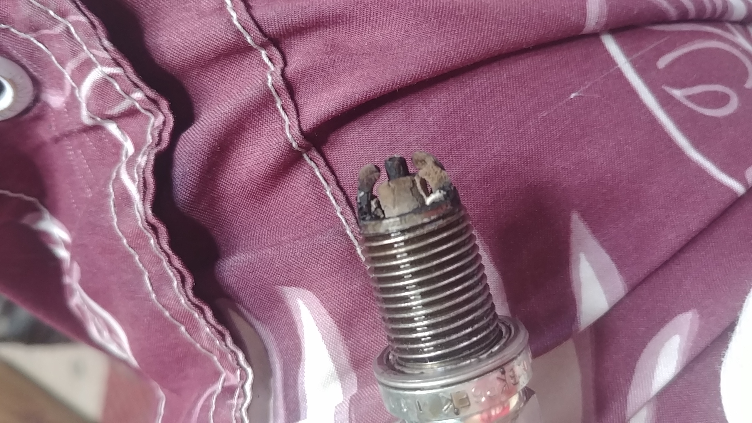

I bought 4 spark plugs with the sensor. I removed the plugs and this is what i got(check pic) replaced with new plugs.
Now she has no surge.very very slightly in 1st low revs but she's good. Much much better acceleration AND she doesn't reek that much of fuel when I floor her.

Here's the pic
Here's the pic
Please tell me that you threw that sparkplug away and didn't screw it back in.
Cause it looks like your car is burning more oil than petrol.
https://www.hemmings.com/stories/article/reading-spark-plugs-2
No I actually threw it in the washing machine just to get rid of that stuff. Ofcourse I threw it away.
Please tell me is that a sign of something or is it just old? Changed them last year.
Could it be from o2 sensor messing around with spark timing etc.

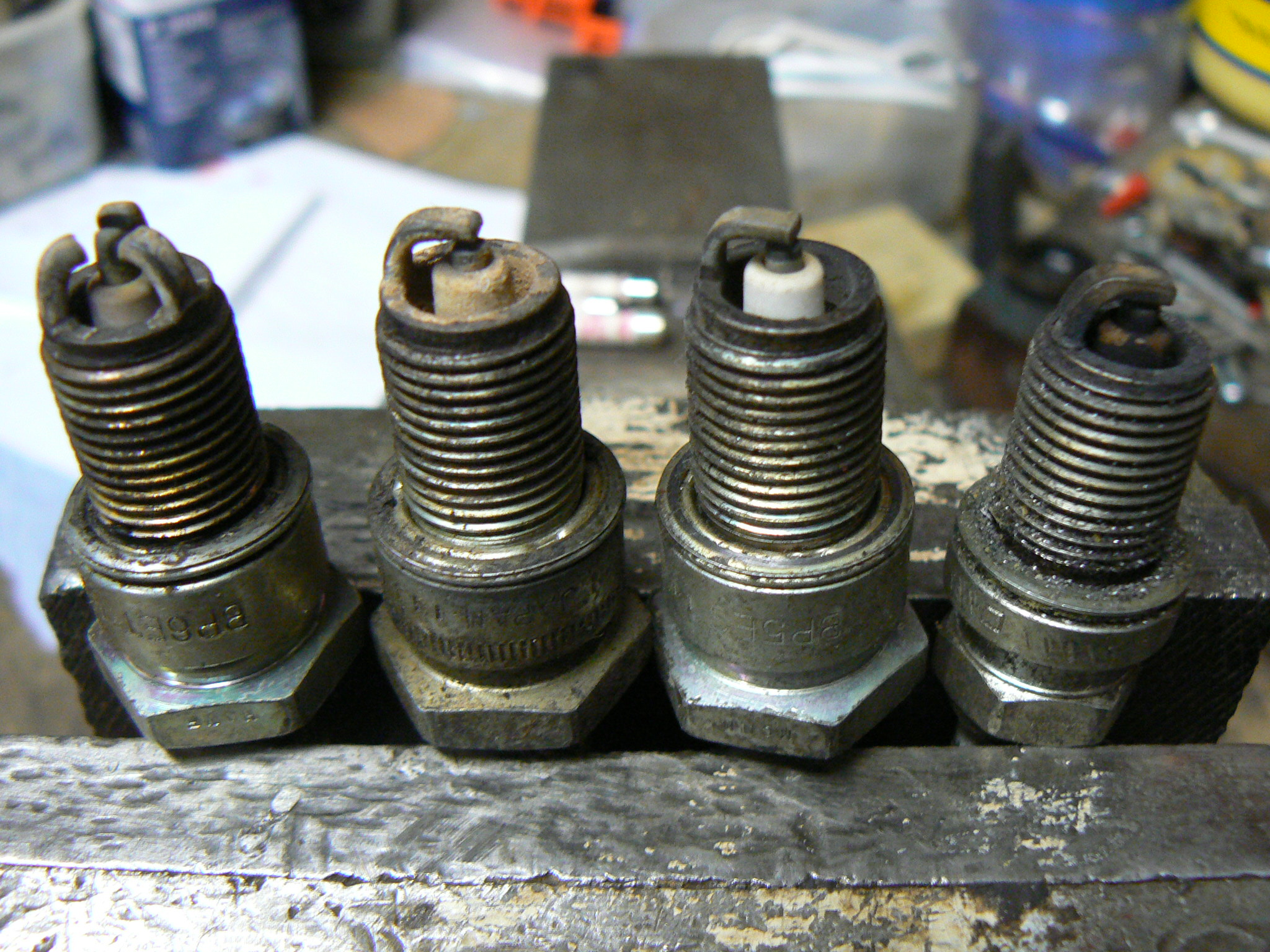

It's a pretty mucky plug isn't it. Here's a "pick 'n mix" from my "dead" plugs box:
I can't actually tell you from memory which of the 6 cars each individual plug came from but I can say that I change plugs every 2 years except for on the Astra which does a high mileage - sometimes 15,000 miles in a year so it gets plugs yearly. You can see how none of them has really excessive deposits built up and the colour, whilst not ideal on any of them, is not too bad except for the one on the right which came out of the Astra just before it's VVT pulleys were renewed. The car had failed it's MOT on emissions and you can see the plug is showing it's running rich. Even so there is no excessive deposit build up. I put new plugs and an air filter into it hoping that would be enough to get it through but the problem was that the valve timing was far enough out due to the worn VVT pulleys that she couldn't cope with the parameter variations on timing. Could be yours is burning a bit of oil as suggested which is causing that deposit build up?
If you are going to use plug colour as a diagnostic aid then you must check them after the engine has been out for a good run with the engine fully up to temperature and not after it's been "fiddling about" in traffic. Ideally a run down a bit of dual carriageway at constant speed for a few miles, then pull them and see what you've got. Not really practical though is it? Consequently I don't tend to let plug colours worry me too much - although I wouldn't want to see one much cleaner and whiter than the one third in from the left - but crusty carbon build up and/or melting of the electrodes would have me worrying.
