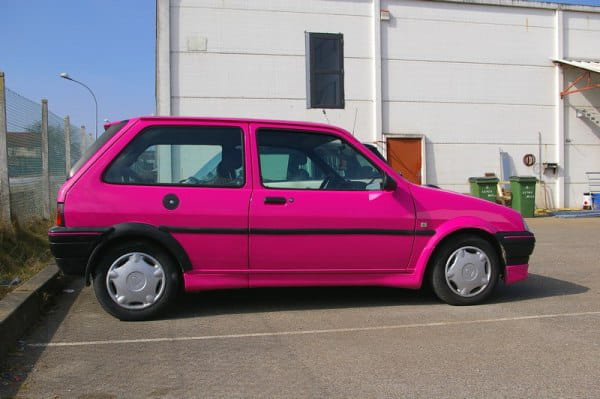

Hi Philippe,
is that a Citroen AX..??
:ROFLMAO:
it is a rover 100 (metro XP for you I think)

Sorry I cannot help with the pulley, but your Rover 100 looks a little low at the front. Needs the suspension pumping up. Low suspension can wear tyres and suspension bushes very quickly as well as cause handling issues.
Measure from centre of hub to underside of wheelarch. Front 327mm, Rear 321mm. This is at a nominal 17degrees. See the attached to adjust for temperature. (Notes from a 1989 Rover Metro training course. Now I know why I keep all this stuff.) I believe the measurements were still the same for the later 100.

thank you for your clarification for the rover, but the suspensions were adjusted after the photo was taken in 2011
