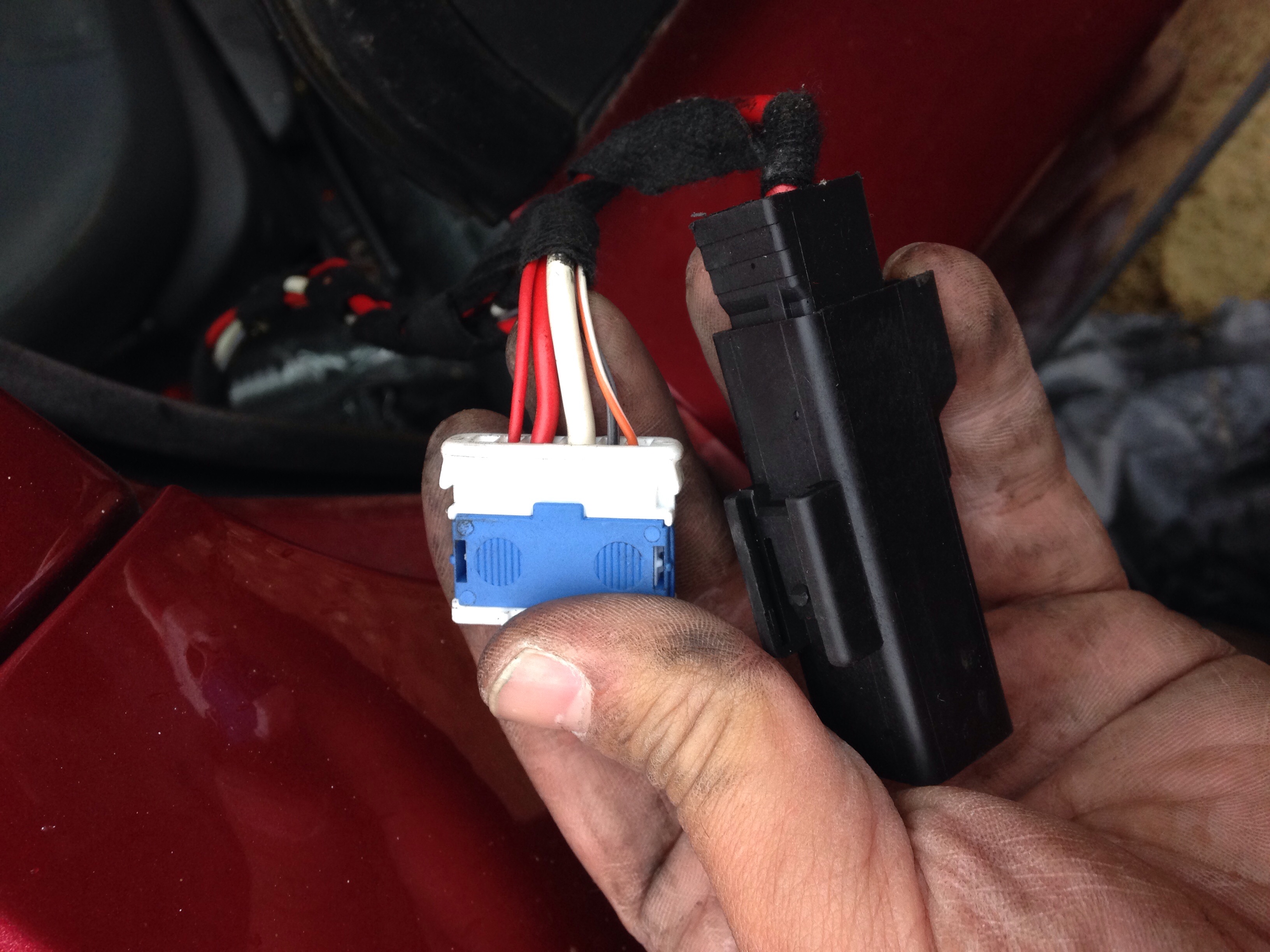

Update: found the presure sensor plug! Done but the donor car has a orange and white wire in the matrix conection main and the running one missing? What can it be?

3. can i swap the European dashboard wire loom with the UK one
Dashboard wiring looms are likely to be different for left and right hand drive cars.
The only orange/white wire I can see in the climate control wiring diagrams is for the Air Quality Sensor (exhaust gas sensor).
Ok, so not mandatory one! Am I right?
The compressor is all ready plugged in! Has all the plugs connected! Do i have to replace the engine ecu? With the uk one?
