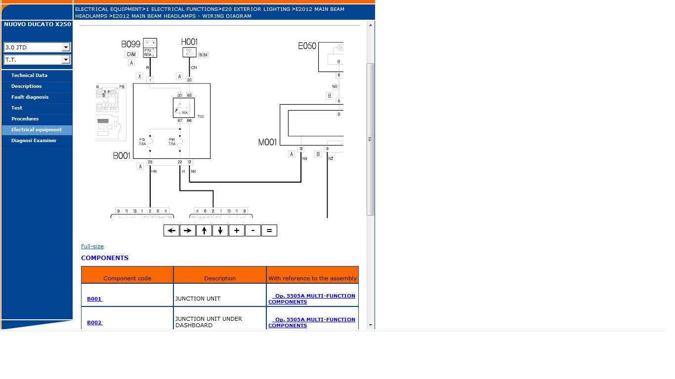

The functions you describe are carried out by the body control module. I have not got the circuit to hand but there will be a single relay that feeds both lights via separate fuses. The relay is operated by an output of the body control module.
hi thanks for reply any idea which relay and its position? and how to diagnose lack of signal from module? thanks again
I have attached the schematic for main beam. The relay is T02 in the cab fuse box. Pin 85 of the relay is the coil which gets ignition fed supply, the negative switching signal comes from the body computer on relay pin 86. The lamp supply is from the battery via a mega fuse on the battery + terminal to relay pin 30. When the relay is operated the supply is fed to each lamp via its own fuse from relay pin 87

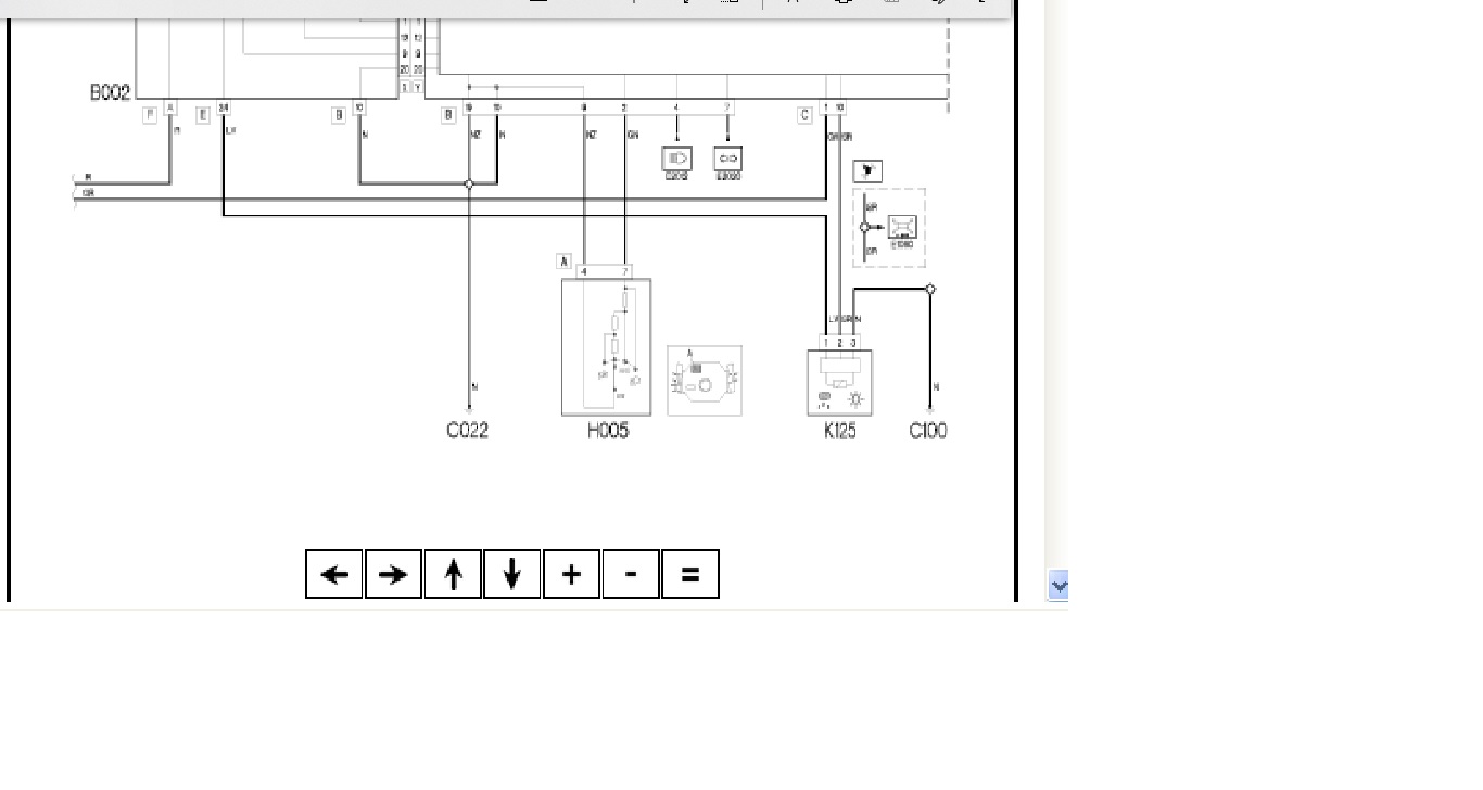

I have attached the schematic showing the switch to body computer set up. [H005 in the drawing]. It is a single pair of wires with different resistor combinations for each switch position. When the lights are first switched on the default to dipped beams and it need the main beam to be operated to select them. As dipped beam is working and you have changed the stalk I suspect the fault is further on.
The Body Control Module outputs a negative when main beam is selected on the wire which goes to relay T02 contact 86.

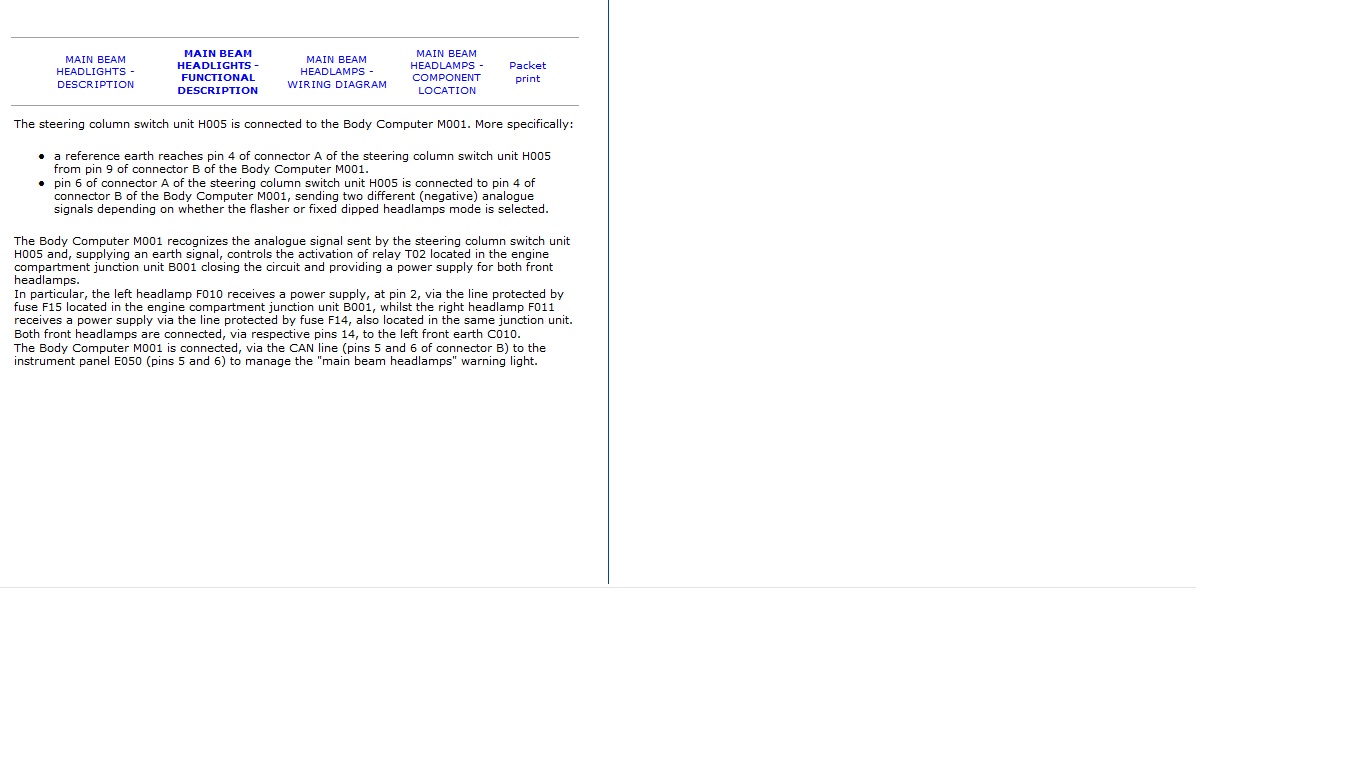

Looking at the drawing of the stalk [H005] and the connection to it from the BCM it would appear that when main beam is selected that the two wires are shorted together. It would be relatively easy to disconnect the stalk and check the resistances when a) sidelights b) dipped and c) main beam are selected.
It appears from the link below that the headlamps are pin 4 negative and pin 6 switched negative on the stalk.
[sorry for any confusion but my cd will not show drawings anymore since I uprated to windows 10 - such is life]
