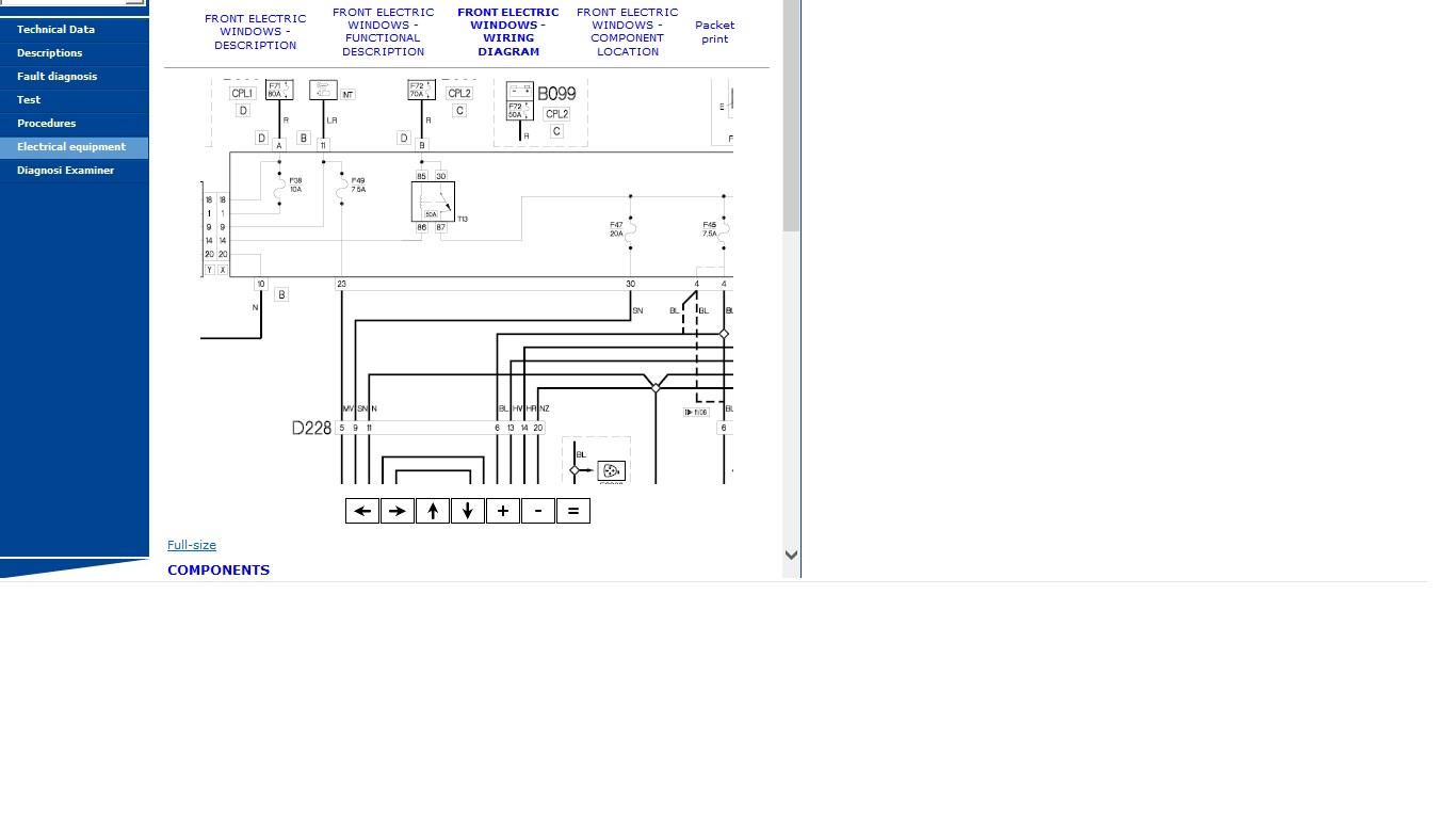

What year? On a euro 4 X250 the window motors are fed via Relay T13 in the dash fusebox

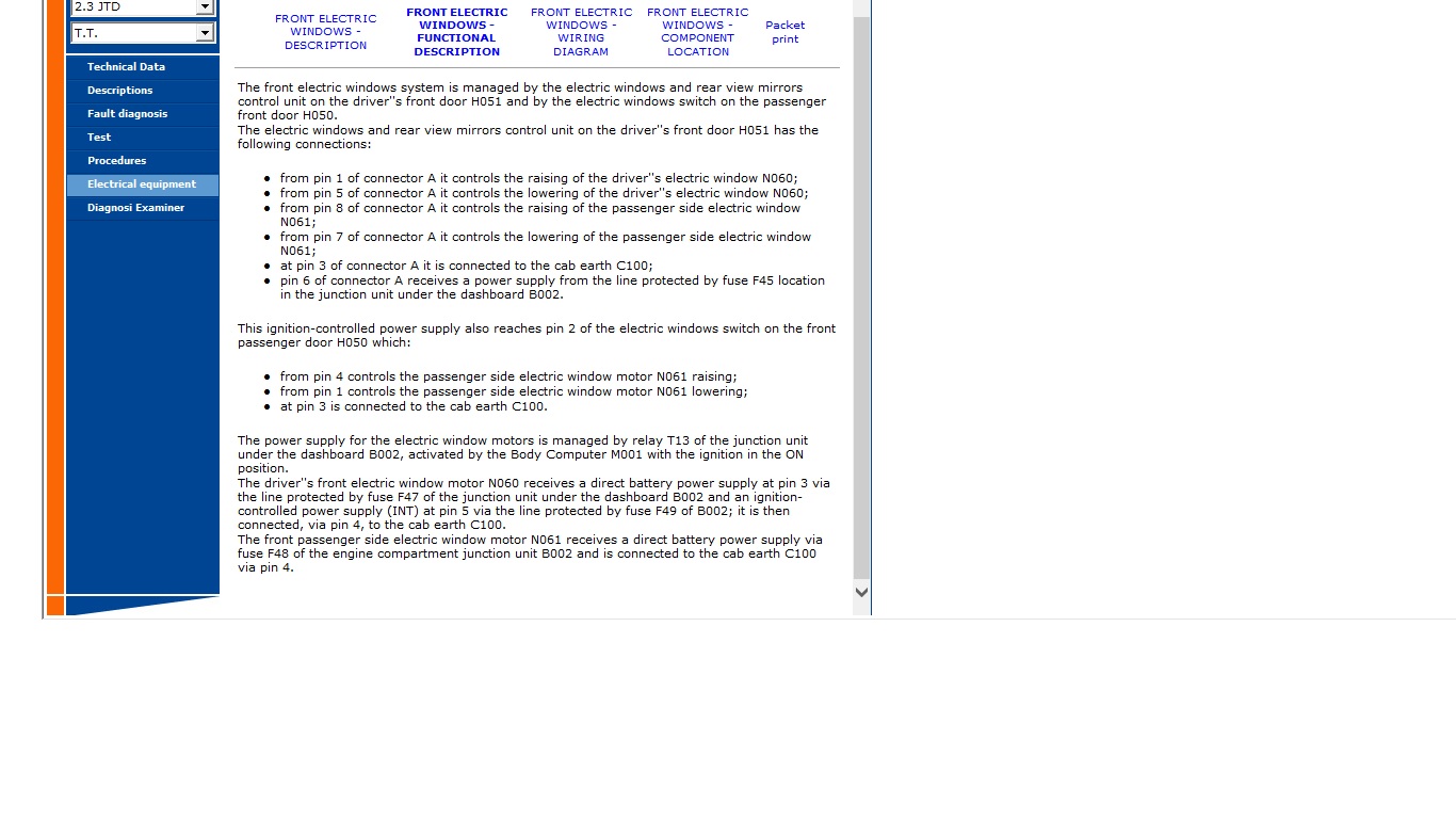

Relay T13 gets a direct feed from a maxi fuse on the battery. The relay is switched by the body computer when the ignition is on. When operated the relay feed the voltage to the two fuses and then to the motors

I think F72 is a maxi fuse on the fuse board attached to the battery positive terminal.
The drawing shows a direct connection from F72 [page 1 of the pdf attached, on the battery fuse module B099] to relay T13 [page 2 of the pdf attached on cab fusebox module B002].
Note that the page 2 drawing of fusebox B002 shows that F72/T13 provide power for other systems besides just the windows, is everything else in the cab working?
