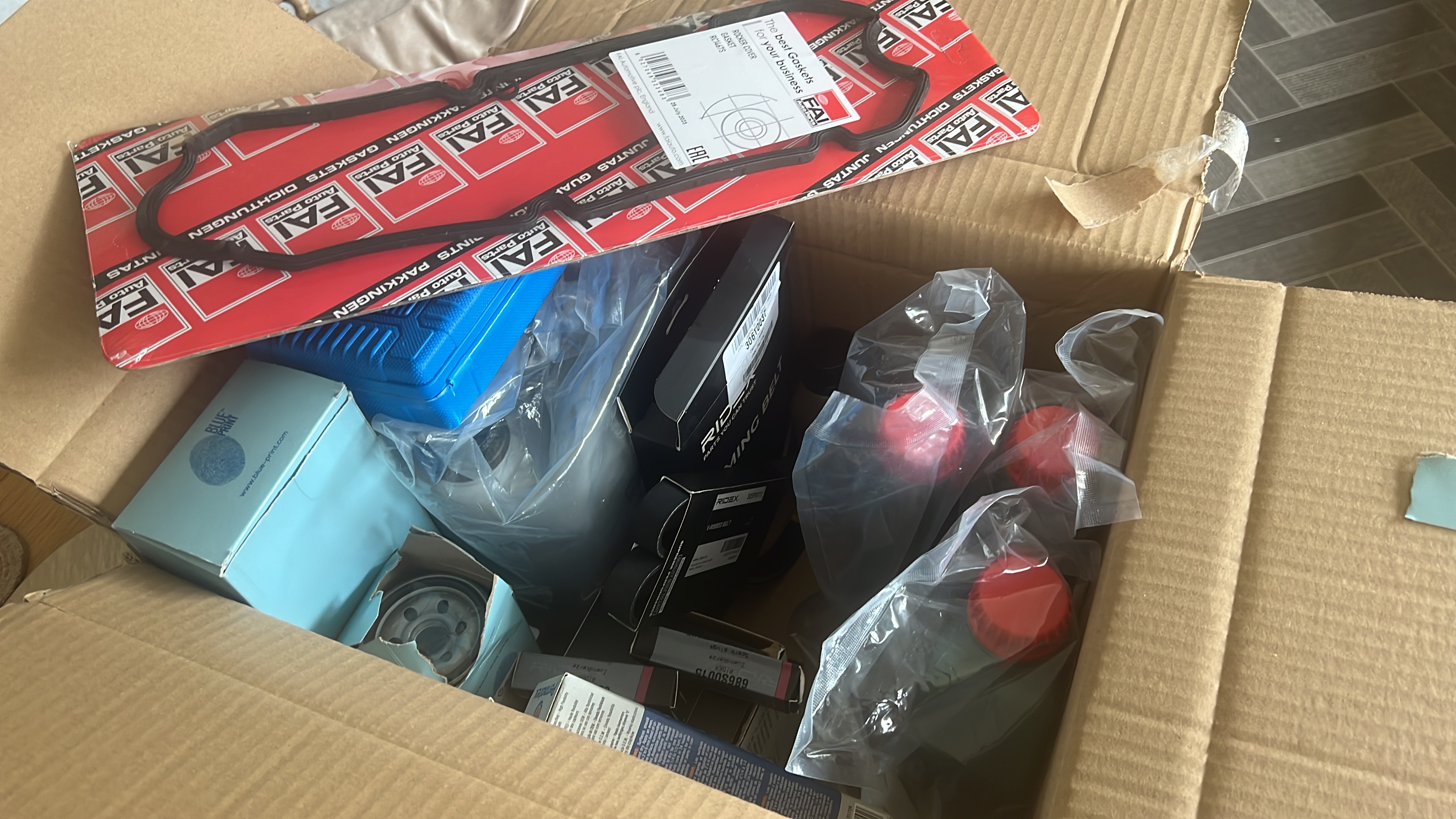

The locking kit came a couple of days ago. I think when we’re done with this, I’ll donate it to someone on the forum here who wants to attempt the job since it’ll be another 7 years before it’ll be needed again and we’ve accumulated quite a lot of specific eBay car kits (be it brake piston pushers or pumps for brake fluid or coolant or gearbox oil etc!).
Got an email this morning from Evri to say they have the AUTODOC parcel. It’s gonna be a big one.. Is there anything more exciting than receiving car parts in the post?
Silicone sealer for the rocker cover and any other parts that need sealed - is that right?
