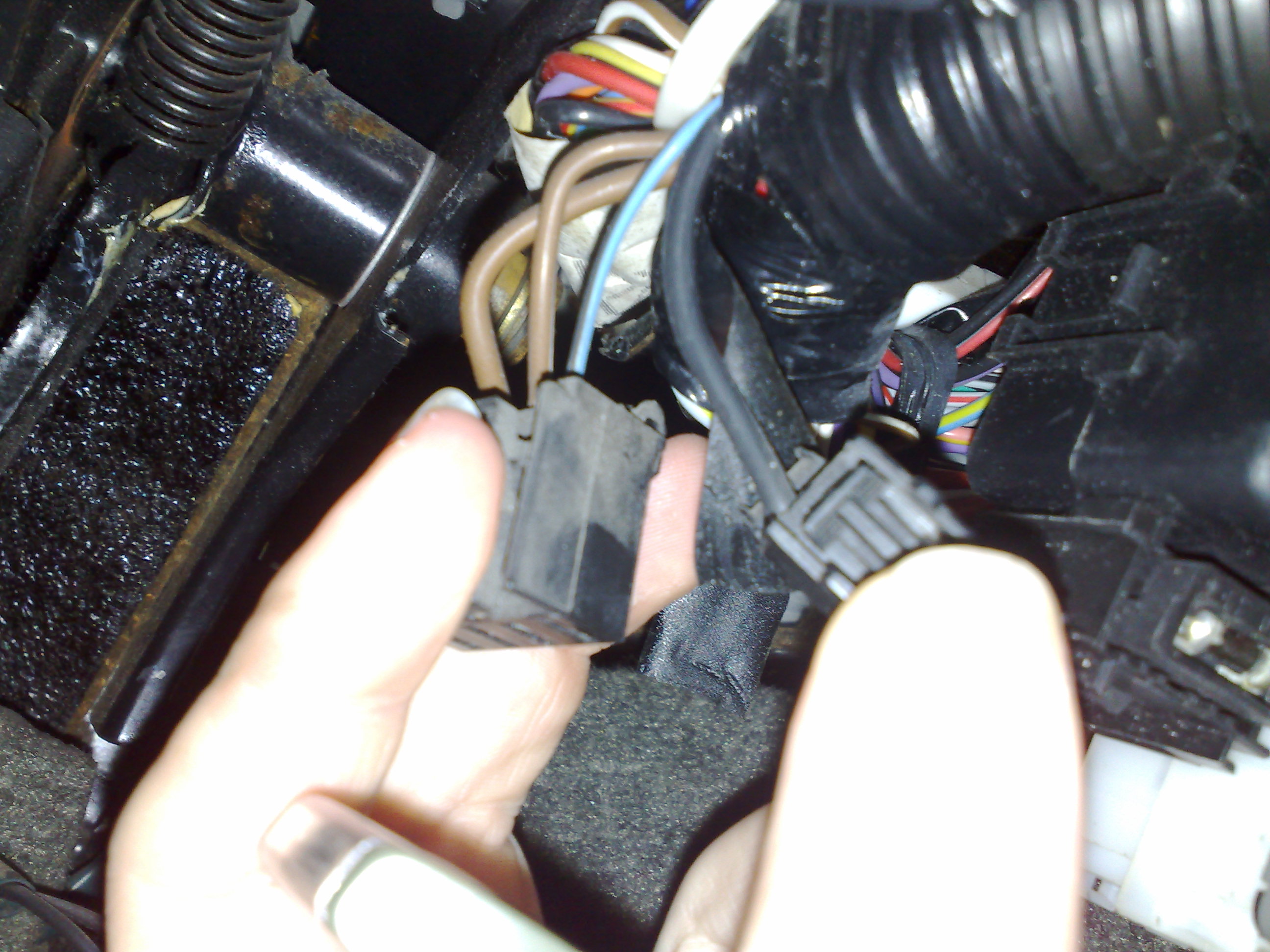

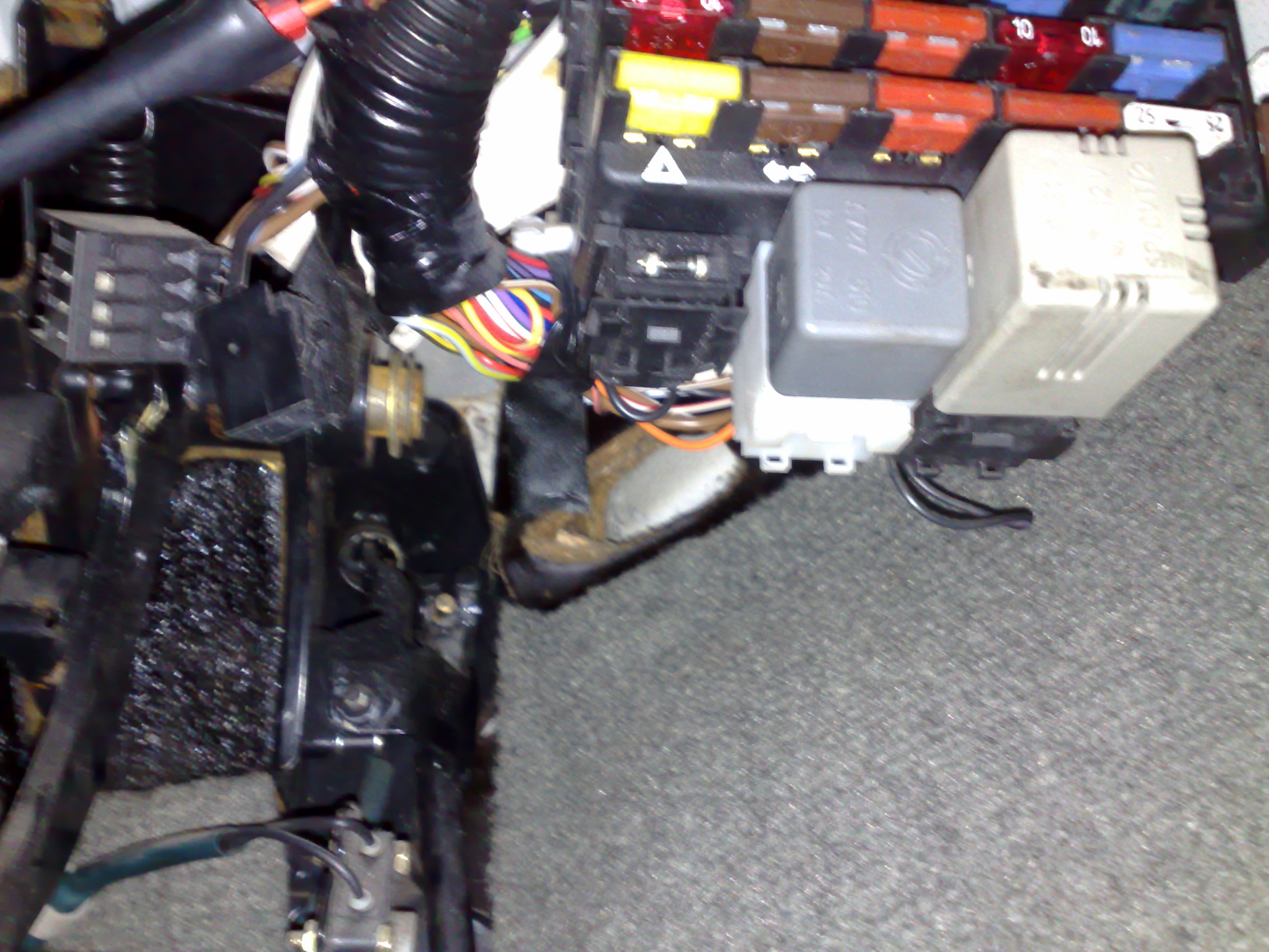

1,there is a connector by the accelerator not connected to anything is that normal?
not the accelerator one, I can send/post pictures if anyone is interested.

1) No that dosen't sound normal. Could you post a pic if possible to help. There should be two Micro switches and connectors on the accelerator, and one on the brake (for the brake lights).

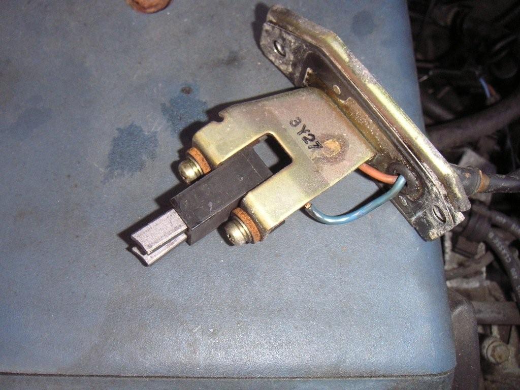

I have checked the obvious things from the threads such as the two micro switches on the accelerator, fuses etc. Have removed starter motor and looked at brushes which are fine.

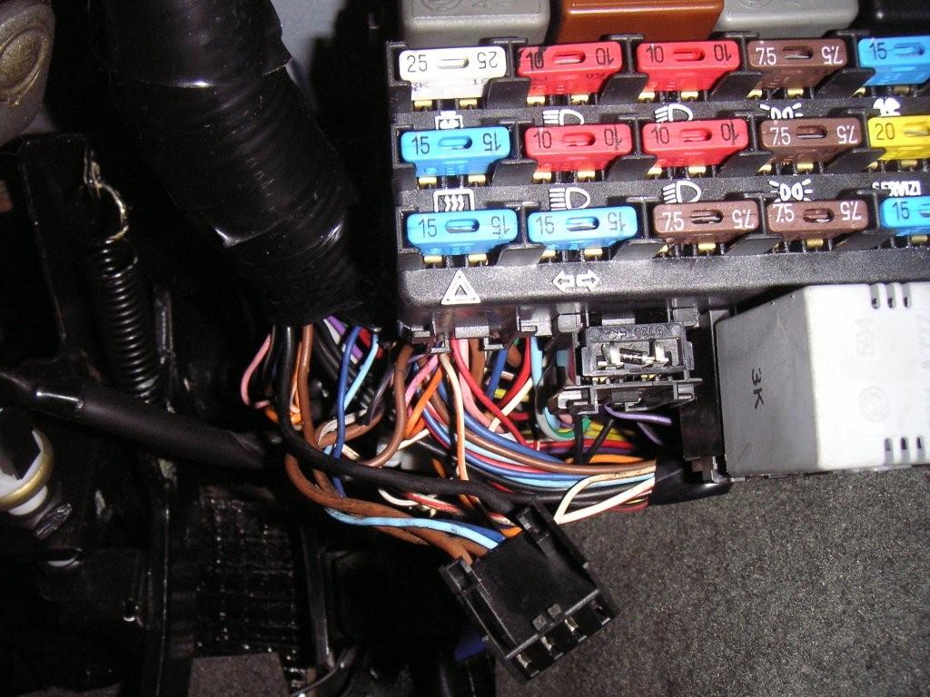

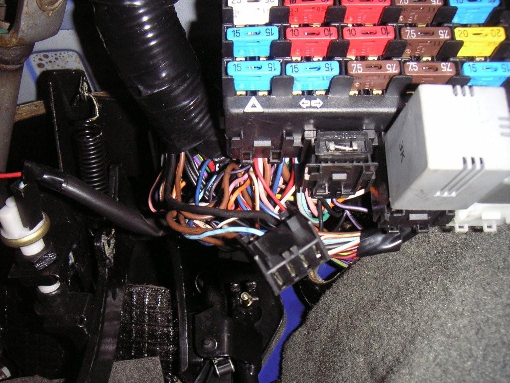

I will try and put up a picture of the connector, it sits to the right of the fuse box under the dash, looks like it might even connect to it! just have no idea what it is!

Can anyone explain why there are two wires to brushes? and should they both energise with 12Volts?

That connector by the fuse box iirc is normal (from what I've seen in our two Selectas) but will check.

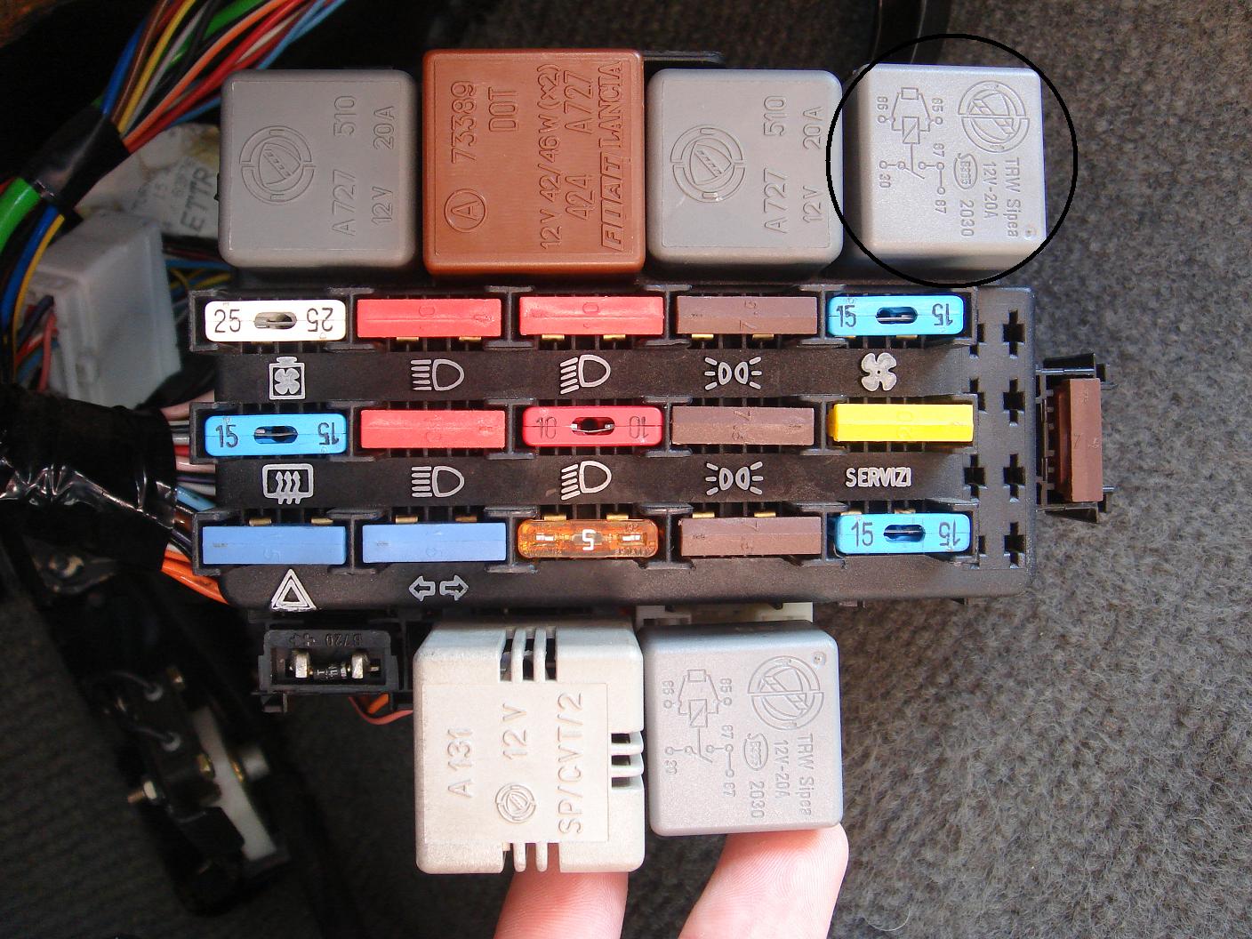

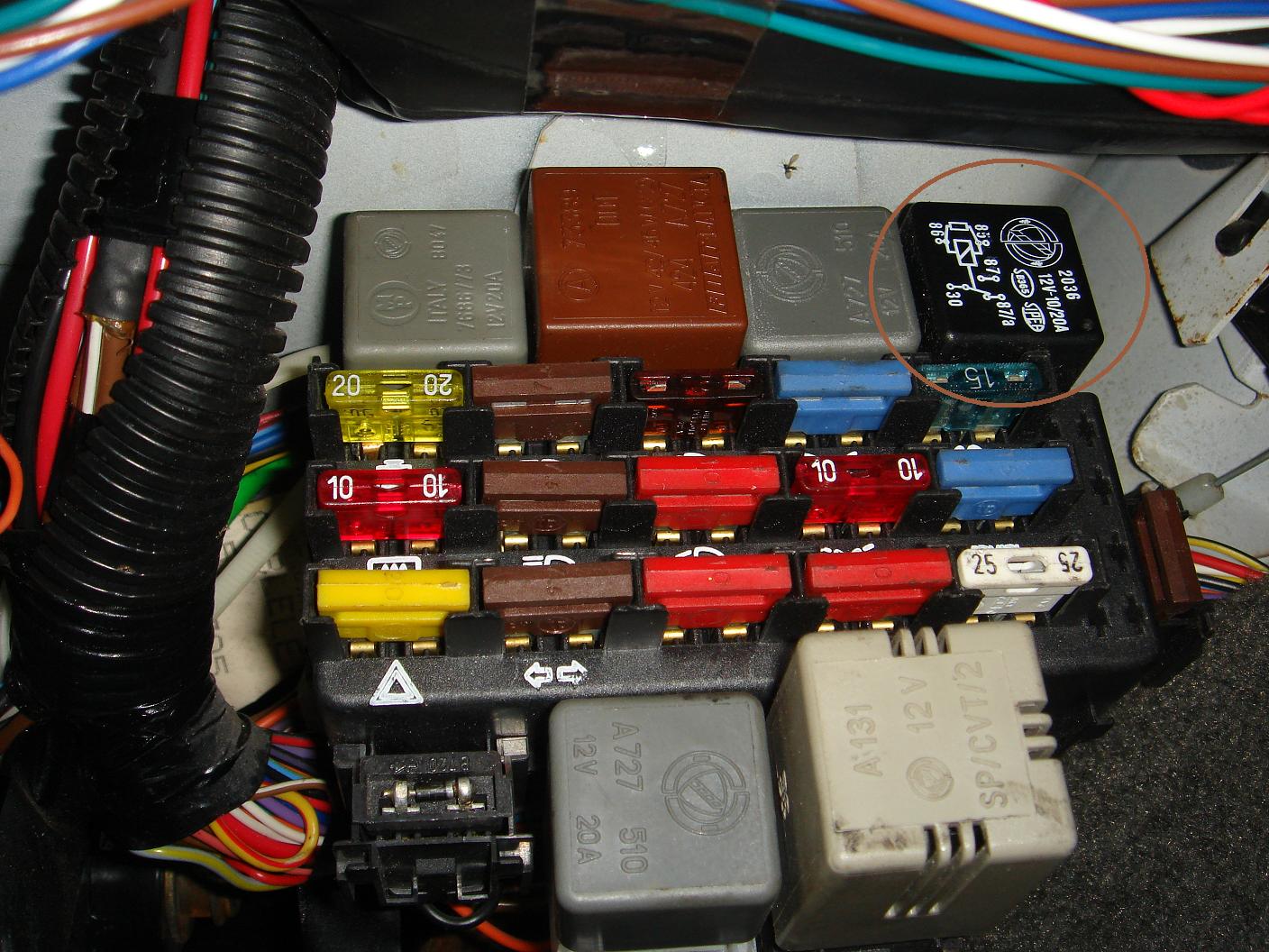

Right. I've checked Dad's Selecta and can't find that connector, neither can I see it in a pic of the fuseboard in my Selecta;
attachment.php
Dad's Selecta's Fuse board
attachment.php
My Selecta's Fuseboard.
EDIT; Just been out to my Selecta, and found it. It's slightly different though. How many wires go into yours? 3 or 4? and is it on it's own.
I've found the following;
I seem to have 2. One like yours, with 3 wires going into it, and another with 1.
The only thing that sprung to mind at first was if the microswitches were suppost to be connected here? But I checked my spare pedal box and each switch has a different connector.
I'm not sure if its possibly something linked to Gearbox ECU diagnostics (Not Engine ECU), but again, thought I'd seen a seperate plug for this beneath the center console.

I think the first step is to check you have 12V across the brushes when you try and drive . you can connect volt meter between the two wires that go to brush block , either on brushes if still removed, or more easily at the connector in the wiringloom if brushes fitted
If no voltage shown when you try and pull away then either bad connection at a microswitch , duff microswitch or worse case ECU kaput.
If 12V shown then your Clutch is most likely at fault .
The Haynes manual has quite a good section on Selecta and particularly how to check the clutch .
Refit the brushes , if not already done , disconnect their wires at connector going to loom , then check resistance across brushes [ should be 2 to 4 ohms at room temp

Thanks for all your help and comments Looks like mystery plug is diagnostic connector and therefore red herring.
