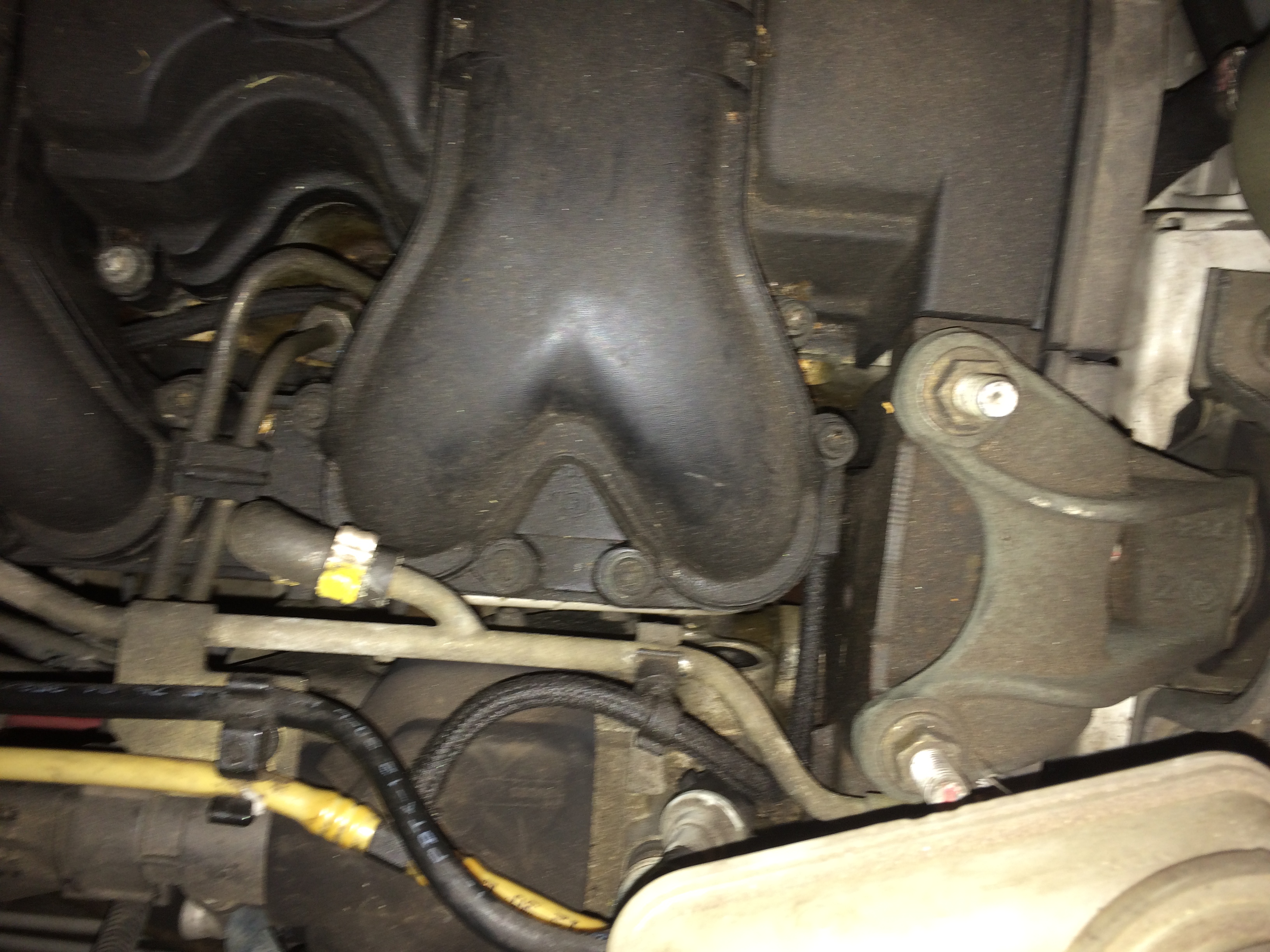

Hi Guys,
I have same sort of issue. Perfectly smooth 2002 1.9d just cuts out taking pas with it, then won't restart for 5 minutes, then cuts out again after a couple of minutes.
I've tried the solenoid tap as suggested here but no difference made.
I have changed fuel filter but still got the issue so I assume I'm getting air in the system as Paradox has suggested. My issue is that I am not sure which pipes I need to change out.
I have noticed that there is a t-piece in one pipe running between the filter and the Lucas pump. The piece coming from the T goes down to the first injector, and is wet with diesel. Also, the pipe then leading from that injector to the next injector is also wet with diesel. Could air be getting in from these points? And if so is it an easy fix swapping them out?
I have attached a pic as I don't really understand which parts people are referring to on previous threads.
Any help massively appreciated

For those without the vehicle in front of us..
Could you please add a pic and a brief description to help anybody reading this in months to come
Thanks
@steve edwards :)
